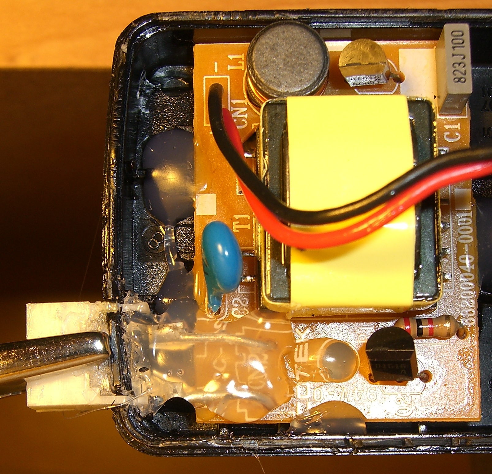

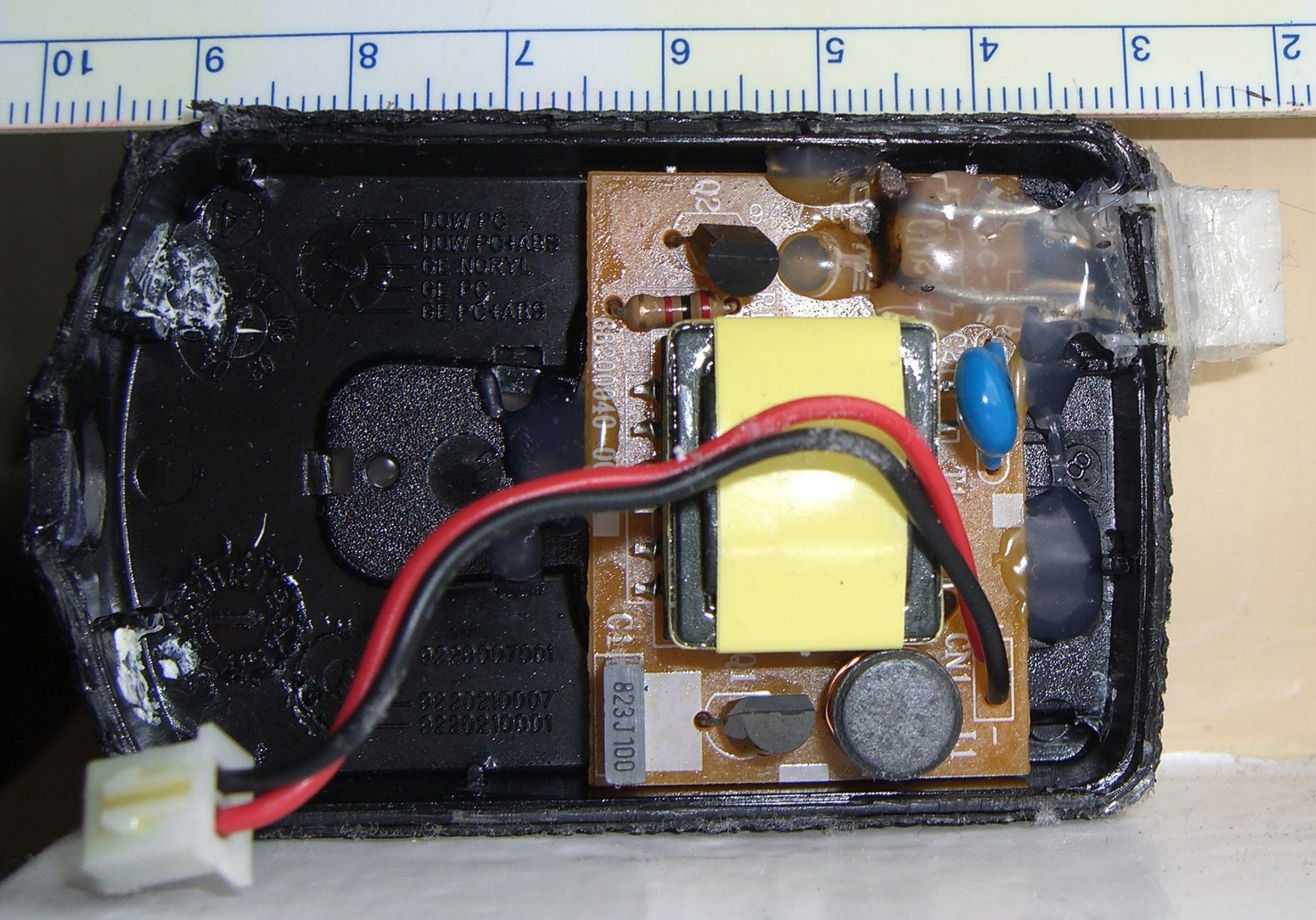

                                Hi folks. Let me show you what NOT to do with high-voltage circuits. (see attached snapshots).
                                The white connector that you see attached to the outside of the black box goes to the CCFL (don't know exact voltage). It used to be soldered to the inverter board. I moved it to the outside of the box, and connected it to the board using some thick leads I chopped off some components. Then I surrounded the leads with hot glue.
                                In the 'after' pic you can see a black trail where electricity has arced through the hot glue. A separation of approximately 5mm. Evidently, hot glue is not a good insulator, and possibly, even worse than air. I'm pretty sure there is an air gap of roughly the same separation between the traces on the back of the board.
                                What do you guys think? Remove the glue and use as-is? Use something else as an insulator? Is the inverter fried and unusable now?

                                  Maybe bathtub silicone would make a good insulator?

                                    They make RTV162 and other specialty silicone potting materials specifically to be nonconducting. I'd recommend you look into one of those.

                                      Scrape the carbonised PCB off and don't use hot glue there.

                                        The hot glue had some additives or other impurities (dirt, moisture, etc.) in it that lowered its dielectric strength. In their pure form, almost all the plastics have greater dielectric strength than air at normal atmospheric pressure.
