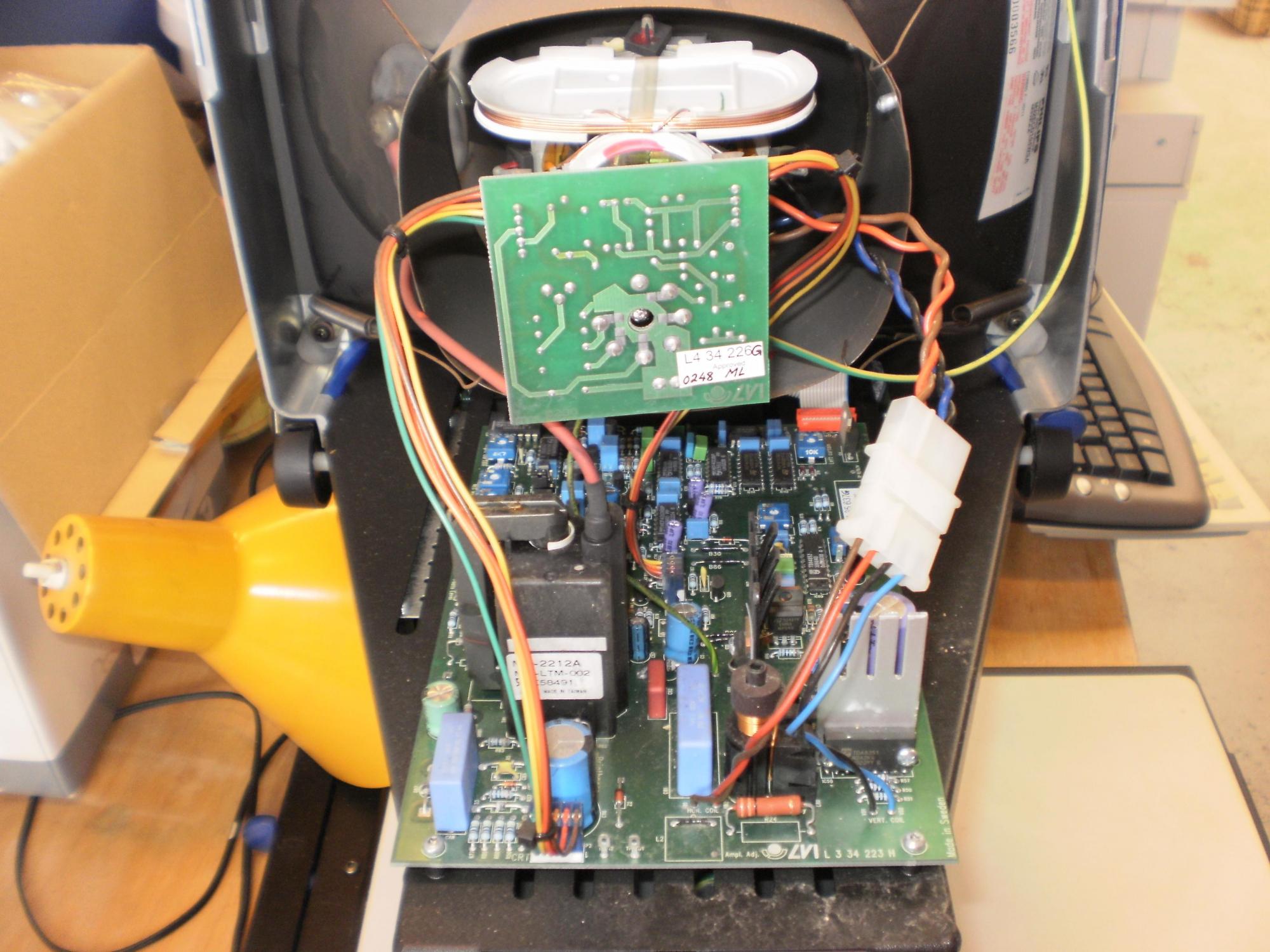

    Hi
    I have here a Magnilink penguin
    http://www.professional-vision-servi...oduct-mlp.html
    it's black and white, and I was wondering is there any chance to make it color
    by switching it's Tube?
    It's alittle beaten up, but works fine and offers a nice help with electronic repairing, but I would love to make it to show color, as it's easyer to work with.
    The source of items to change it, is almost endless, I have heaps of electronics components lying around and brought to me everyday, so it should not cost much
    And the other thing I would like to do, well it's just for funn, I love looking at stuff magnified, so I was wondering if I could some how increase it's magnification?

    A color TV needs quite a few extras compared to a B/W to show color. Apart from the tube it needs a new synchro IC (also known as "jungle"), a new flyback, a new processor... basically a whole new board.
    You could on the other hand try to hack into the optics and display the magnified image on a color monitor, because the magnifier has some sort of CCD sensor which enables it to be viewed on that little b/w tube. Easiest solution would simply be a digital camera mounted in the right place. And you could simply use the LCD of the camera for viewing, or use a camera with video out and display it on a bigger monitor and do away with the tube entirely.

      Yes, a digital camera and an LCD would be the "modern" solution.
        hmm ok, I thought I could just switch the magnilink "TV" out and get it replaced with a color TV instead, with all the circuit board and stuff, but hey what do I know, hence I came here for help and suggestions :P
        well I might have a computer LCD lying around that I could use.
        I haven't checked it out on the inside yet, but I thought it had a "plug" from the "camera/view-port" to the B/W TV,
        like a camcorder connected to a TV,
        that way I would only need to change the TV and keep using the current "camera"
        I'm sorry if my post sounds nonsense or full of yiberish, but this vocabulary is new to me and wasn't tought in school
        so i'll try my best to make it sound right

            A color tube runs on higher anode voltage.
            @ playman: If you have a color set that fits you could give it a shot, however, to be competitive in price, the CCD sensor itself might be b/w too and you'll find out you worked for nothing. The best idea is still patching a digital camera to the lens assembly.

                But that would have to be a expensive camera, to get a decent picture quality right?
                I mean I just can't plug in a USB camera and expect the same resolution.
                  Well, a webcam won't exactly be optimal, but any cheapo digital camera should do.

                    hmm alright, I might have one of those lying round somewhere, doubt it though that it's better then 5mbp camera, i'll take a better look at that when I come back home from vacation.

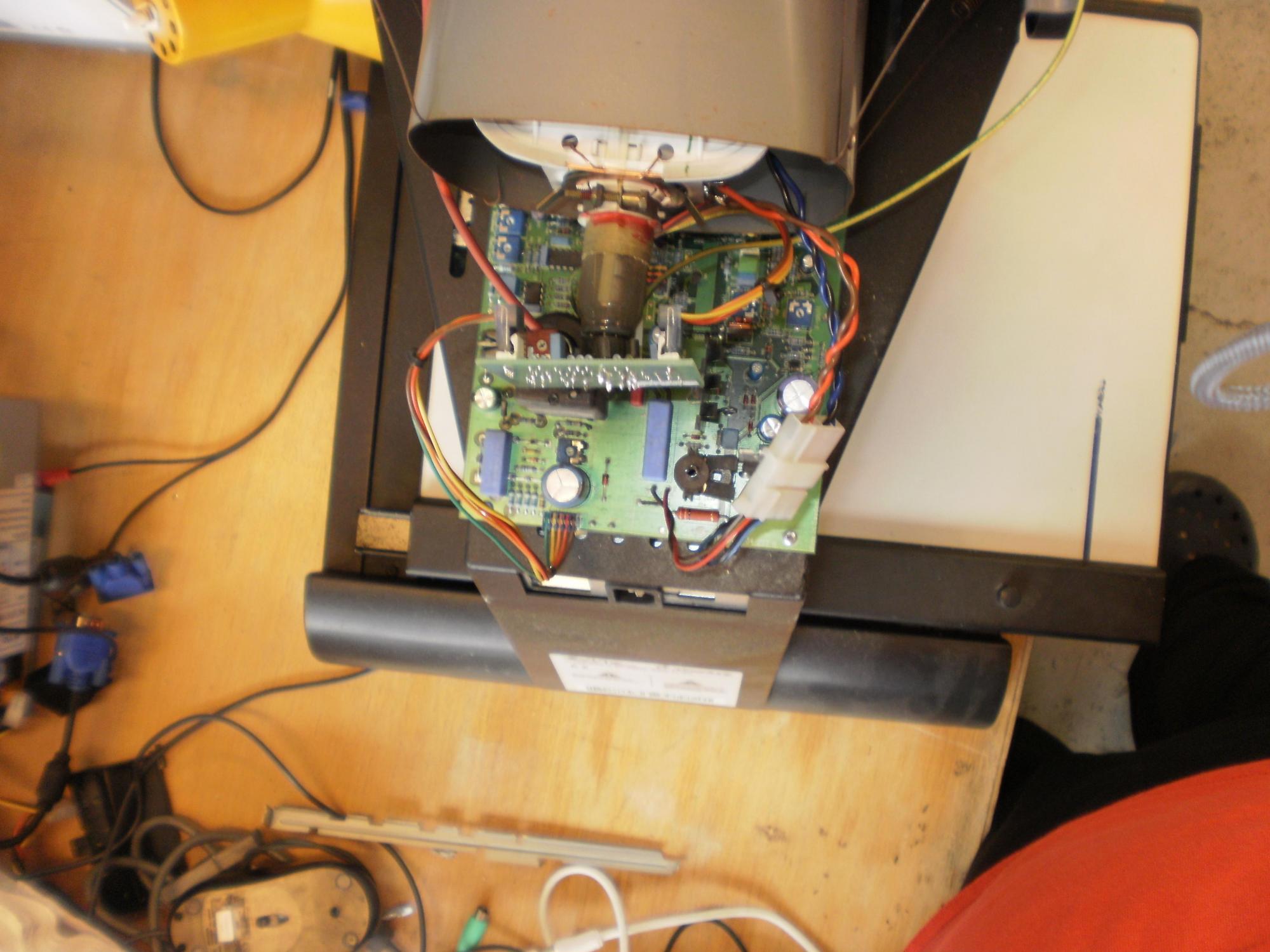

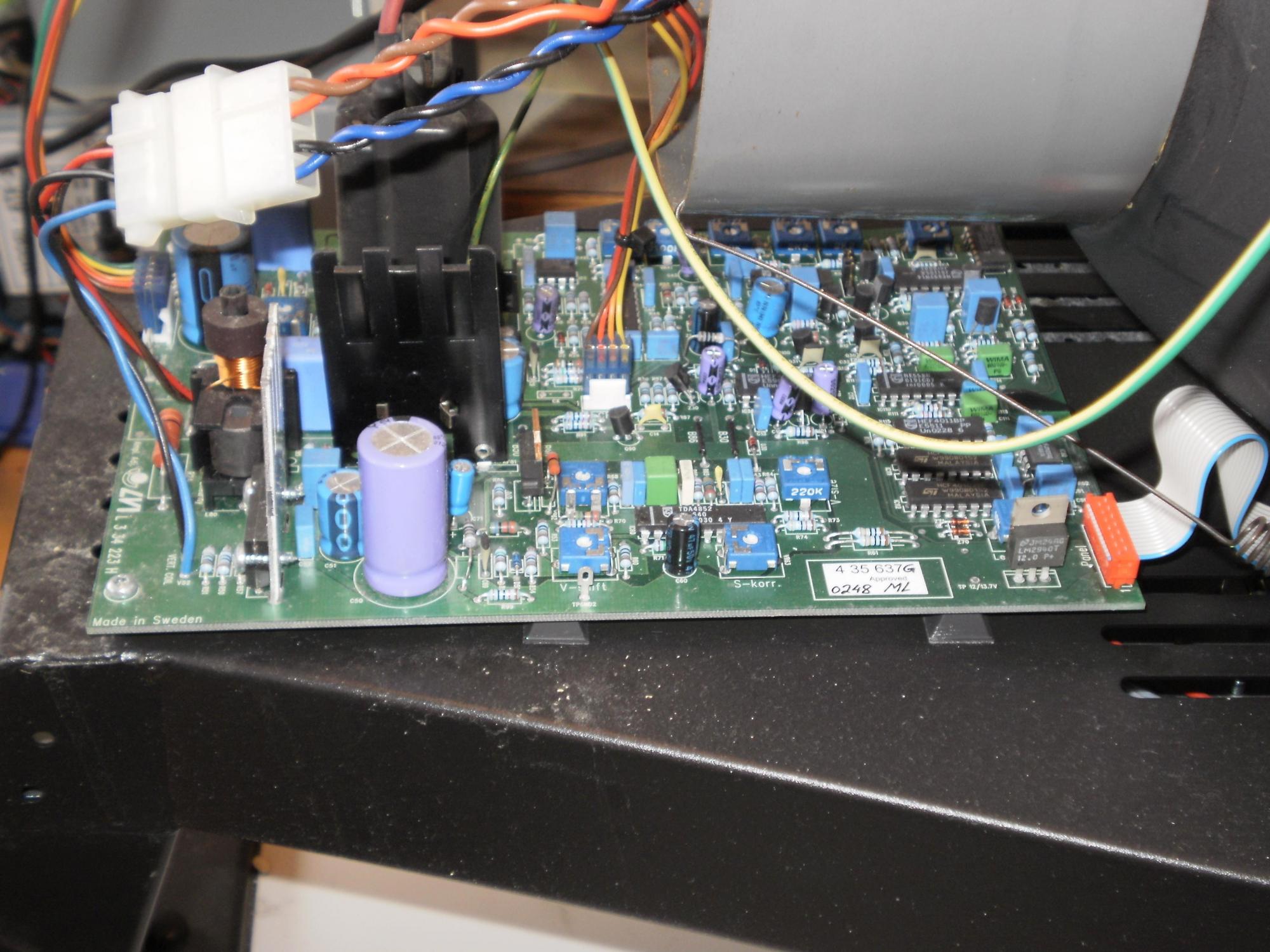

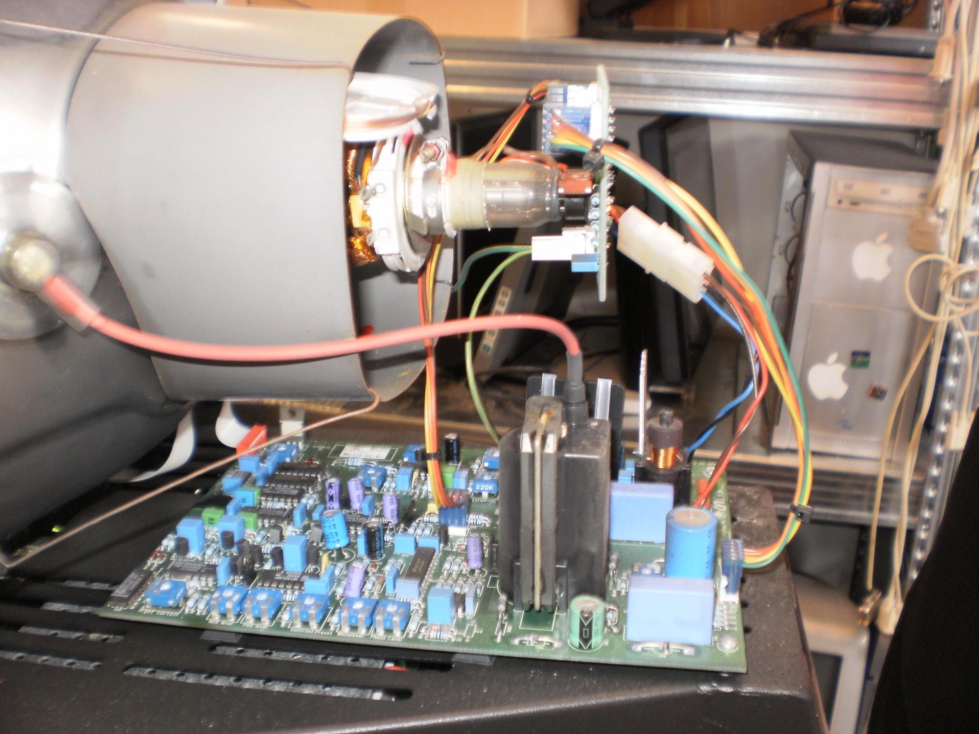

                      Is there any way to determine by those pictures if it's enough to replace the tube to get color? or if I could connect a LCD with out much hasle?
                      Also the only connection leading to the main board is the Orange one.

                        as someone who works at a place that trains and accessess sight disabled people let me say
                        the magnifier probably does not output color.

                          I'd leave it alone, it will be a difficult task to replace the CRT with a colour one
                          Replacing the magnifier with a camera and the CRT with an LCD would probably work but why bother doing that, just get a camera and connect it to your PC.
                          In either case you might as well just leave it as is
