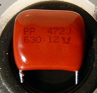

    Hi, i blew an electrolytic cap on a freeview box ( UK digital terrestial ) ,
    so I changed the cap ( and it's immediate neighbor ) for new , same spec.
    I changed the 1N4007 rectifier diode ( 1A 1000v ) on the 240v input and the 200kOhm resistor that was sat parrallel to it.
    I have this capacitor here ( see pic ) but I'm not sure what it is...
    can anyone identify it from the markings and dimensions???
    my guess is a 630v 470nf metal foil in a polypropylene casing?
    or have I got the figures very wrong? 472J ?? what is that?
    Dimensions are... 13mm wide, 11mm tall, 6mm thick, 1mm thick leads which are 10mm apart.
    As I'm a bit dumb... today, google is not my friend, nor is farnell or maplin, or even RS online. hmmm.

    4700pf 4.7nf .047uf J=5%tolerance These are usually cracked when they are bad from the ones I have seen. They were in inverter microwaves.

            Here's just one more.... I've NO IDEA what value it is, I've googled the numbers, tried Ebay etc.... Any clues? is it all JEDEC stuff? ( i say Jedi because you'd have to be as masterful as one to know these things )
            Dimensions are roughly 9mm dia ( round bit )
            5mm thick
            Legs are 10.5mm apart (: ooh err ) and are offset, as in, if I lay it on it's back ( oh mrs ! ) left leg is bottom right, right leg is top left.. if you get what I mean .
            MANY MANY THANKS.. I WILL resurrect this Digital Freeview Box !!! lol.

              2,2nF
              1400VAC support in X configuration
              1250VAC support in Y configuration
              Tolerance M=20%
                Re: Can anyone identify this cap?
                I'm new to both this board and electronics, but that would appear to be a "y-cap" . Its function is to provide filtering from live to neutral or earth if I understand correctly. I'm further assuming that the numbers printed on the front are of its specs, not of the actual part number.

                  2,2nF
                  Tolerance M=20%
                  Hmm i suppose it's obvious when you know what you're looking at, me, personally, CLUELESS !
                  Just as well I'm only replacing like for like, and not trying to bodge things
                  So, being a numpty.. what would I go into a shop and ask for?
