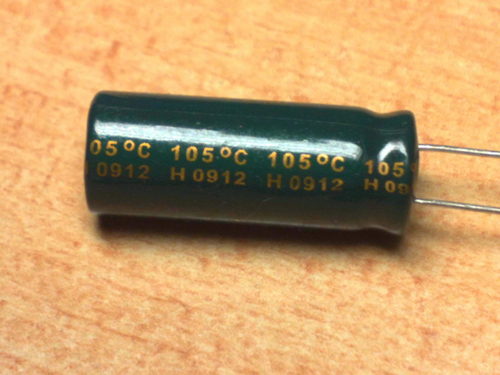

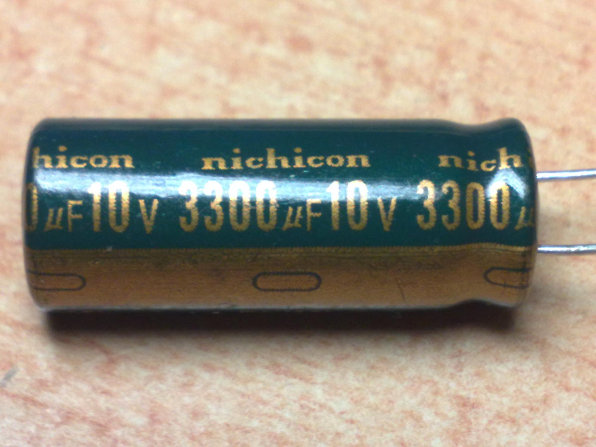

    I recently ordered caps and now as they have arrived, Im wondering why dont match the specs in the datasheet. Maybe fake caps?
    They are labeled as:
    nichicon
    3300 uF 10V
    PL(M)
    105°C
    H 0912
    Can size 10 x 26 mm

          Re: Identifying Nichicon PL
          Here are the pics.
          I bought the caps from ebay.
          @PCBONEZ: Thanks for the datasheet. PM is the successor of PL. But anyways, I measured correct. Of course it can be a custom made cap, but the bottom and top pics make ....doubts...
            Those are fake.
            The vent stamp shape on them is a Teapo Trademark.
            Nichicon doesn't use it because they'd get sued.
            The font also looks wrong.
            I don't think Nichicon ever uses an italic 'u' in uF.
              Fake
              1) The picture (not the drawing) in the datasheet indicates that the bung is wrong. Bung protrudes to raise cap off of board.
              2) Datasheet says marking is "white printing on dark brown sleeve".
              As has been said before, ask here before buying from eBay. Or, completely bypass that venue and go direct to RS or Farnell or similar in your country.
                Vent stamp and the "missing" bung were also suspicious to me.
                Well, they were not announced or sold as Nichicon caps, just as "motherboard caps". So i didnt expect too much.
                Usually i only use Rubycon or Panasonic FM series caps from RS, but no 10mm type was available.
                Anyways they are now in my parents computer which isn't in use very often (probably once a week) so it wont hurt much.
