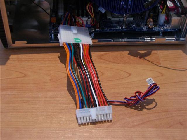

    It comes with a ATX pass-through harness:
    It can draw from +5vsb to keep the display on while the computer is off and show the time. As useless as this may sound, I think it's kinda cool and would like the leave the feature enabled.

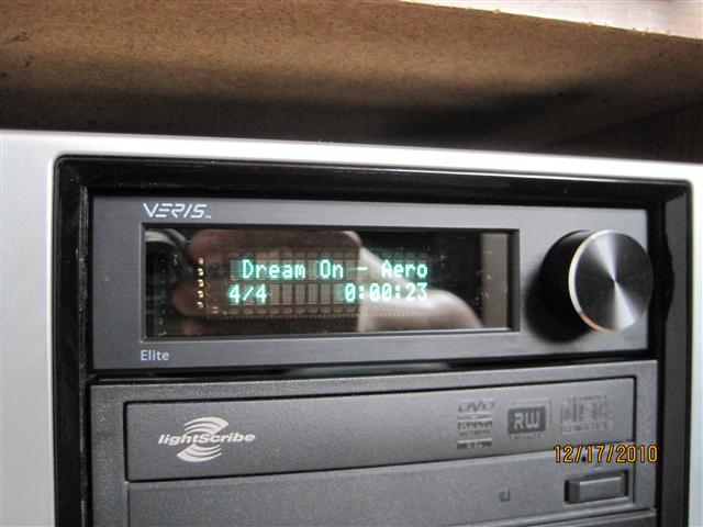

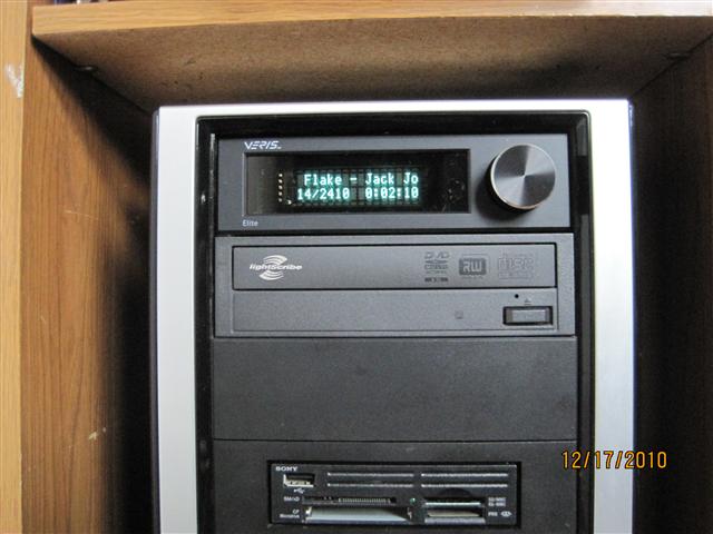

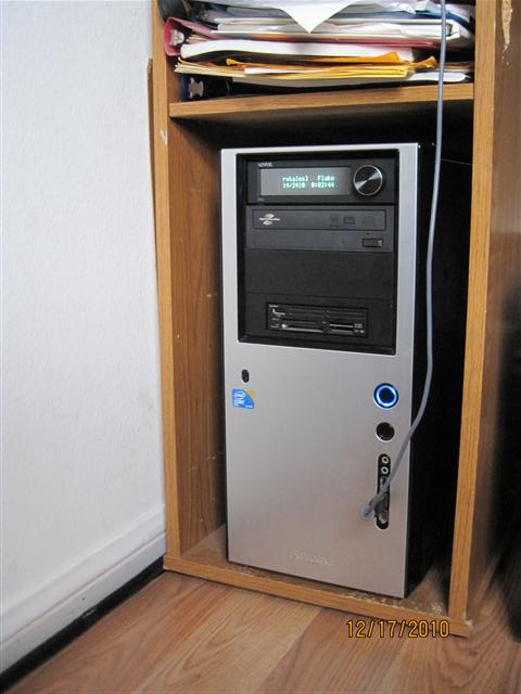

                      It came in today, I just got it installed a few hours ago. The actual VFD is a Samsung unit. Anybody know if they are good?
                      Here are a few pics (it's hard to get a good one of a VFD!). The media center remote is boss.

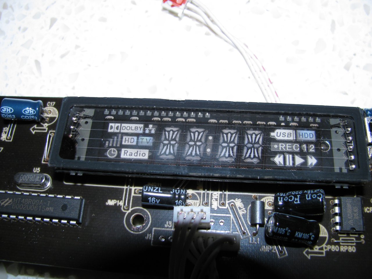

                                Sorry to bring up an old topic, but I have seen a VFD with wear on certain segments on a DVR which is about 4 years old.
