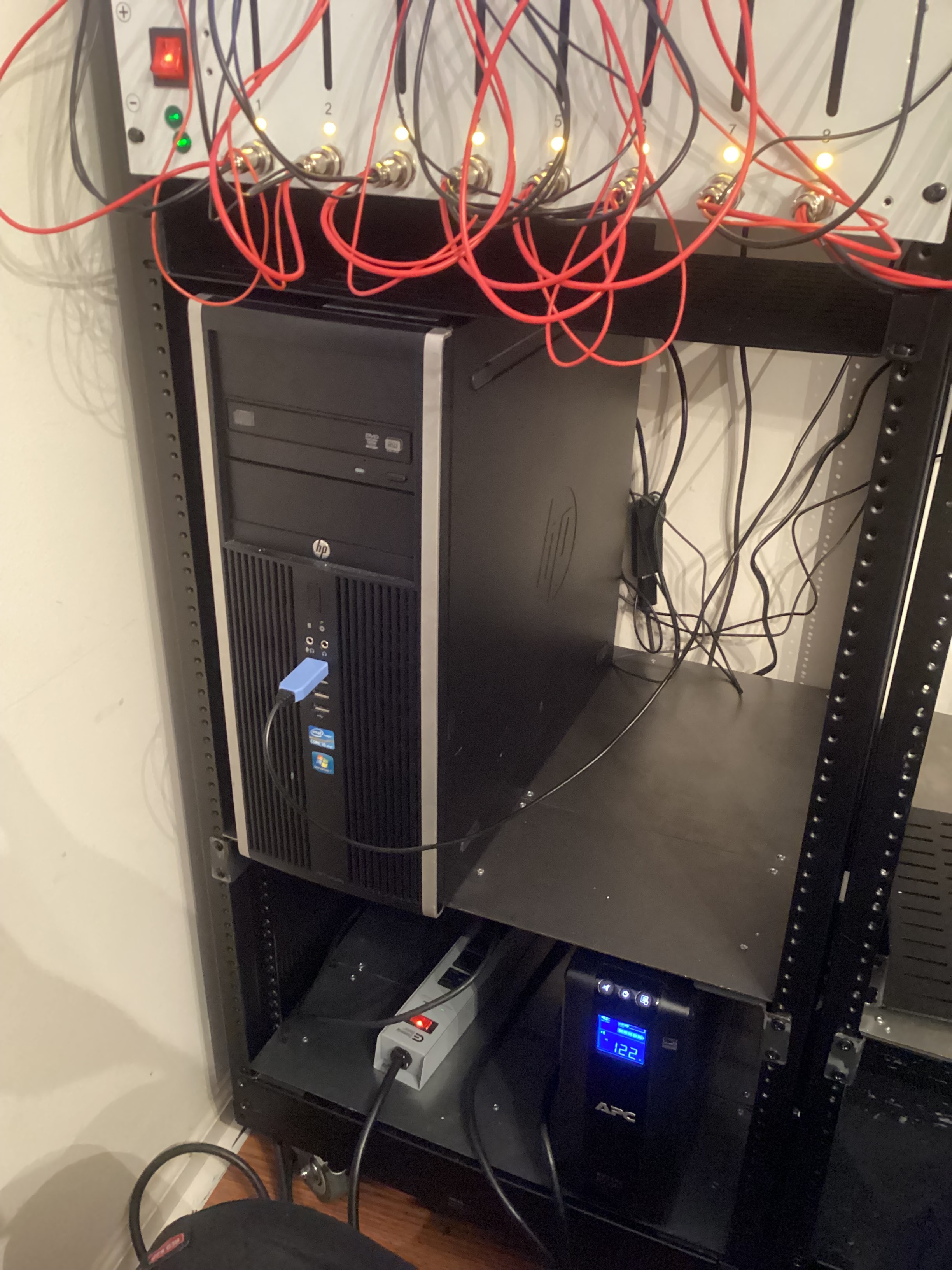

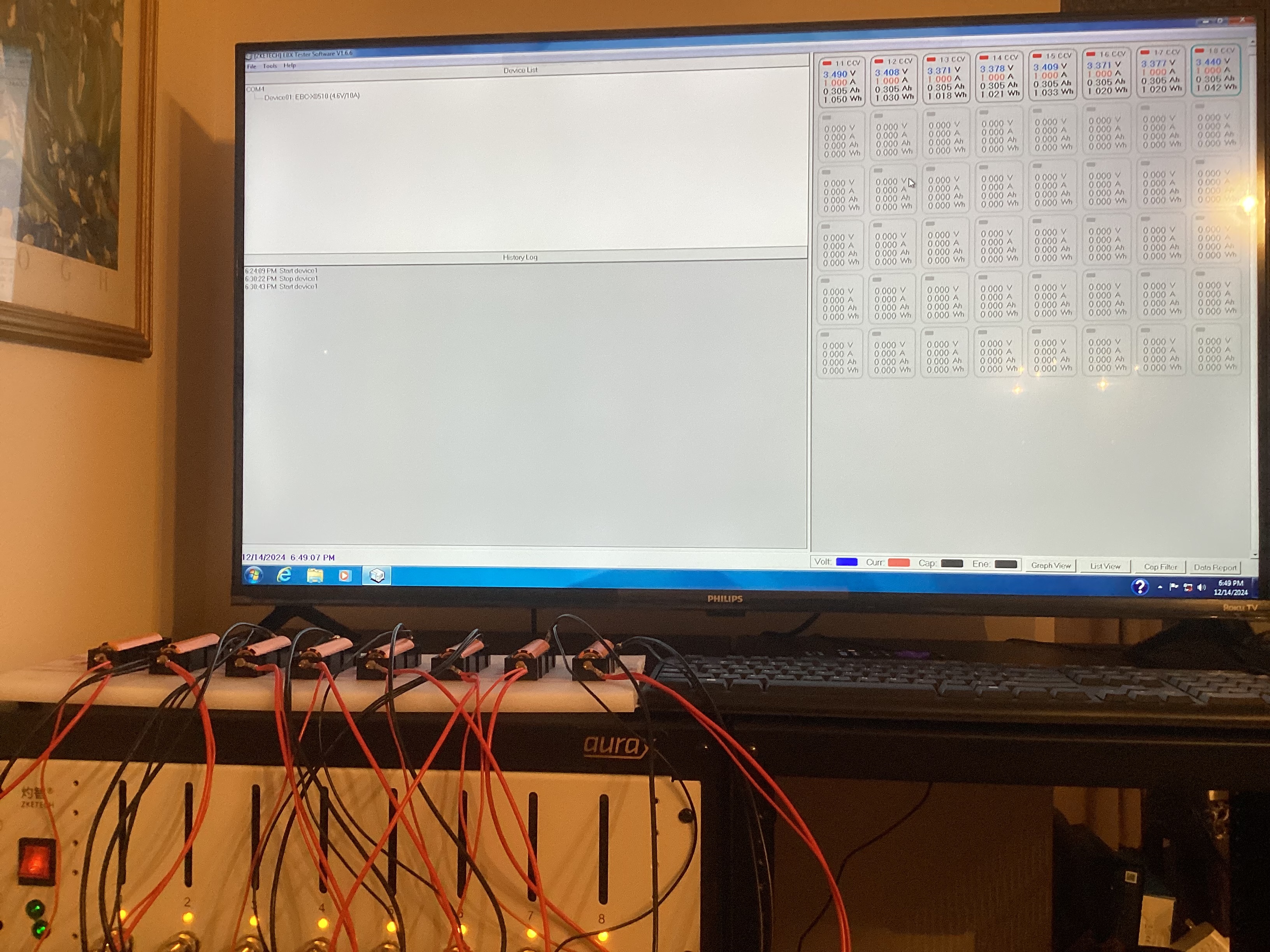

              Well I have one side of the computer cart functioning with the eight channel battery testing up and running and testing a set of battery cells that I have tested a couple of times before but just have not wrote down the milliamperes on but this time I will because I need to put the 21700 battery holder jig on the machine and test some to rebuild two Milwaukee 8 amp hour packs
              I now have to work on the right side of computer cart for the single channel battery testing machines shelf but I have to wait a little bit before I have project money to go further than what I have done so far
              To make a single heavy duty shelf cost $42.00 for the shelving rails the support rails $25.00 each need 1 and half of another one and $25.00 for a 16 gauge sheet metal for actual total cost of a single shelf is around $100.00 but I do not want to the shelves to fall down because of to much weight on them this is the reason for the over kill
              The second computer will sit on the same shelf that the other one is sitting on now
              The right side will have the BMS testing station on this side I have two 5u empty enclosures that I going to use for the single battery testing machines and the 24 volt adjustable voltage and current switching power supply that I have talked about in another post all of the displays for the voltage and current will be in front of the enclosure with the display of the battery testing machine as well as but this is going to take some time to put in together and it be very time consuming process for this part of this project
              Having a 40” monitor is a very big plus for this project to be able to see and being able to read the side bars of the graph cart a small monitor screen just dose not cut it

                Well I put the first set of 21700 batteries on the battery testing machine and it is now rocking and rolling and well on the way to rebuilding two Milwaukee M18 8 amp hour battery packs that are way out of balance and the battery cells just need to be replaced and start over again with a fresh set of batteries

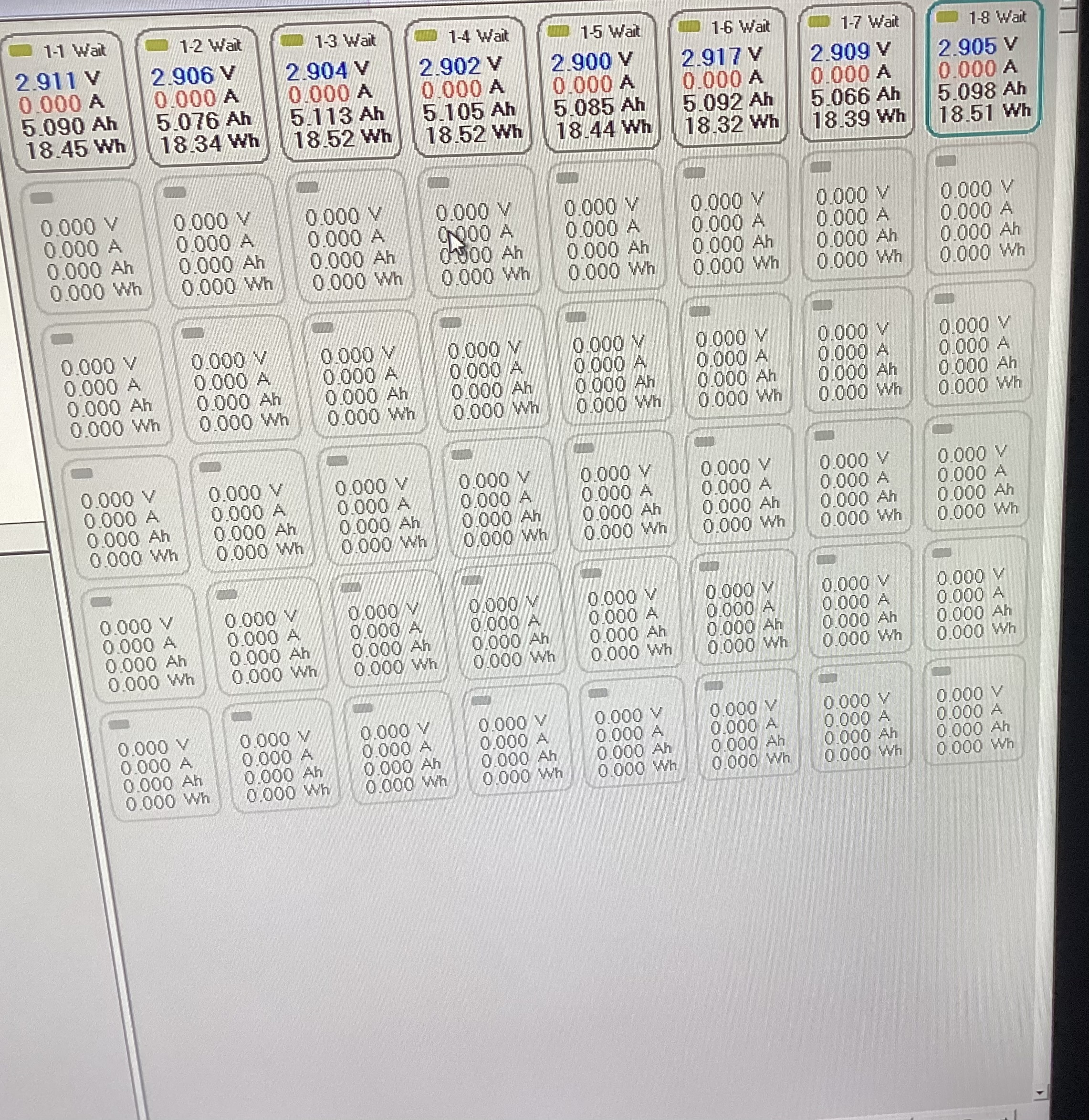

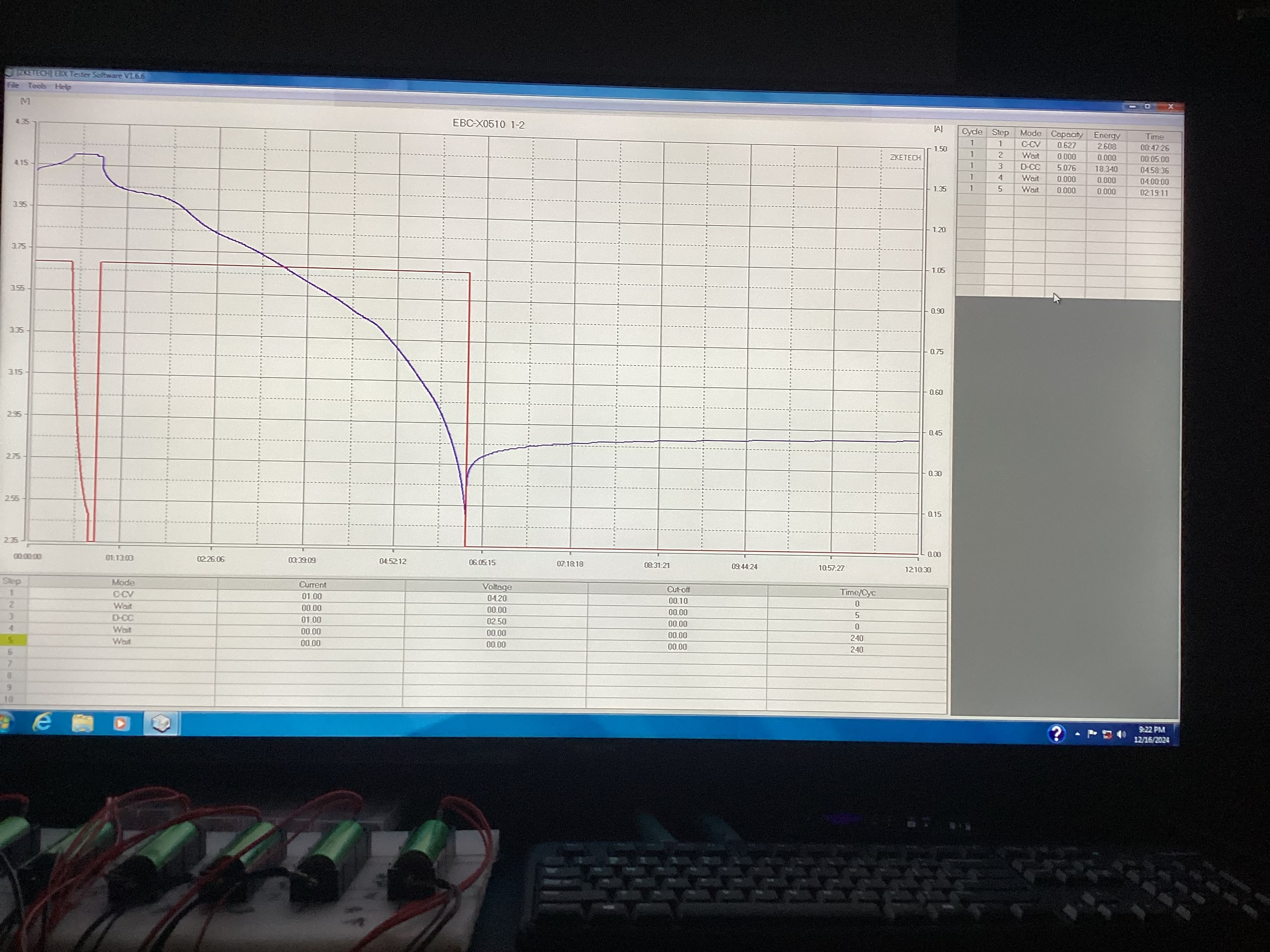

                    Here are the test results from the first batch 21700 battery cells the milliamperes hours are all over place when there are more than 0.100 volts all over the place but what is interesting about these battery cells load tested to 2.50 volts and it has almost reach 3.00 but all of this batch of battery cells are around the same voltage and they are testing above 5 amp hours the charge and more importantly the discharge curve really looks very nice
                    The one thing that you have to pay attention to is the parameters values that you are putting in because I did not catch the mistake until this morning that is the reason that you see very little charging curve time value instead of one amp it was set by default to 0.100 amps for the discharge for the load test

                        Well it takes almost all night to test one set of these battery cells because of them being rated for 5 amp hours
                        4.5 hours to charge up and a little bit over 5 hours to discharge them and this set of battery cells the milliamperes hours are also all over the place as well I show the results later on today or tonight once I see how well they recover from being discharged
                          • Jul 2011
                          • 6069
                          #32
                          This batch of batteries that I bought are good that they are testing over 5 amp hours but the amps hours beyond 5 amp hours are as follows
                          0.0500 to 0.1180 these battery cells are not match at all I can make two battery packs but the tolerance is not as close as I would like it to be I might have to settle for 0.250 between the first battery cell and the last battery cell oh well it is what it is

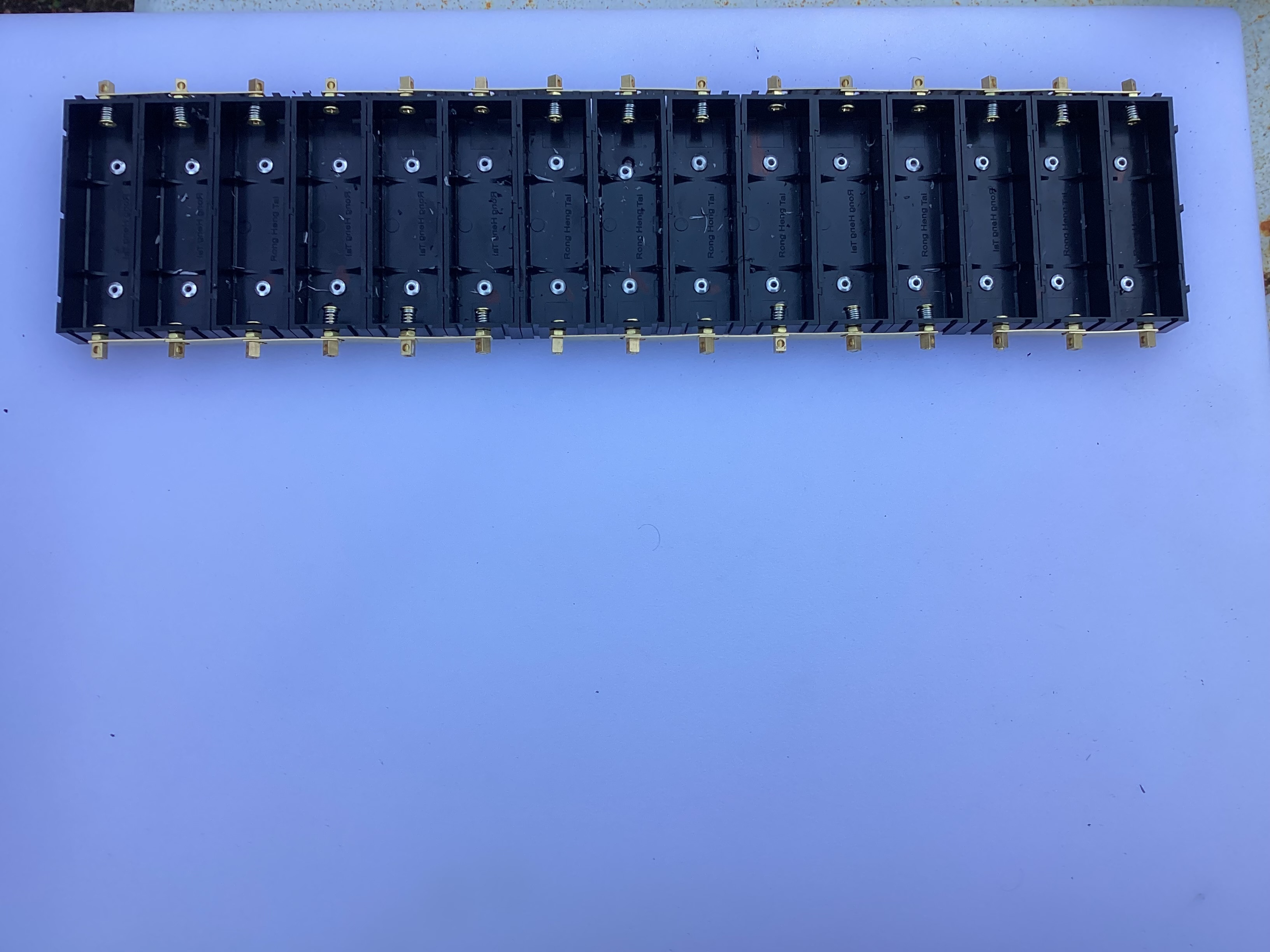

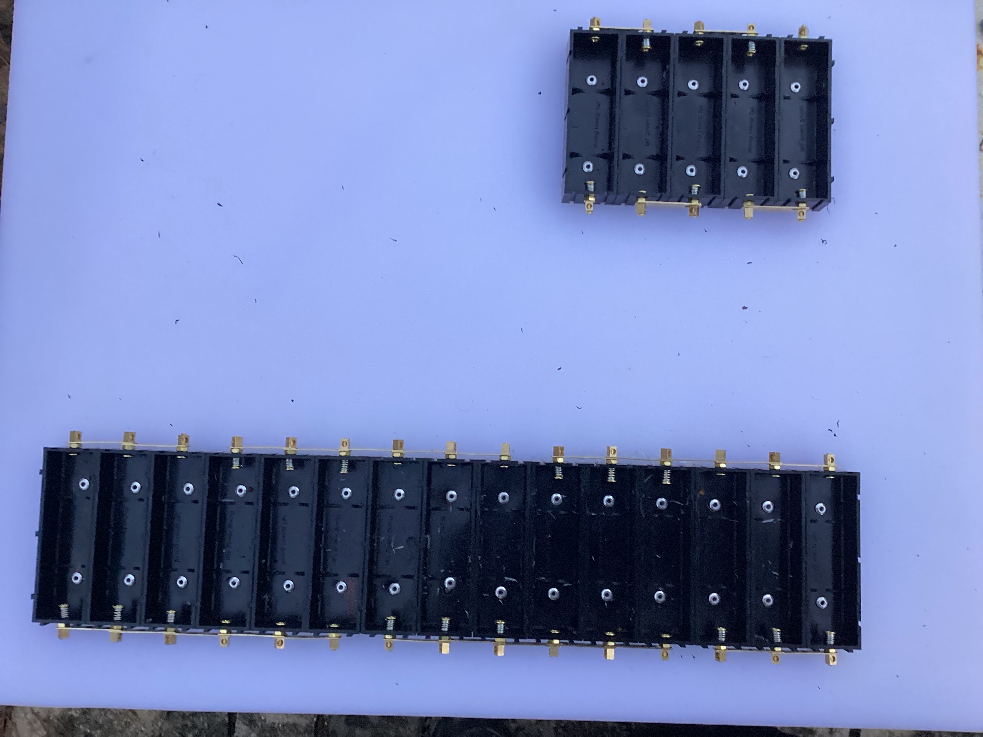

                                Update I finally finished the mounting of the 21700 battery holders on the cutting board now I have work on the Milwaukee battery pack jig part of it but I am not sure if I have the inter connecting wires between the BMS protection board and the battery holder connection points I will have to look and see if I have what I need to this part of this project
                                The first picture is for the three P and the five S so I can see how well balanced I have the battery pack in the second picture you see the one P and the five S I can see how balance a single row battery pack behaves
