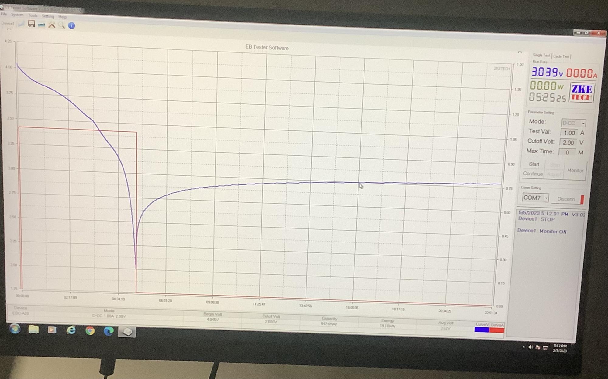

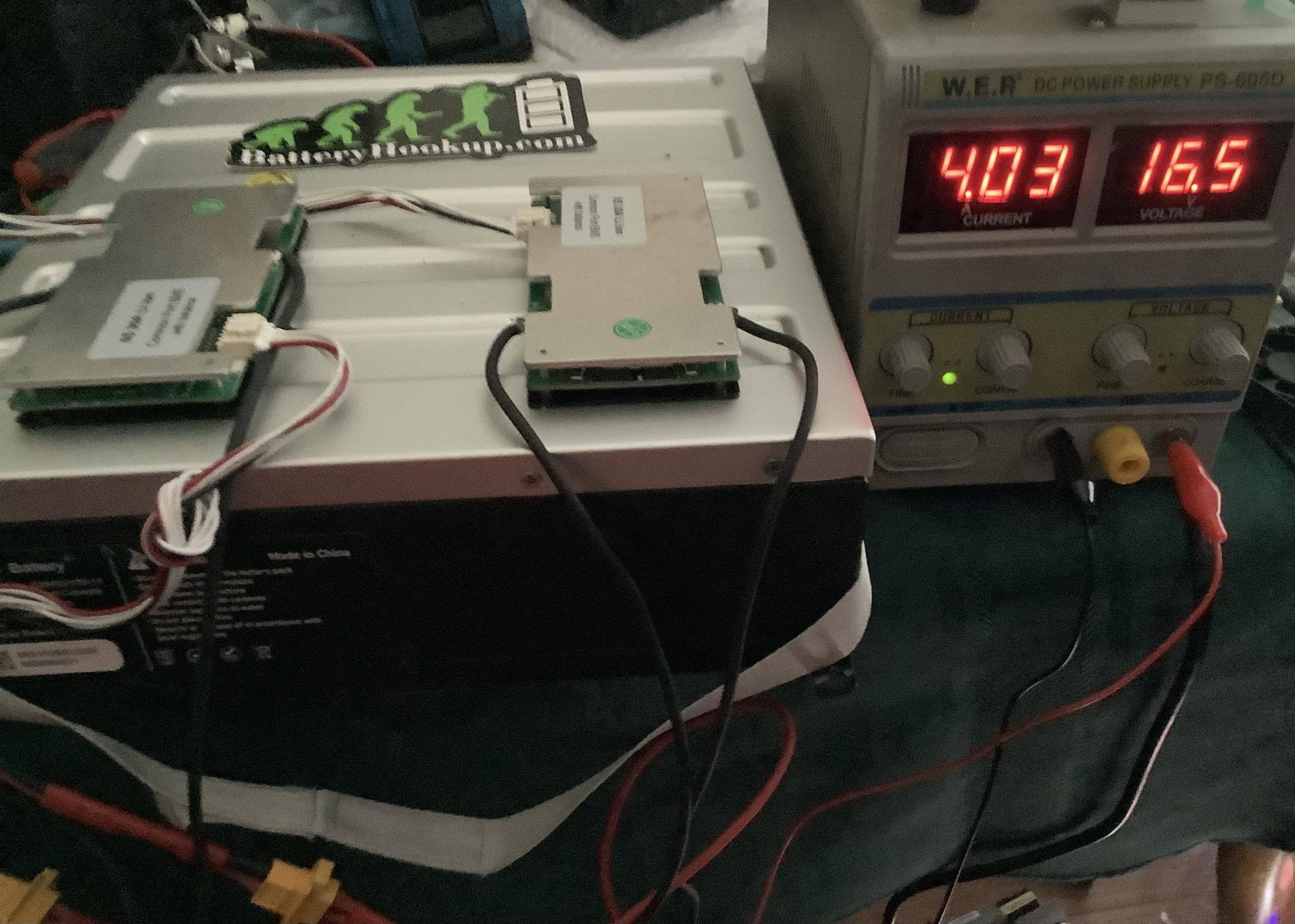

    I decided to try a new approach to testing unbalanced battery cells with my battery testing machine that has more graph curve information and it looks like if you discharge them to 2.00 volts if the battery voltage does not come back to over 3.something volts you have some kind of issue with that battery cell
    I going to do more testing and see if is the case or not
    More to come later

    Re: Some New Preliminary testing of 21700 Tool battery cells to 2.00
    I am testing the second battery pack the same way it does take a while for the battery cells on the battery cells rail on the one you load tested several hours to stop with gradual voltage increasing to see where it finally stops at to get an idea if those cells are going to be any good

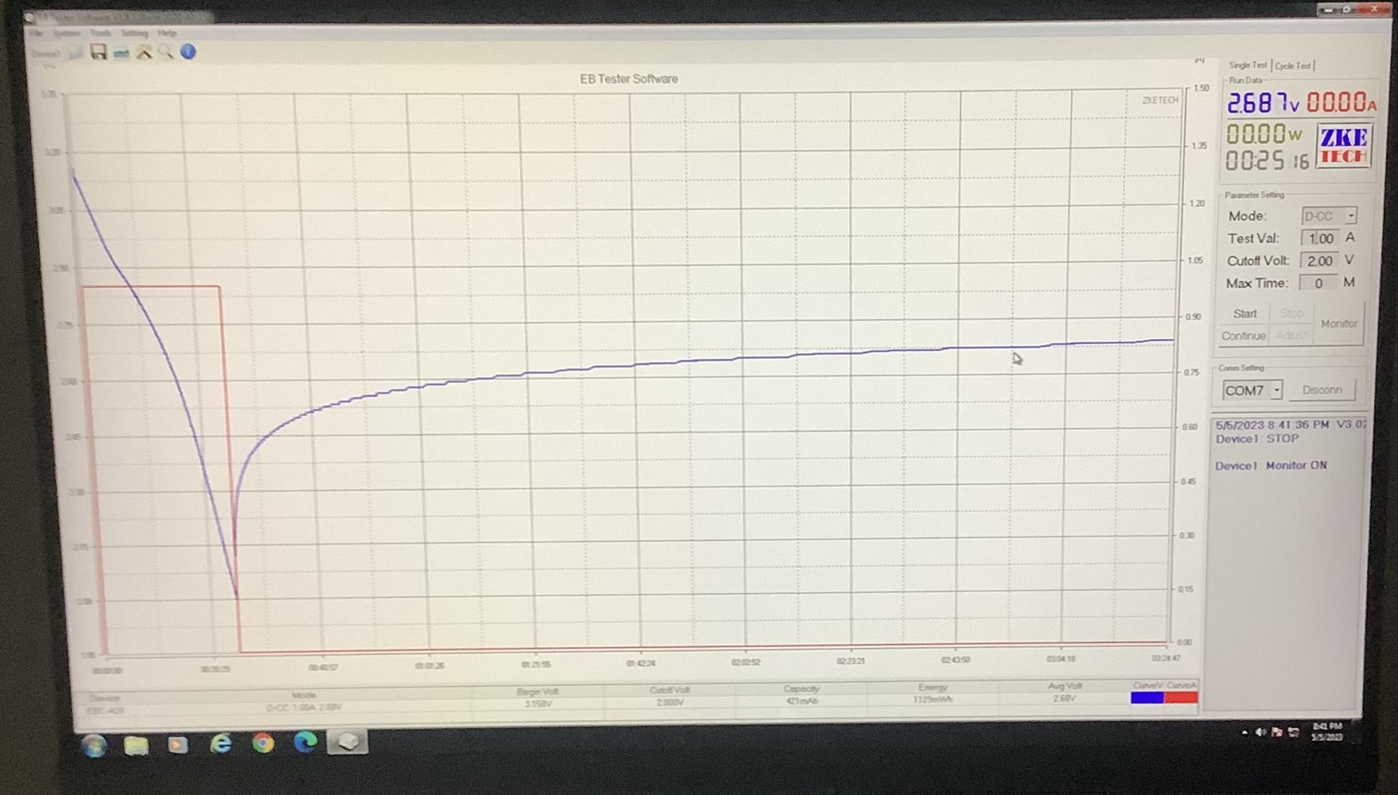

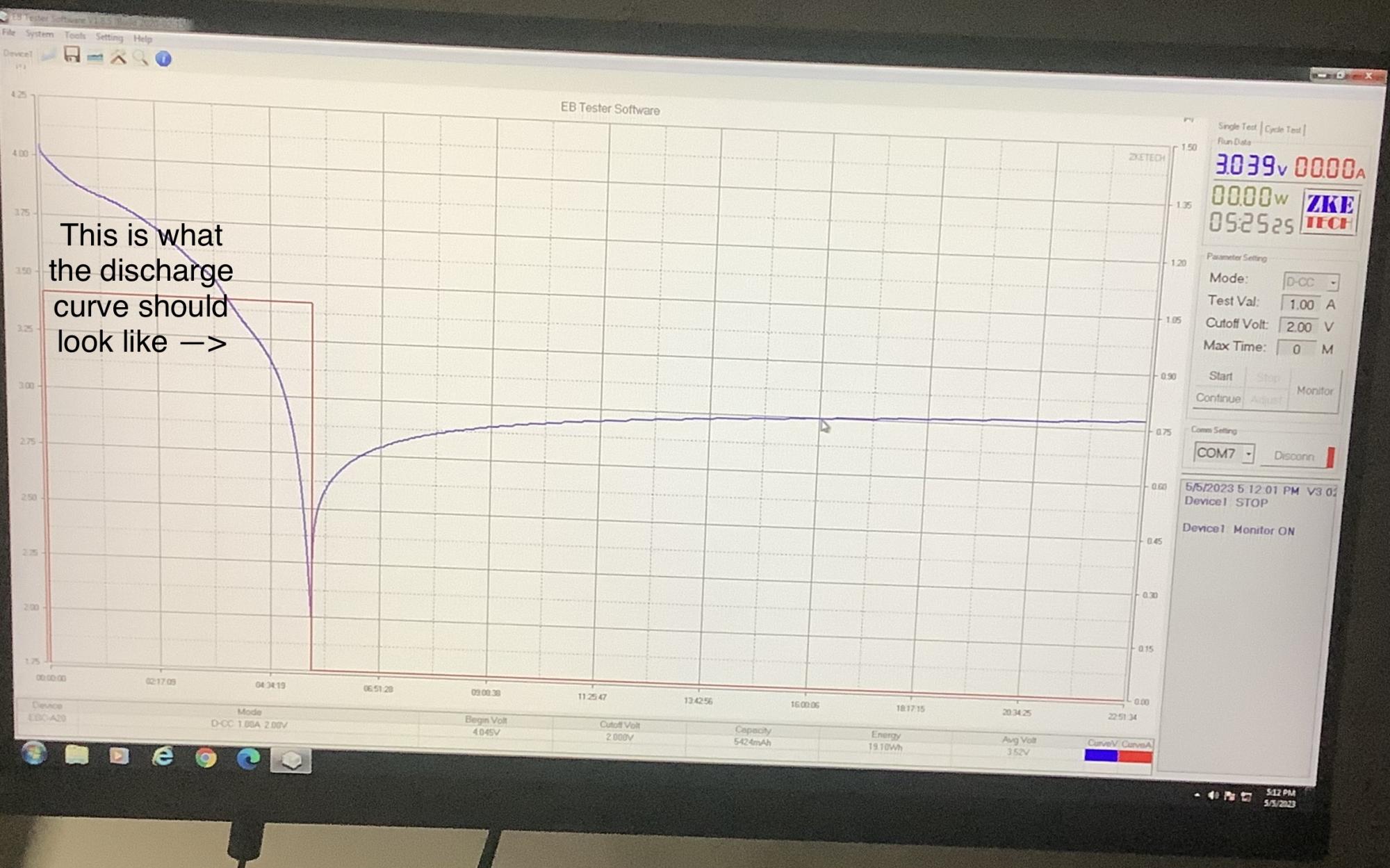

      Here are the results from one battery cell that was at 4.00 as you can see in the graph it takes about 10 hours to climb above 3.00 after being load tested to 2.00 volts @ one amp load
      Here was the result from the second battery that was at 3.15 the same test was run I going to compare them as far as how long it takes to climb above 3.00 volts
      One thing you will notice is that the battery cell that started at 3.00 volts has a much steeper roll off rate than the one that started at 4.00 if the battery cell that starts 3,00 volts if it were as good as the 4.00 battery cell it just would be tighter together time wise but would still have basically the same voltage roll of rate
      But what is interesting is that voltage recovery curve is basically the same rate of recovery rate at the beginning but I wonder if the voltage recovery will continue to be the same as far as the amount of time that it takes to recover to above 3.00 if it does recover to that point
      I checked the voltage on the first battery pack that I tested and the voltage range is 3.1something to 3.2something but did not leave them on the battery testing machine until the battery voltage went above 3.00 volts so do not have those results to share unless I rerun the test again
      But I think the issue with these two battery packs is that the battery cells that are low in voltage is because they are self discharging over a period of time ( which takes around about a month or so ) and or battery cycles which in either case they are not suitable for tool use anymore unless the battery cells that have been discharging by themselves are removed and replaced with battery cells that are not self discharging this is what my next step is going to be and see if these battery cells are still usable with the same discharging rate
      I will post more information about this issue when I have more data from more battery testing
      Stay tuned for updates as they come available

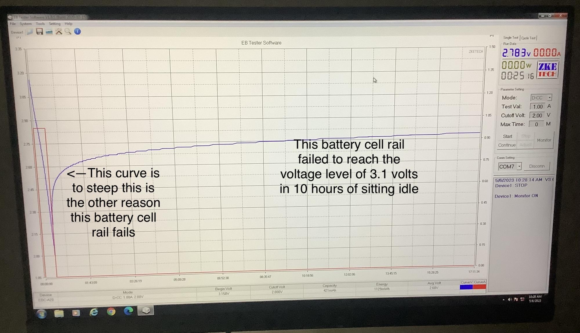

          Here are the final results of the second battery cell rail failed for two reasons see the picture below
          I will be testing the next battery cell rail sometime today
