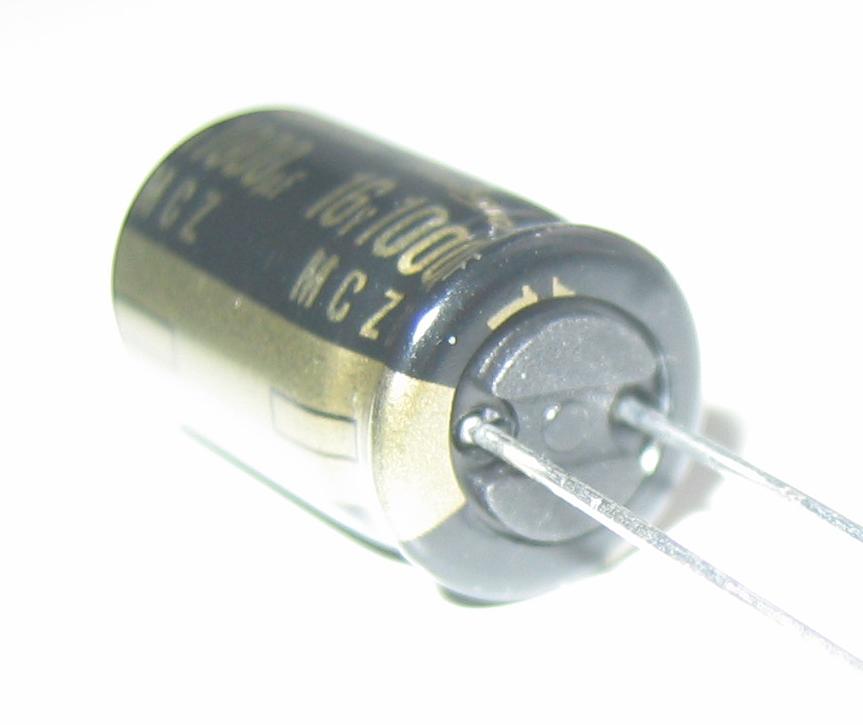

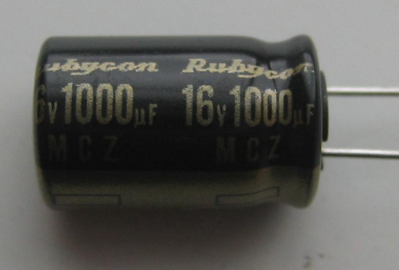

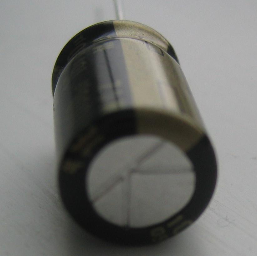

                          Good. I'd like some pics of them when you get them, please.
                          Top, bung, and printing on both sides of the sleeve.

                            These are not the same caps, but I got them from the same vendor as mentioned above. Mine are 1000uF 16V.
                            Sorry, it is very overcast rainy day here today so the pc quality isn't the best.

                              They certainly -look- authentic. But, I'd like one of the gurus that are more familiar to verify. There are many fakes and I'm not sure of this vendor. I'd still like to see pics from MrCurious when his arrive.
