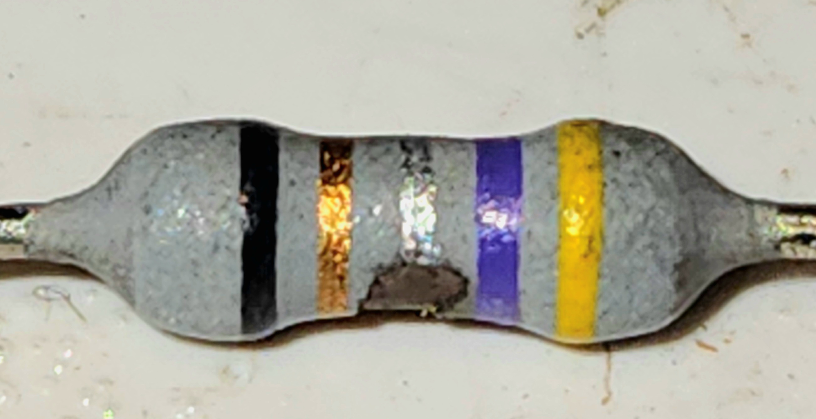

    Hi! This is probably a dumb question but I can't really figure out the value of this resistor.
    Can anyone help?
    Thanks!

    Re: Identify a resistor
    0.47Ω non-inductive
      0.47Ω, ±5%
      One key is that the metallic bands (silver/gold) are not significant digit colors and since there are at least two significant digits, it's not the black side that goes first.
          0.46Ω, ±5%
          Flame-retardant resistor type "Anti-pulse".
            Originally posted by eccerr0r
            0.47Ω, ±5%
            Thank you for the reply.
            What does this black stripe means?
              In most cases the last black band indicates non-inductive
              If it was White, it would be Fusible
              In some cases it is Temperature Coefficient (Black= 250ppm/K)
