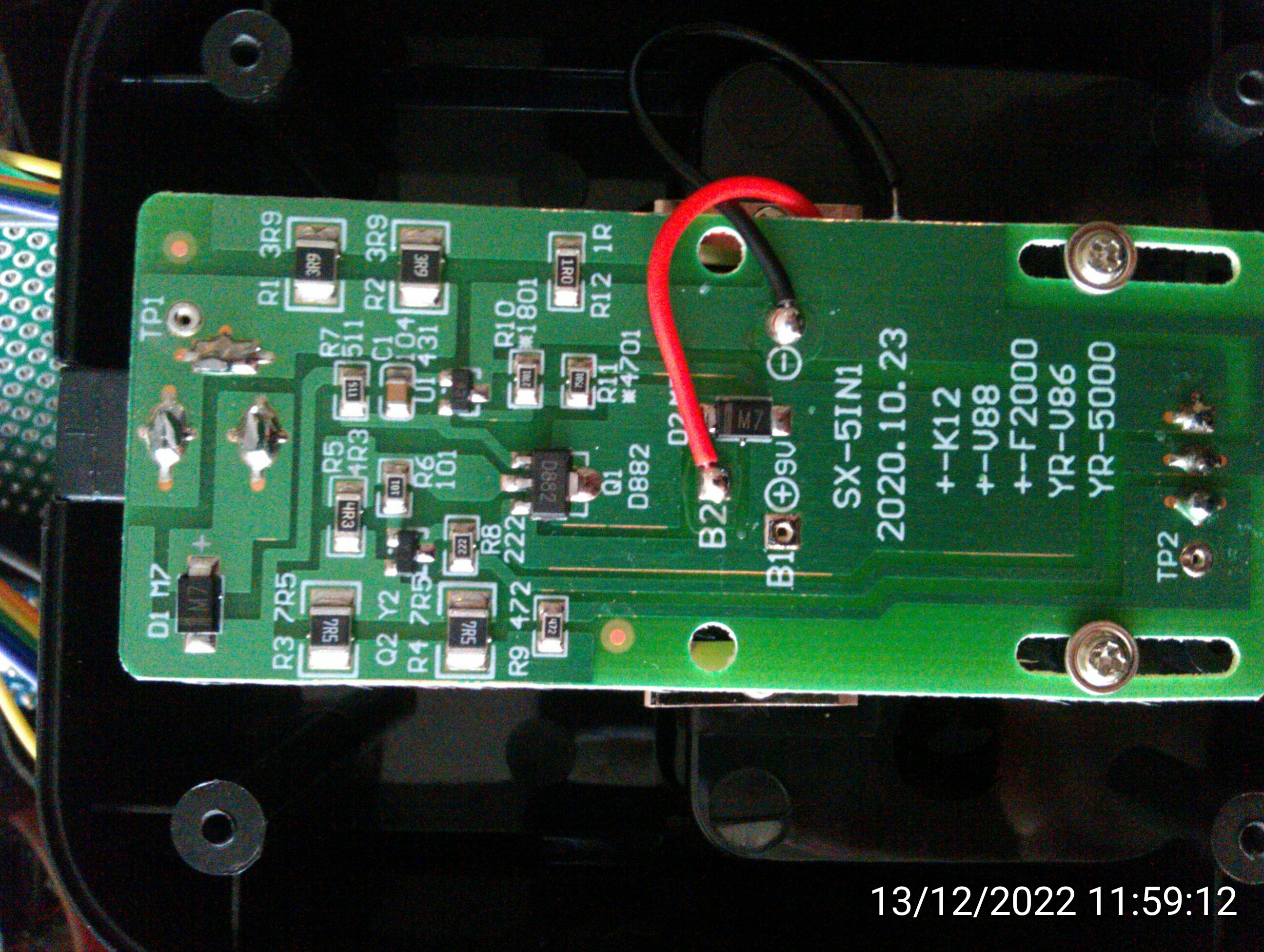

Anyone tried or got the Aixun T3A with the T245 pen?
  • CapLeaker
    Leaking Member
    • Dec 2014
    • 8177
    Anyone tried or got the Aixun T3A with the T245 pen?
    On the recent sale I've ordered a new Aixun T3A with the T245 soldering pen and it comes with the fancy pen holder. Wonder if anyone has one and if your happy with it? It's got some decent reviews. On YouTube a guy compared it with the JBC and results were pretty darn good fur such a cheap rig.
  • diif
    • Feb 2014
    • 6978
    • England
    Re: Anyone tried or got the Aixun T3A with the T245 pen?
    I'm very happy with mine.
    • CapLeaker
      Leaking Member
      • Dec 2014
      • 8177
      Re: Anyone tried or got the Aixun T3A with the T245 pen?
      I should get mine soon. Hope it is as good as everyone sez it is.
        • 31040
        Re: Anyone tried or got the Aixun T3A with the T245 pen?
        damn, i forgot about that - i should have got one on the 11:11 sale
        not that i wasnt blowing cash though,
        ordered this because it blows away a logic probe and is tiny.
        https://www.aliexpress.com/item/1005001969702720.html
        and this - just because
        https://www.aliexpress.com/item/1005003028392011.html
        • CapLeaker
          Leaking Member
          • Dec 2014
          • 8177
          Re: Anyone tried or got the Aixun T3A with the T245 pen?
          stj, you still did pretty darn good with those items. I didn't even know about that Radtel. Dang! Yep, I picked up that Aixun T3A on that sale and I've got me two Shelly plus one's. One of them is going into my air exchanger
          https://www.aliexpress.com/item/1005...d=TGZAHBIOM2Cd
          https://www.shelly.cloud/en/products/shop/shelly-plus-1
          Last edited by CapLeaker; 12-04-2022, 06:06 PM.
            • 31040
            Re: Anyone tried or got the Aixun T3A with the T245 pen?
            the shelly looks good, i presume your going to flash it with Tasmota.
            • CapLeaker
              Leaking Member
              • Dec 2014
              • 8177
              Re: Anyone tried or got the Aixun T3A with the T245 pen?
              I guess that depends on what I am going to control with the Shelly. The one that goes on my air exchanger, probably not. I just want it to run on a schedule. The second one I am going to play with for a while. This one I am going to at least try Tasmota and see how that goes.
              • CapLeaker
                Leaking Member
                • Dec 2014
                • 8177
                Re: Anyone tried or got the Aixun T3A with the T245 pen?
                Finally my Aixun T3A arrived. Pretty impressive little thing for its size and heats up in 3 seconds flat. Haven’t used it on any serious soldering job yet, but on all the things I used it it on so far it worked really good. If there is anything bad I can say about it so far is putting the foam on the T3A handle.
                  • 31040
                  Re: Anyone tried or got the Aixun T3A with the T245 pen?
                  well, the radtel is surprisingly good - and very compact!
                  but the charger is a joke and it's psu - lets just say hell-no!
                  psu is well built but the transformer is 12mm square - no way i'm trusting the seperation/isolation on that!
                  the charger base uses descrete current limiting and has a voltage reference and comparater to control the led colour!!
                  it's also only 400mA so slow as fuck.
                  i already stripped the board and added a TP5100 module for controlled 1A charging
                  • CapLeaker
                    Leaking Member
                    • Dec 2014
                    • 8177
                    Re: Anyone tried or got the Aixun T3A with the T245 pen?
                    I guess you MUST post pictures. Sounds interesting!
                      • 31040
                      Re: Anyone tried or got the Aixun T3A with the T245 pen?
                      damn, i forgot to take pictures before i closed it - o.k. i'll open it again later
                      • CapLeaker
                        Leaking Member
                        • Dec 2014
                        • 8177
                        Re: Anyone tried or got the Aixun T3A with the T245 pen?
                        I have also a new projects on my to do list. One of them is to convert an AliExpress UV eraser that works on 220V over to 110V using the voltage doubler trick with a full bridge rectifier and 2 capacitors.
                          • 31040
                          Re: Anyone tried or got the Aixun T3A with the T245 pen?
                          or just buy a ballast?
                            • 31040
                            Re: Anyone tried or got the Aixun T3A with the T245 pen?
                            shit radio charger
                            • CapLeaker
                              Leaking Member
                              • Dec 2014
                              • 8177
                              Re: Anyone tried or got the Aixun T3A with the T245 pen?
                              Wtf? That came with the Radtel? Really really? How is the radio itself?
                                • 31040
                                Re: Anyone tried or got the Aixun T3A with the T245 pen?
                                radio is fine
                                https://chirp.danplanet.com/attachments/7910
                                https://chirp.danplanet.com/attachments/7911
                                https://chirp.danplanet.com/attachments/7750
                                https://chirp.danplanet.com/attachments/7912
                                • CapLeaker
                                  Leaking Member
                                  • Dec 2014
                                  • 8177
                                  Re: Anyone tried or got the Aixun T3A with the T245 pen?
                                  These links give me an empty page?
                                    • 31040
                                    Re: Anyone tried or got the Aixun T3A with the T245 pen?
                                    https://chirp.danplanet.com/issues/9665
                                    • CapLeaker
                                      Leaking Member
                                      • Dec 2014
                                      • 8177
                                      Re: Anyone tried or got the Aixun T3A with the T245 pen?
                                      That worked perfect!
                                        ASUS ROG G512LI-HAPPY Notebook Strix G15 Specification for Upgrade or Repair
                                        This specification for the ASUS ROG G512LI-HAPPY Notebook can be useful for upgrading or repairing a laptop that is not working. As a community we are working through our specifications to add valuable data like the G512LI-HAPPY boardview and G512LI-HAPPY schematic. Our users have donated over 1 million documents which are being added to the site. This page will be updated soon with additional information. Alternatively you can request additional help from our users directly on the relevant badcaps forum. Please note that we offer no warranties that any specification, datasheet, or download for...
                                        09-06-2024, 11:40 PM
                                      • tony359
                                        Aixun T3A overshooting?
                                        by tony359
                                        I've just purchased an Aixun T3A T245 soldering station and I am pretty happy with it, coming from a Hakko knockoff.
                                        However, I purchased a genuine JBC tip and the temp massively overshoots with it. I can see a similar behaviour with the Aixun tips but not so horrible.
                                        With the JBC tip on the thermometer I see the temp more or less stable but slowly dropping. At some point there is a 100% power spike and the registered temp goes +40C from where it was - obviously the display doesn't show anything!
                                        Is this "expected"?...
                                        09-12-2023, 10:19 AM
                                      • cheeky2
                                        Sony RB2G Chassis KDL-55W815B MAIN BOARD 2 Blink Error issue resolved! Happy days :)
                                        by cheeky2
                                        For anyone interested just repaired this Sony Main board TV that had a 2 blink error code, the chassis is a RB2G which is common to quite a few different Sony models. The Ceramic 10uF 25V X7R 1206 capacitor C9114 was shorted which took the smd 2A 0603 fuse out F9101. This was powering the Buck converter TPS54332 which caused no 5V output from it.
                                        See the attached picture of the locations of both components. I also attach the best service manual I found for this board for anyone else in a similar position of trying to repair this main board. It's not specific to the TV model however it gives...
                                        01-08-2024, 05:56 AM
                                      • Sudoer
                                        DIYPHONE Store and AIXUN T420D
                                        by Sudoer
                                        I've seen enough reviews of AIXUN T420D on YouTube and decided to try it. One handle defective from the inside, ruined 3 JBC tips, just destroyed the plastic on the tips. One stand does not work, the soldering handle not drop the temperature. Because the seller refused to return the money, and AliExpress supported him and even PayPal did not help, I can disassemble this piece of shit and see what inside, if anyone is interested. The seller said that the station does not work with JBC handles, but I checked that it works. It's just a pity to connect the original handle to this shit. Beware of order...
                                        05-04-2023, 04:55 AM
                                      • Th3_uN1Qu3
                                        Disposable e-cigarettes, lithium pollution and why you should be happy and exploit it
                                        by Th3_uN1Qu3
                                        I know, this comes in late, Big Clive did a video on them a couple years ago, but it is just last year that the disposables market has exploded here and I literally only have to walk for 5 minutes to find at least one.
                                        On one hand, 5 of the cheapest disposables will buy you a basic pod vape which is 100x better and the replacement pods are half the price of a disposable once you burn the heater, but on the other, they are getting better (I'm starting to see better builds, ends that don't just fall off but are actually quite stubbornly fit and 550mAh instead of 300mAh batteries on...
                                        02-05-2023, 07:44 PM
