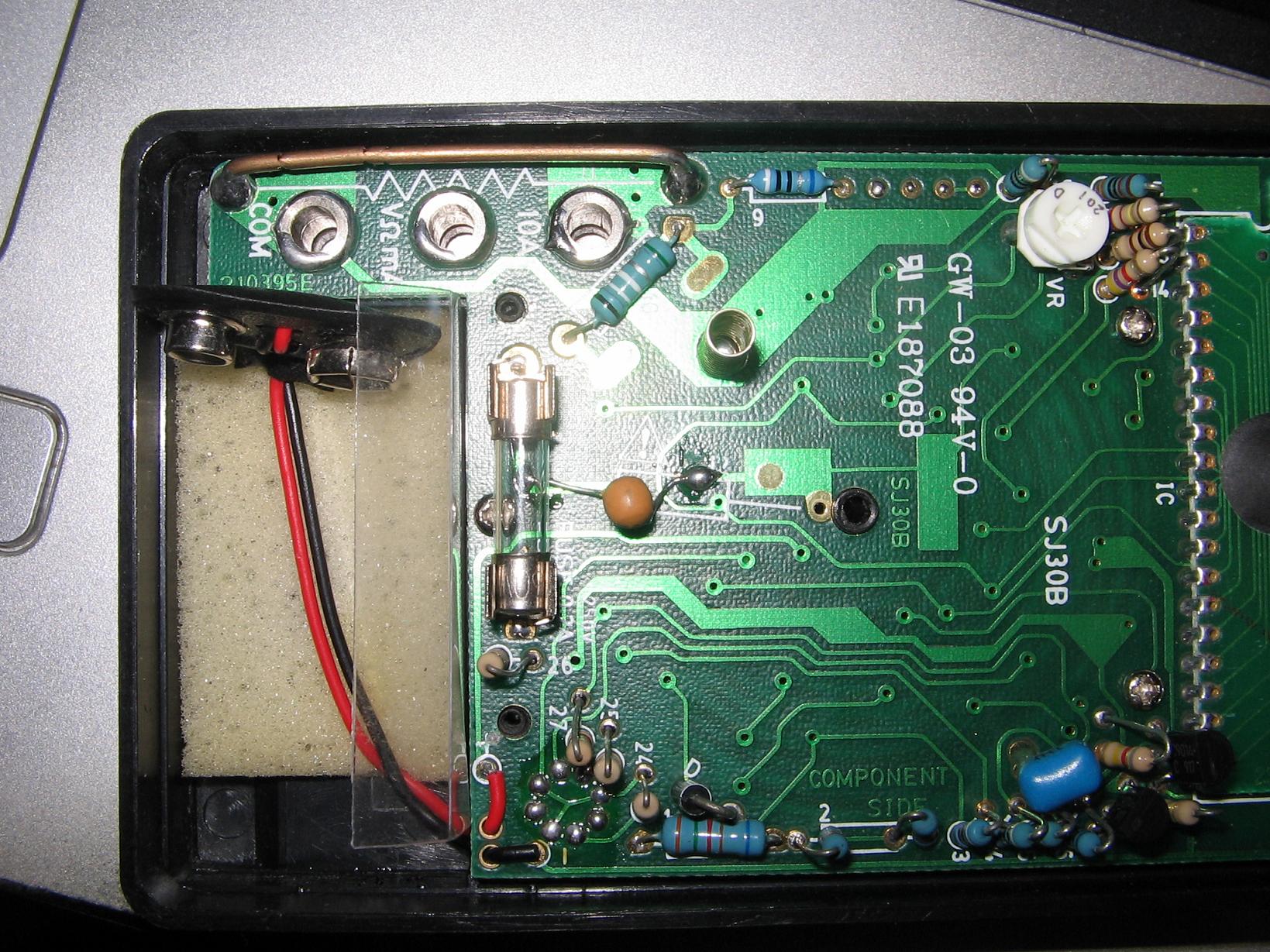

    I have recently discovered that the mA range for my multimeter doesn't work, and before you ask: Yes I have checked the fuse and the fuse is fine
    It has two settings, one for 200uA to 200mA and one for 10A (both DC)
    Connecting up a circuit which should be drawing 100mA I get a 0.10 reading on the 10A DC range which looks all OK.
    However on the 200mA range where I should get 100 I get nothing.
    It's not just the meter isn't reading the current, the current doesn't appear to be flowing at all. A simple circuit with an LED lights up on the working 10A range but on the other ranges the LED doesn't light and the display shows nothing.

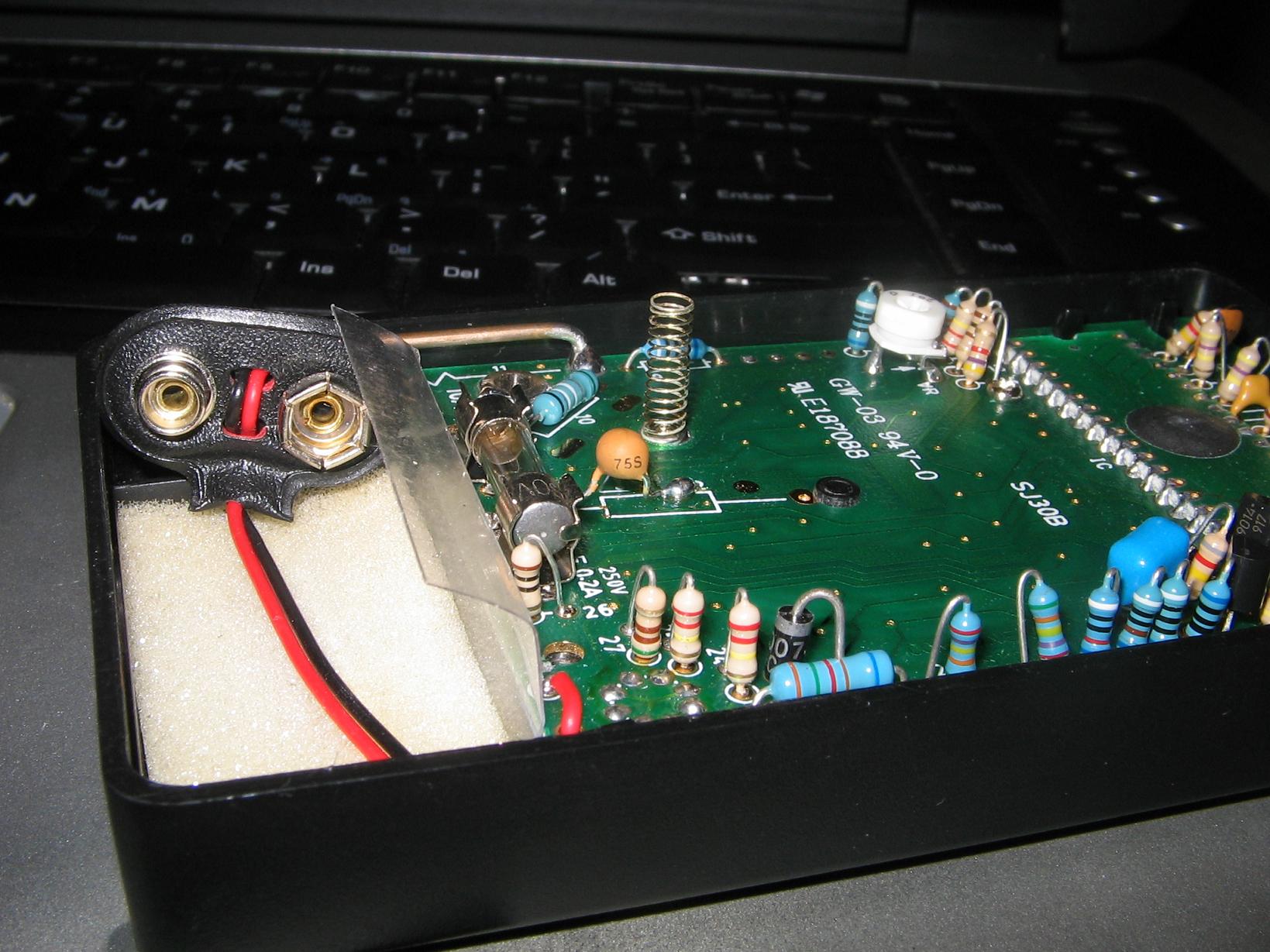

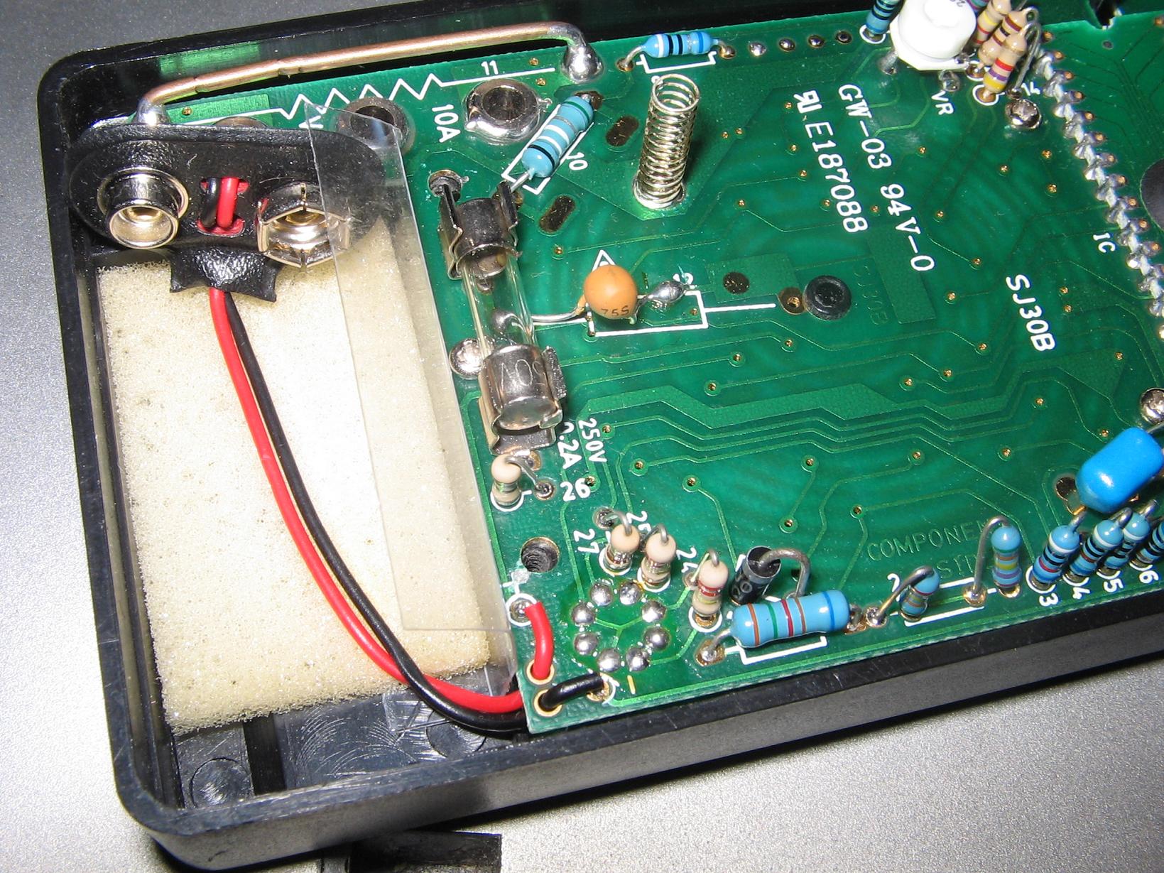

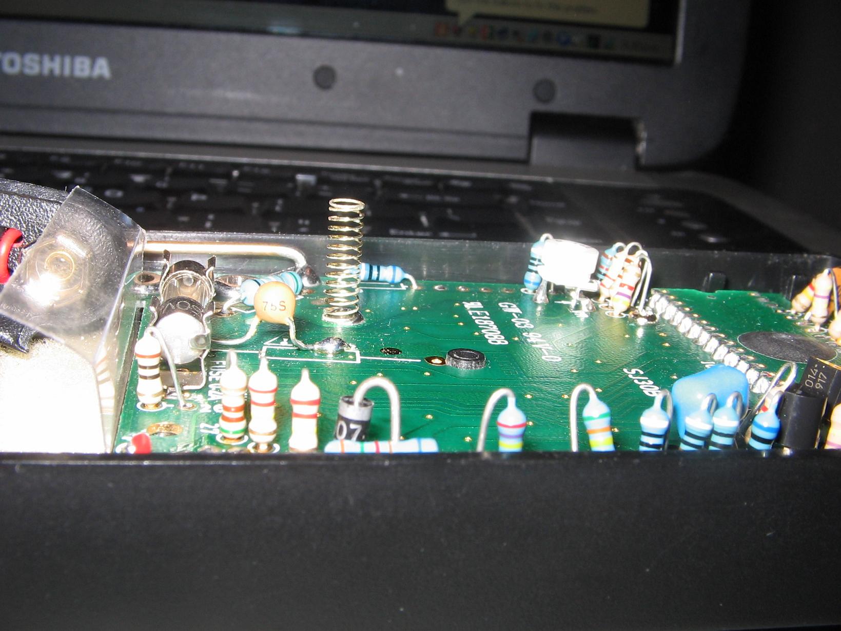

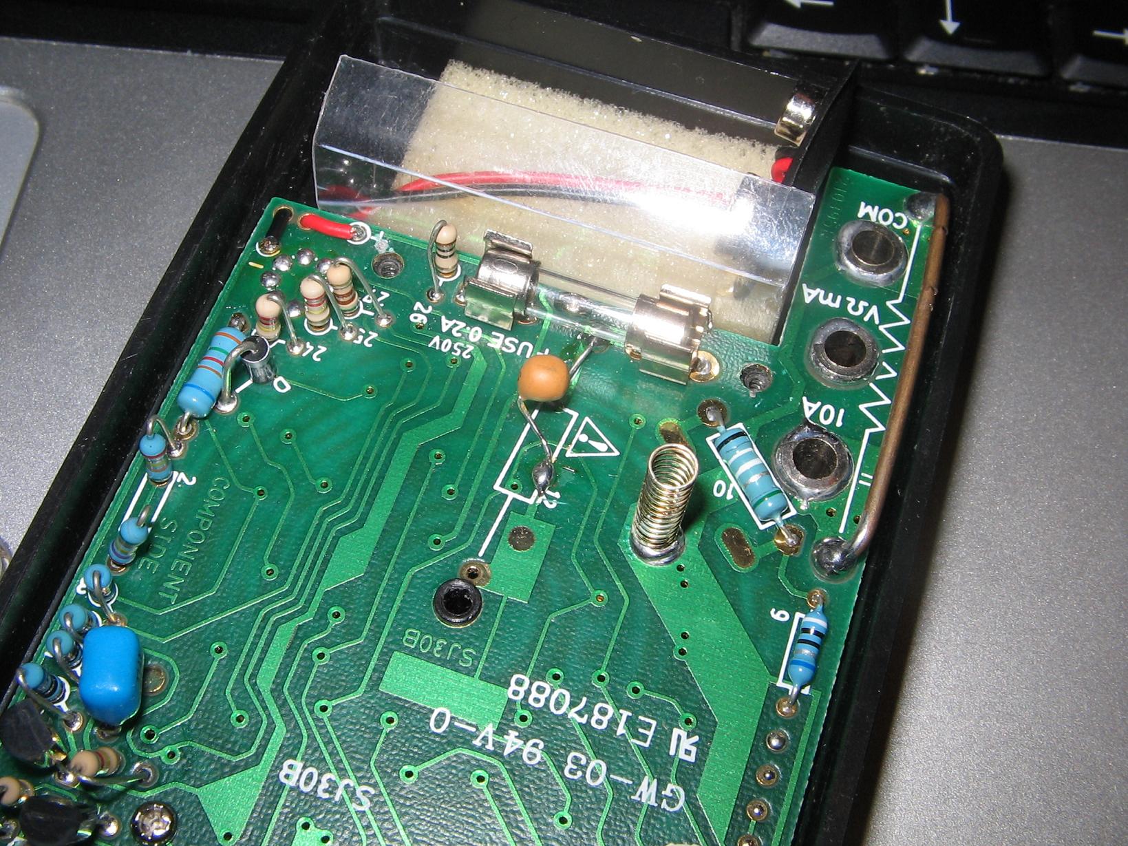

    When I opened it up I noticed a strange component I don't recognise. It's soldered where the silkscreen shows a resistor symbol but I don't think it's a resistor.
    I have attached photos... Its the thing marked "75S" which looks like a cross between a Tantalum and a Disc Ceramic

    that looks like a self-resetting polyfuse.

      Interesting, I had not thought of a polyfuse. But I thought polyfuses looked like Disc Ceramics rather than this one? Besides, the meter is quite cheap and uses a standard fuse already.
      In any case I think I have found out why the meter isn't working. When I say I 'checked the fuse' I didn't actually test it, just looked at it.
      Turns out that while the fuse wire appears intact, the fuse is actually open circuit. Maybe it broke when the meter was dropped? (happened a few times)
