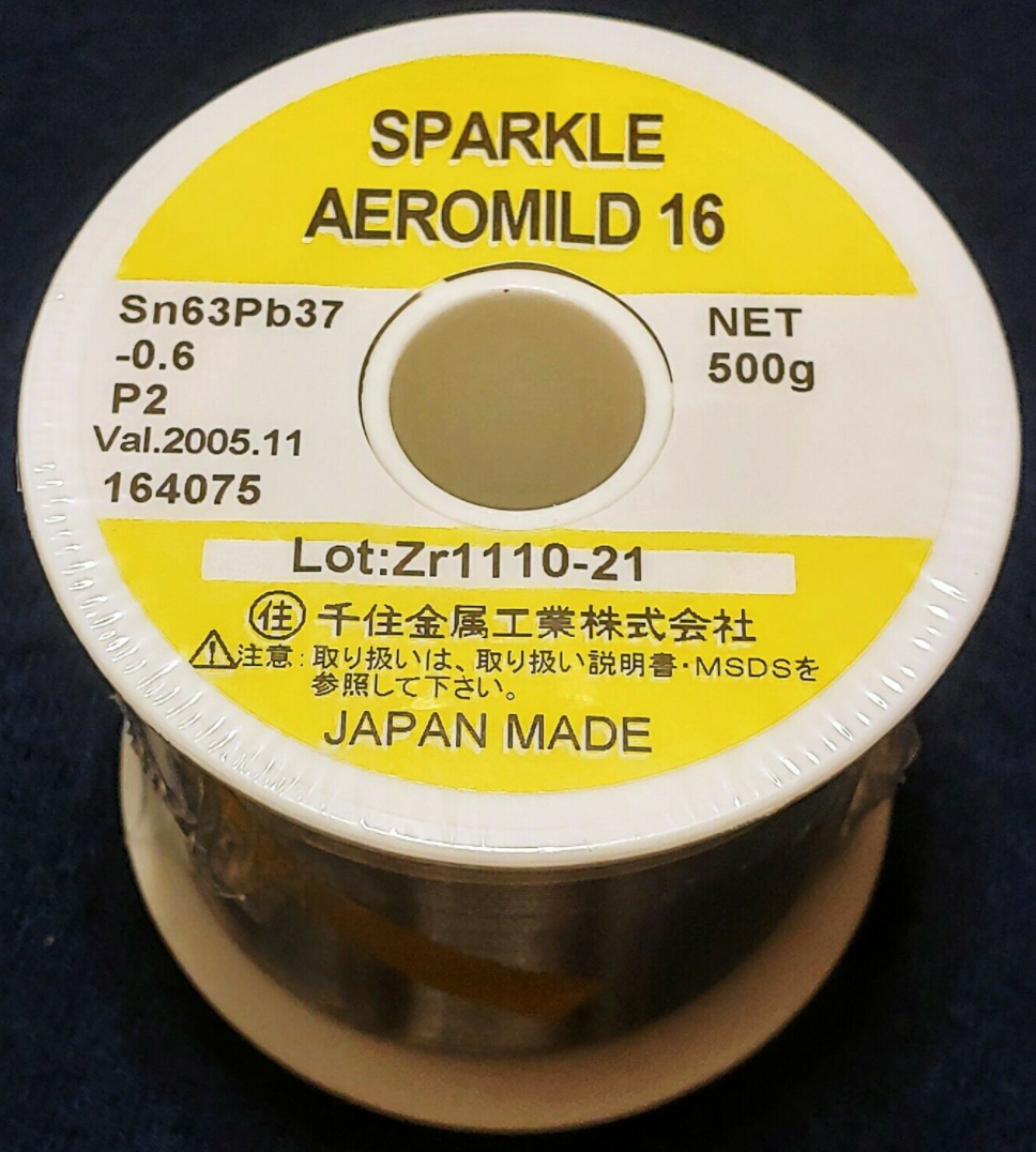

Anyone ever hear of this solder brand before?
  • jayjr1105
    • 281
    Need some .6mm solder. I gave what was left of my cheap 63/37 to a friend who needed some. Stumbled on this brand. I figured "made in Japan" it must be half decent but it doesn't give flux percentage or flux type unless you can read japanese maybe. Anyone hear of it before? As long as it has 2% flux it pretty much checks every box for me. 63/37, .6mm, 2% or more flux.

    Re: Anyone ever hear of this solder brand before?
    i hope that doesnt mean it's made in november 2005!!
    would be nice to know if the flux contains Halide.
    because Halide is good, but unhealthy to breath - so a lot of solder is Halide free,
    but you need the Halide to solder to things like brass.

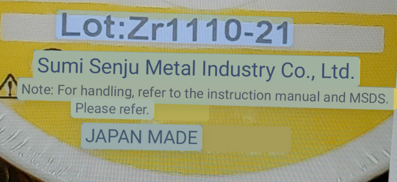

      Yeah I messaged him to ask about the flux type and he wasn't sure but said he would contact the distributor. The date code is the 21 I believe (2021)
      https://www.ebay.com/itm/254928162490
      Was able to translate it but no flux info unfortunately.

      • megaraider
        • Jul 2015
        • 307
        • Portugal
        According to the label we can only tell it contains flux type P2 > hence Rosin.
        As for percentage it's unspecified.
        It's a little worse... if "Val." stands for "valid / validity" as it should, then it was made even before 2005!

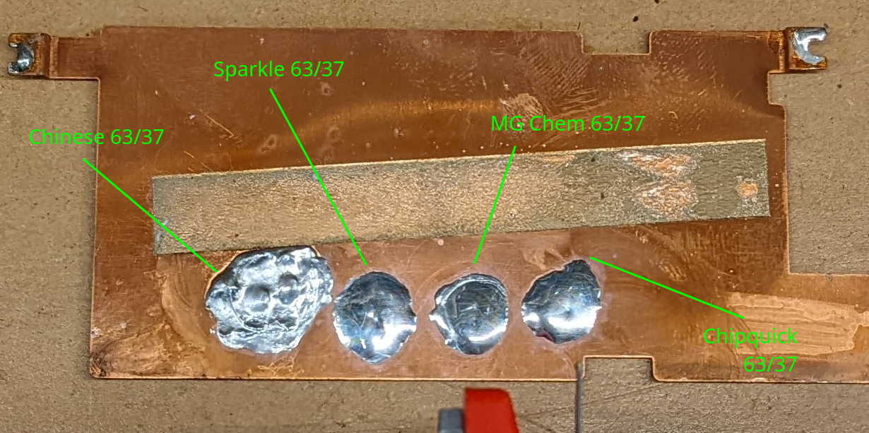

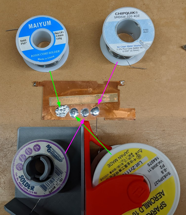

                            I took a gamble and bought this stuff and it arrived already. Wets really nicely and has adequate flux content from the residue you have to clean up afterwards. It doesn't finish quite as shiny as my MG Chemicals or Chipquick spool but it's miles better than the chinese .6mm stuff it's going to replace. It smells different than my other two as well but not sure what to make of that.

                              • 31314
                              the chinese use pure rosin usually,
                              the chipquick is water soluable flux - thats toxic just so you know and has to be cleaned off.
                              the others dont say
                              all fluxes smell different
                              • jayjr1105
                                • 281
                                the others dont say
                                According to the datasheet the Chipquick flux can be left on the board.
                                https://cdn.badcaps-static.com/pdfs/...98b4ece8e5.pdf
                                Same with the MG.
                                https://cdn.badcaps-static.com/pdfs/...f6f36653f4.pdf

                                • jayjr1105
                                  • 281
                                  Well, you live you learn. without cleanup my MG chem stuff is a clear winner. The new stuff leaves an almost burgundy crust that is really difficult to remove even with 99% alcohol.

                                    • jayjr1105
                                      • 281
                                      I should clarify. The pictures there are both uncleaned and the MG chemicals is the very shiny one.
