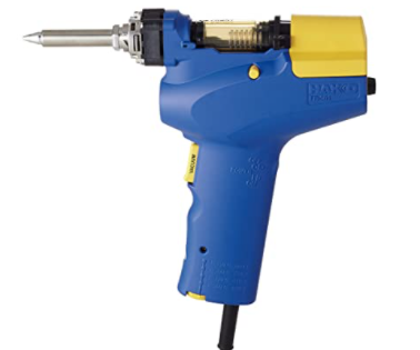

    I've been eyeing this thing up for years but could never justify the cost. I'm doing more console modding and repairs so I finally bit. I don't have it yet but wondering others opinions. I'll not be surprised to hear "you should have bought X instead". Unlike the hundreds of decent Hakko soldering iron clones, I didn't feel the chinese desoldering clones came anywhere near this unit.

    Re: Finally bit the bullet on the Hakko FR301
    It's simply great!
    I got one a while ago too, some jobs are just too easy now with it!

      Any tips? Usage or maintenance.
        It seems pretty simple, you do need to take care of the buildup of crud inside it.
        But there are tools included with that, you will notice it because the vacuum becomes much less effective...

          How about tips and filters? I thought about getting one of the larger tips in addition to the 1mm that comes with so I can do bigger ground lugs and such. Does it come with enough filters for a years worth of use or so?
            lol
            all these companies kill you on the cost of filters.
            make your own with A4 sheet material and a chinese leather punch of the correct diameter.
              There was a filter or two included I believe, whether that lasts for a year or not would depend allot on usage I'd say
              Yea I did get the 4mm x 1mm tip (N61-16) as well, that is very useful for larger contacts.
                Tips and filter are the most two consumables are used on these devices and you should have them on hand also get in the habit of using the tube cleaning rod each time you are about to turn off the unit for the day this is extremely important to do on constantly base’s or you will have to drill open the suction tube if you do not do this every time before you turn it off for the day this has to with the flux in the solder
                  one very important thing,
                  DO NOT ADD FLUX TO THE JOINTS.
                  the pump will pull it in and it will line and clog the tube and also mess up the filter.
                    They are susceptible to clogging with solder cooling down in the heating element's tube. You have to use the wire poker, especially with lead-free solders, as a habit.
                    A few times I've taken out the filter cartridge and poked in reverse, at the vacuum side to push out a broken pin that got pulled in.
                    If it doesn't work well, your technique needs to change or improve:
                    Some people hold the vacuum on for too short a time period, leaving some solder in the tube, not long enough to suck it into the filter.
                    Some people hit the vacuum too soon, before the solder joint is heated up and flowed through to the PC board's other side.
                    I've seen people wiggle the tip too much and trash the pads. Or not hold the tip flush with the board, so you get a tiny vacuum leak because it's crooked.
                    If a board has too little factory solder, not enough to really desolder then add solder to the pins first.
                    For boards with DIP IC's sometimes I put a soldering iron tip on the ICs pins on the top side of the board to melt top layer solder, with the Hakko on the other side of the board I hit the vacuum. When you need a lot of heat for the power pins.
                          as the owner of a pump-in-base type,
                          a couple of questions i'v wondered for a while.
                          1: is it heavy?
                          2: does it vibrate in your hand to a degree that would be an issue with prolonged use?
                            1: is it heavy?
                            1. surprisingly no
                            2. not really
