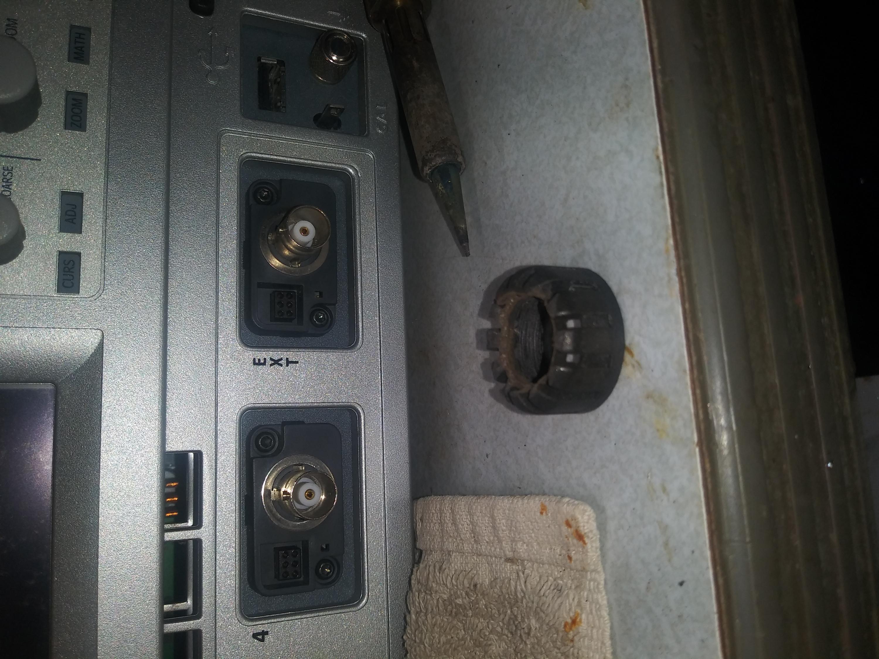

    Hi- I bought this station at a yard sale a few years ago for short money, recently the nylon knurled nut that holds down the shaft that holds the iron tip cracked, does anyone know where I can get another one? The iron itself is the SAI-690. I really like the system, but I can't find any sources for spare parts. Hate to throw it out.

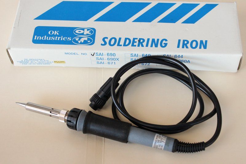

    pictures please.
    a lot of irons are clones of other irons - so pictures are handy
    SAI-690 is a METCAL part number!!!

      is it this?
      looks a bit like a xytronics iron.

        Probably print one of buy new iron (just the part that you hold), you can get these clone irons cheap on ali.

          Yes STJ- That's looks exactly like it. It does say SAI-690 and has the OK industries logo on the sticker. The black plastic nut that holds down the shaft is what is cracked. I wish I could find one.

            If you can't find the part, make a ring out of metal (thin copper or tin) that will fit around the ring to hold it together.

              I'll try and Mcgyver something. Maybe the high temp JB Weld. Nothing to lose at this point. Just hate to throw it away. Thanks for listening everybody!

                Stalked EBAY for a couple months, found a brand new replacement "OK" iron from a great e-bayer for $18 delivered!! My station lives again!!

                  As for the old iron handle, I do have a few suggestions, if you want to fix the old one as a "backup".
                  For starters, see if the plastic on the cracked nut reacts to PVC glue (the type used for gluing sewer / wastewater pipes) or ABS glue. If you apply a small dab to the surface, wait approximately a minute and then smudge it around and see the plastic becoming melted / dissolved into the glue, then break the nut and re-glue with PVC/ABS glue back together. Depending on the plastic (typically ABS, PVC, PS, and sometimes PC), it may bond back together just as strong as it was originally.
                  But if the above doesn't work, you can try applying rubber cement / contact cement glue around the whole ring, and then wrap with a layer or two of some hard material (or several layers of paper and contact cement might do too.) Contact cement glue is flexible (looks like orange/brown bubble gum when dry) and can't hold two objects together in a rigid manner over a small surface area. But when backed up with another material for strength and rigidity, it can. And the good thing about contact cement is that it has overall good resistance to temperature.
