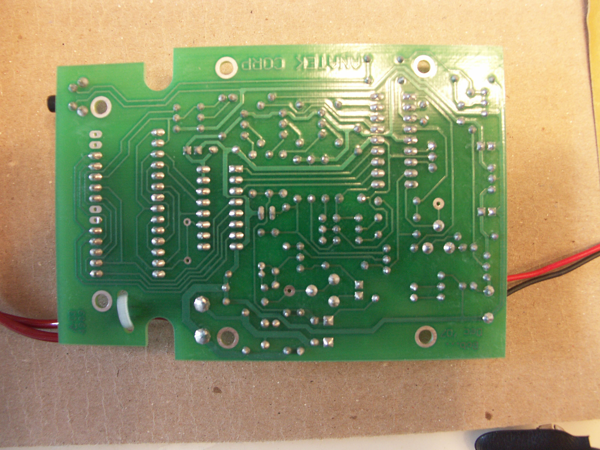

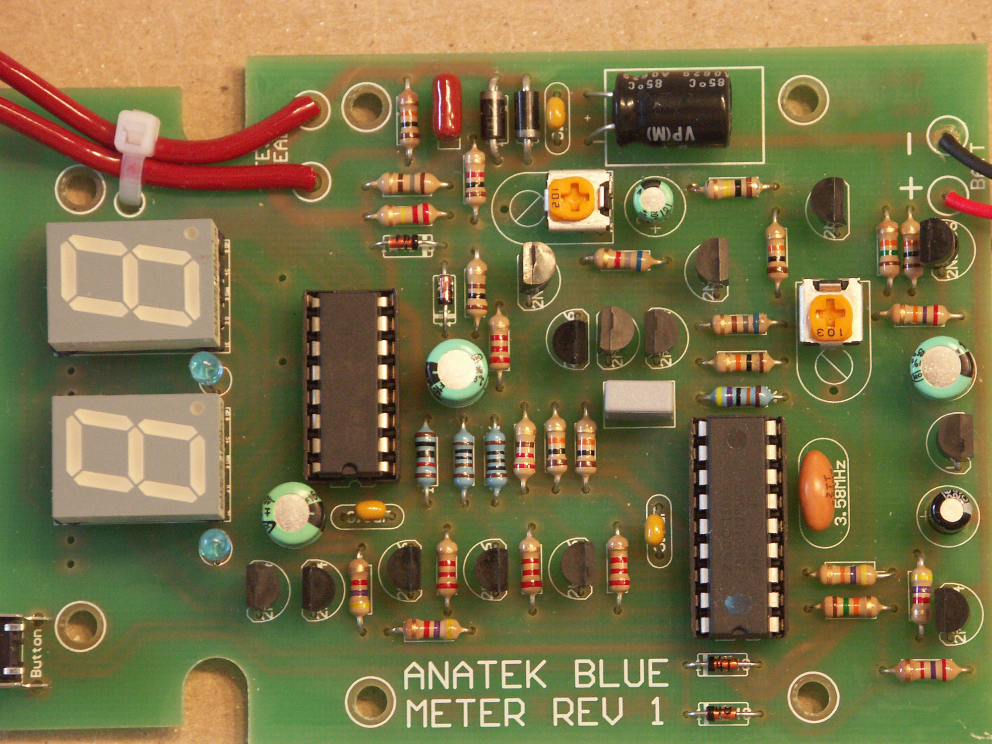

    Hey everyone,
    I have been trying to figure out this error. I have not been able to calibrate the unit, not getting anything from the test resistors. Running the self diagnostics give me the F6 error code. I have at this time de-soldered the components checked the resistors, and verified that everything has been put into place. Re-soldered the components listed under the F6 code. Maybe everyone here might be able to stop a misplaced component or point me to test some thing.
    I have followed the leads on the board and tested with an ohm meter to see if there are any breaks, but non found. I have pictures located on my web site, you can view them here http://www.comshyft.com/ESRMeter/ . The I have the photos split up into two folders for the front and back side of the board.
    I am just stuck at this point and I am trying to avoid the expense of sending it into Anatek. I was working with their tech support, who was stuck on solder whiskers or a bridged lead. After I posted the pictures and sent them a link they jumped to it can be troubleshooted. I figured I would check here with you guys and see what options I may have.
    Thank you in advance.

      I have both of the POTs in their correct location. The 201 (middle right hand side) and the 103 (middle bottom side), both are in their center position. You should be able to see it in this picture http://www.comshyft.com/ESRMeter/fro...d/PICT0164.JPG.

        You have R13 & R30 transposed.
        R13 (100k) = brown black yellow
        R30 (100R) = brown black brown

          Thank you Radio Fox. I switched those resistors, great find, the unit now tests fine with ".8.8". Calibrated now and all is working. Thank you again.

            Resistor problem yet again as I suspected .
            If you have difficulty determining the color bands measure the resistor with a DMM to verify before installation.

                  The pictures are still on my site. I can upload to the form if you would like. Oh, the reason for the picture not linking correctly is the security I enabled in CPANEL to prevent bandwidth theft. If you go http://www.comshyft.com/ESRMeter/ you should be able to view all the files I uploaded I don't plan on taking them down anytime soon.
                  Front side of board: http://www.comshyft.com/ESRMeter/fro...%20of%20board/
                  Back side of board: http://www.comshyft.com/ESRMeter/bac...%20of%20board/

                    Missed the time I could edit the previous post. Here are two main photos of the back and front so they can live here. Images were reduced to fit image size, and file size limits.
