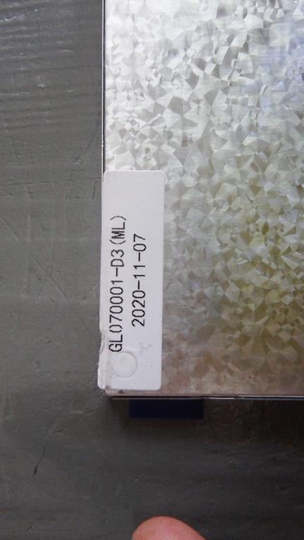

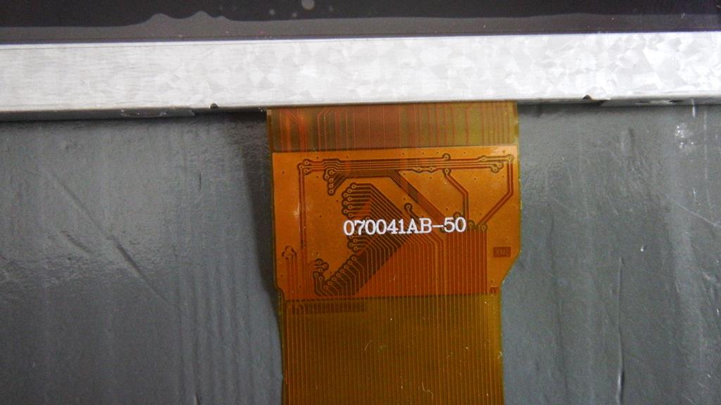

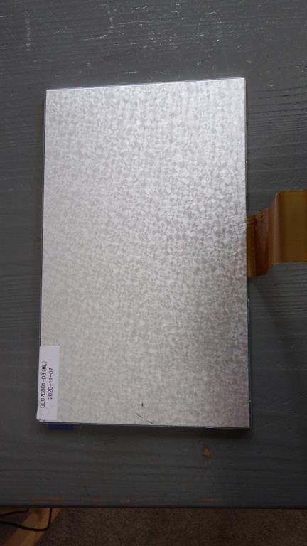

    I have broke the LCD on my microscope and cannot find a replacement for it.
    Model # DM9
    LCD screen: GL070001-D3(ML) 2020-11-07
    On the ribbon: 070041AB-50
    Can anybody help me to locate this screen I have been trying for awhile now without any luck.

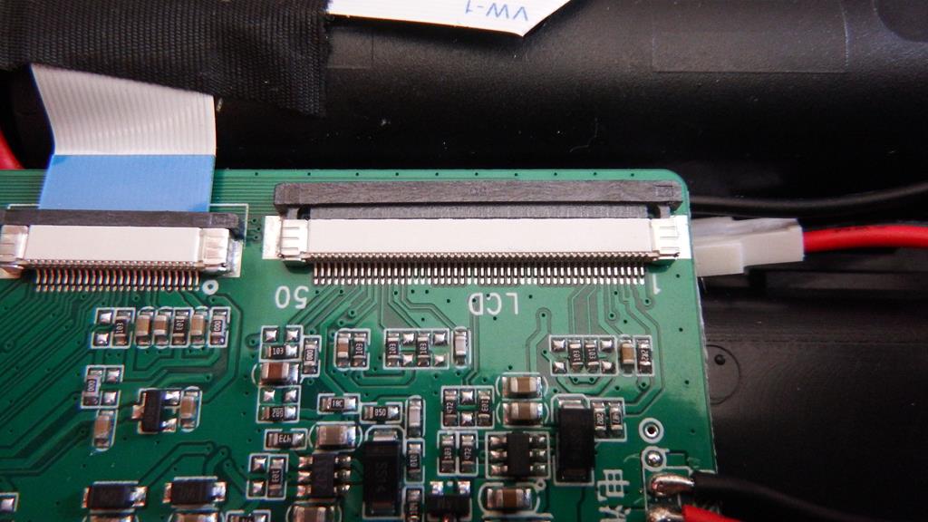

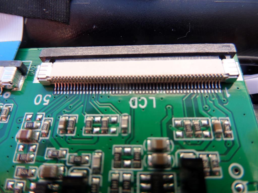

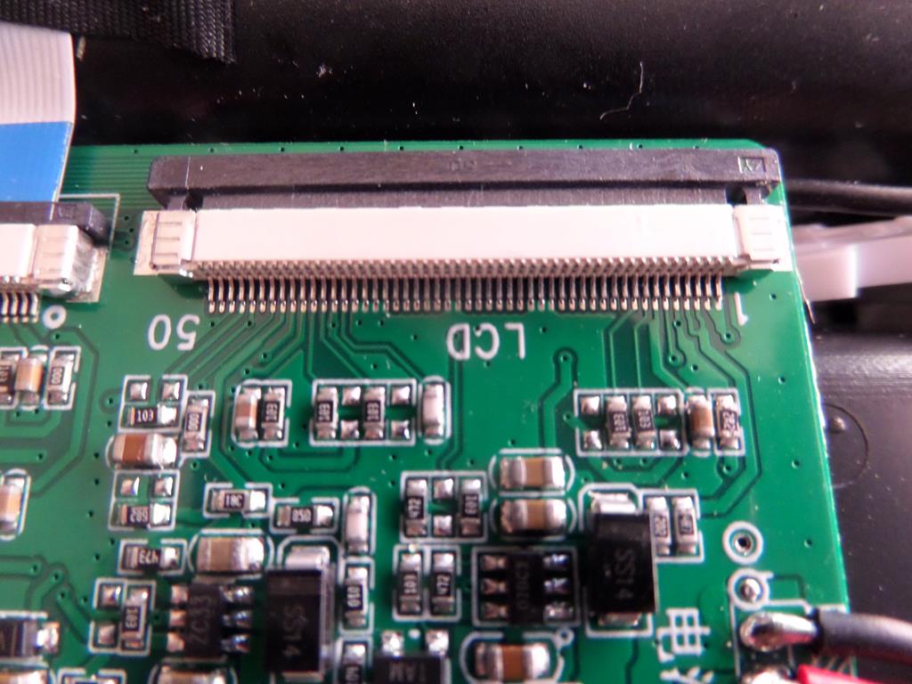

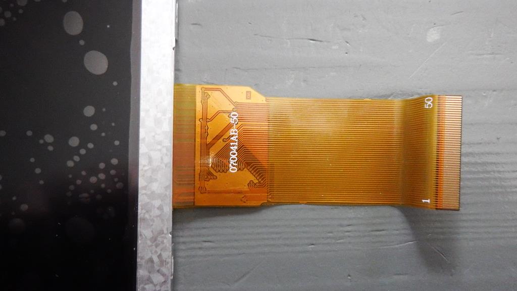

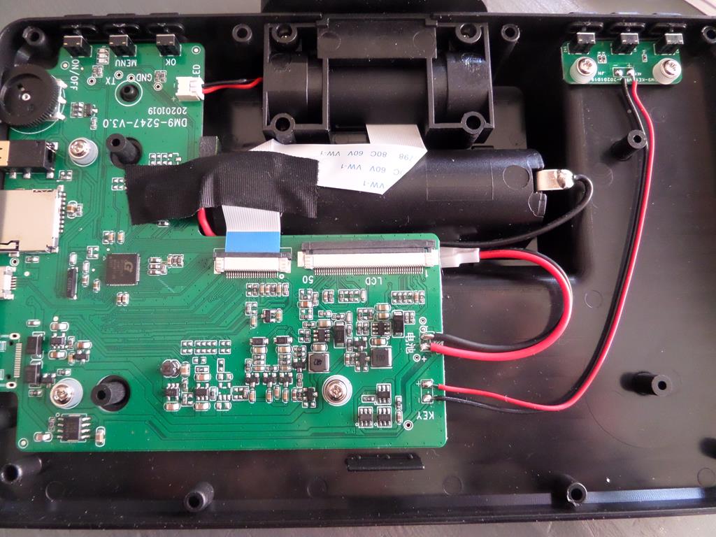

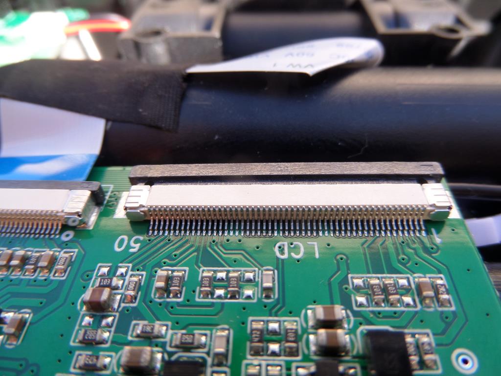

          I do know it is 50pin and thickness, but not all are used entering the screen. That where the problem is I think with the screen I got from AliExpress.
          Here are some pics from the board that should make more sense I hope

            Re: 7inch Digital Microscope DM9
            Well, the one you are looking for matches the number.
            https://aliexpress.ru/item/400115395...00014915095670
            Or did you have a different one?
            And your display broke, how to understand, it crashed or simply stopped showing (the backlight is on, but there is no image or just a black screen?
              Well that is exactly the one I have got and it is from the same seller as well. If you look in his customer reviews you can see for your self it is me and my photos posted of the original screen what is broken and I need. Well he promised to look for me too, but I do not hold my hopes up, because I did give him 5 stars already and not open a case. Maybe he did send me a wrong or faulty one.
              The one I got there is no sticker on the ribbon at all, but the ribbon looks close enough.
              There are no close up off his photos as well and that does not help either.

                                Only thing I did send him Motherboard number:
                                DM9-5247-V3.0 20201019.

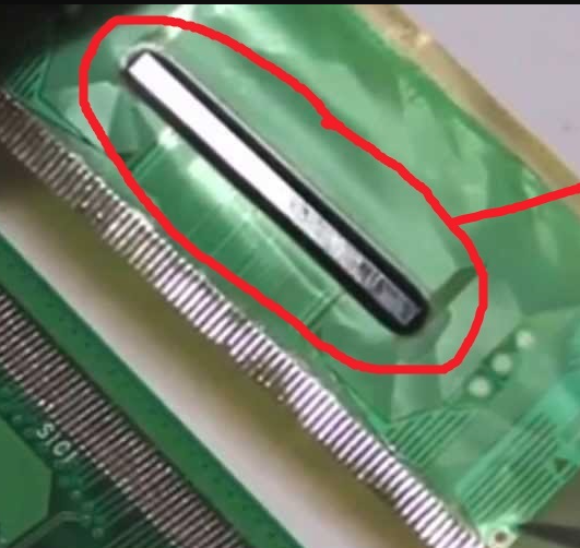

                                  I have an update from a E bay seller follow with a question. This is his replay:
                                  Dear Sir.
                                  You need to replace the part as shown in the picture. Once it is installed, I will send you the new program and you should be able to use it normally after reinstalling the program.(A new program must be installed to use it. So please don't turn on first after you replace the screen)
                                  I calculated the cost of the parts and shipping, and the total cost is 25 USD.
                                  If you need it, you can buy it through this link.
                                  https://www.ebay.com/itm/275500765127
                                  Why this screen would work and why do I have to update the program which I guess would be a firmware?
