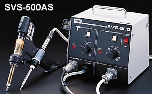

      how bout the svs-500as. damn it looks good and at $680 it should

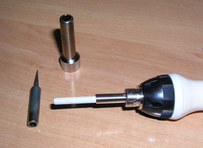

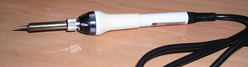

                  here's some Goot pics to confuse you even more. thats just a low cost CXR-30 22w. Nice exposed ceramic heater. Very easy to change tips and secure them properly. doesnt look like a weller lol. (before anybody reading this goes and buys this same one, it is for very delicate work and does not have enough heat at all for recapping)
                  any where you post you will have more recommendations for the hakko cos the distribution is better, especially in the states where they have a big operation.
                  i think you will have no complaints with either unit. if you are doing a lot of repairs for your shop cant you get the shop to get you a soldering/desoldering station?

                    Does the Hakko have similar hollow tips? Goot market this feature claiming improved heat transfer and recovery time.

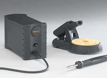

                      i will add also the Metcal PS-800 to the mix for a complete roundup, in case anybody else is checking the thread.
                      http://www.okinternational.com/product_soldering/ps_800
                      these are going for $223 at farnell. previously i thought metcal was too expensive but this is a newer cheap model. can actually remove the tips easily while the iron is on.
                      and you need to as well cos it has no temperature control, the tip cartridge is rated for the temperature you want and then the station adjusts the power to the tip to maintain the temperature while you are soldering. strange indeed.
                      update : Metcal is now OK International

                        Found it in OZ but not from Farnell.
                        http://www.okay.com.au/catalog/index.php
                        Metcal PS800 @ A$429+?
                        and SP200 @ A$350+GST.
                        Both have the short barrel iron which would be just great to manipulate.
