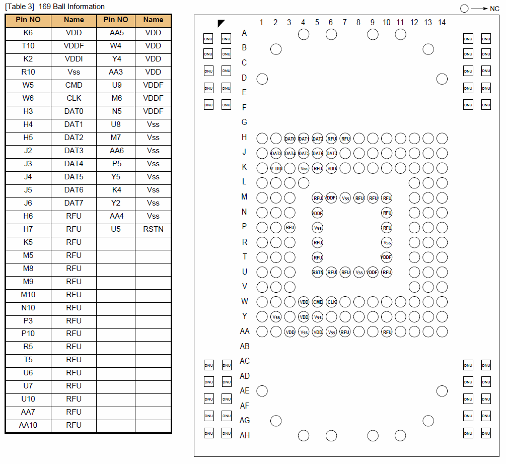

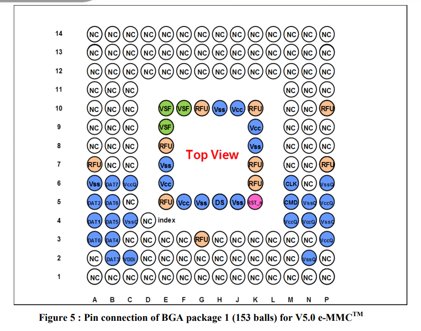

                            It’s easy to find some nice pictures for an eMMC153/169-SD Adapter FBGA153 BGA169 to a SD Adapter (e.g.: link)

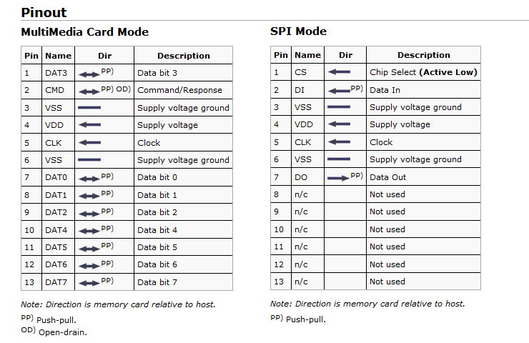

                            To make things even easier you can hook wires from the circuit board to an empty SD card, see images attached.
                            [Connect VCC and VCCQ to the correct voltage levels]
                            Notes:
                            1. In 1 bit mode & SPI mode -» pin 1 (DAT3/CS) is not used.
                            2. Since SD readers operate at 3.3V, if VCCQ is tied up in circuit to 1.8V then use a low voltage adapter to convert 3.3v signals into 1.8v logic level.
                            3. Most often the CPU may attempt to communicate with the eMMC while your’re reading / writing it. Here’s where the JTAG port comes handy to quickly identify the RST line and hold the CPU it in reset mode.
