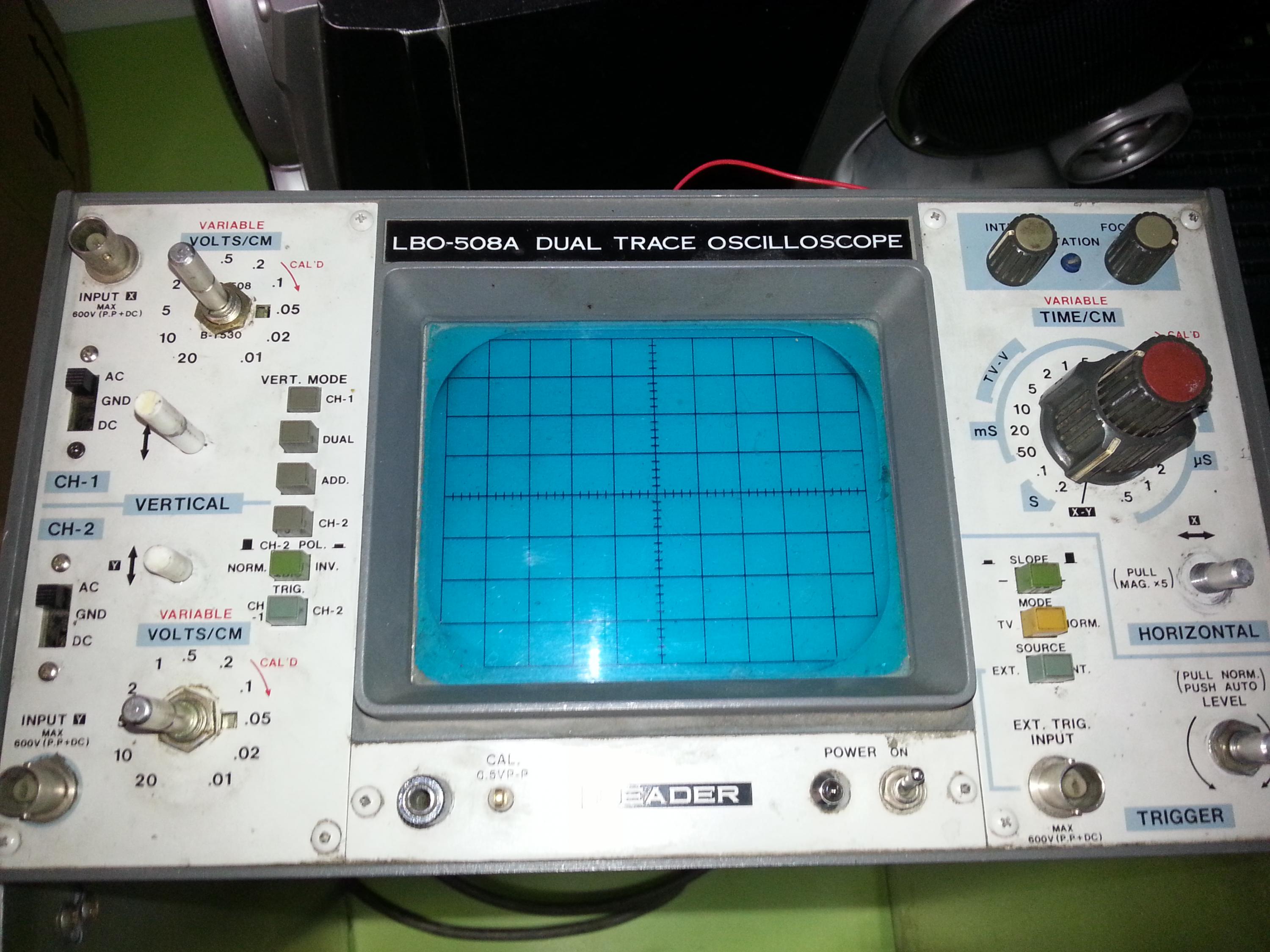

                                    Ok guys, it's been nearly a year now since we've had this discussion, so here's a little follow-up:
                                    Still haven't got a scope. Not because money would be an immediate obstacle (I could certainly dish out for a pro one at that), but because it wouldn't pay for itself, so I figured it's a better idea to just wait until I could get some actual use out of it, instead of just fantasizing how it would be to have a scope.
                                    However, in the meantime, check out this thing I found in the junk pile at work: Leader LBO-508A...What you see is what you get: it's pretty beat up, the case is not on properly, dials and buttons have flown off...all sorts of nasties. Amazingly, the screen seems to be intact (at the front at least), since I'm not sure if the tube inside is still OK.
                                    The ultimate question is: does it work ? Don't know: haven't plugged it in, since it's pretty messed up on the inside as well. Some traces broke off from what the chap who took it apart before me told me, but haven't had a look myself yet.
                                    Did some searches and it turns out it's only 20Mhz which is rather meh, but hey: free scope...can't argue with that. Trouble is: should I bother to even crack the case open, or just toss it back in the corner where I found it ?

                                      looks good for a free scope - get in it and see if it's all there.

                                        Can't do that just yet thanks to my "shop master 3000" who won't let me touch anything around here (wrote a whole rant about that in another thread), so I'll just let it sit there for now...sorry Santa, but I hope it's not long until the old geezer kicks so I can get some peace and quiet...that's one heck of a wish from someone who is usually peaceful, shy and tolerant AF...
