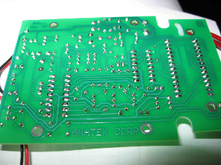

                            • Bob Parker
                              Technician
                              • Feb 2007
                              • 182
                              #34
                              Re: ESR meters and the Bob Parker unit revisited
                              It should be made illegal to use uncontrolled temperature soldering irons on circuit boards. Or to operate temperature-controlled ones at temperatures far above or below what's appropriate.
                              Building the ESR meter isn't rocket science and it's not hard. As boards go, it's quite a simple one. Just get in there with a reasonably small controlled iron at about 340 degrees C, double check the position and orientation of the components including measuring the 1% resistors with a meter to confirm their value, and solder them in place with appropriate electronics grade solder.
                              Clip off the component wires after soldering (not before because the mechanical shock can damage some parts). Always lift the iron tip vertically away from the joint; don't 'wipe' it sideways because that makes solder whiskers which cause many problems. Pay attention that you're not accidently bridging separate solder pads with molten solder. Make sure you've earthed yourself before handling the static-sensitive displays, LEDs and ICs.
                              When you've finished, examine the copper side of the board with a magnifier and fix any joints that aren't perfect. If you've been half-way careful, it will work first time.
                              If after calibration the meter can read the 5.6 ohn and 82 ohm test resistors reasonably accurately and zero out the test lead resistance, there's nothing wrong and you can start checking all those suspect electrolytic caps you've been saving for this moment.
                              Don't try out the self-diagnostic function unless you really need to. And don't use a 9V battery with the diagnostic function because it will report an 'F2' fault which probably doesn't exist. It must be powered by 6.5V to work properly.
                              Good luck.

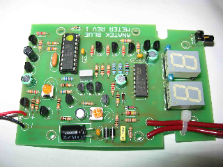

                                  • KeriJane
                                    Mac Enthusiast
                                    • Sep 2008
                                    • 681
                                    #37
                                    Yay!
                                    I got the Blue ESR kit today.
                                    I put it together, tested it and calibrated it all in one night.
                                    It seems to work ok, right from the start.
                                    It seems that I only got one IC socket, so that's all I used.
                                    Testing a few of the OST caps I recently pulled out of a Shuttle revealed a reading of .02 on most of them. I think that's probably ok, isn't it?
                                    A blowed-up Fuhjyyu read "- " Surprise!
                                    Have a look at my clumsy amateur soldering.... though a bit crude, there aren't any bridges and not much flux residue. (really thin rosin core electronic solder was used)
                                    Not having a handy variable power supply, the low battery warning was set to 6v supplied by two 2032 CMOS batteries instead of the recommended 5.5v.
                                    The instructions are pretty good, but kind of skipped over some of the details.... I suppose that's ok as anyone building one of these things probably doesn't need all the details. The thing that almost tripped me up was the part where it said "(Do not install the integrated circuits until after performing the Initial Checks.)"...umm.... the "Initial Checks" section appears to be a power on test with the system fully together!
                                    Another thing that almost fouled me up was that the board positions for the electrolytic caps are marked with a small "+" ... almost mistook that for a dot indicating negative. But I didn't.
                                    It's a nice kit. Thank you, Bob Parker.
                                    Have Fun,
                                    Keri
                                    The More You Learn The Less You Know!
                                    • Huckfinn
                                      • Jan 2009
                                      • 43
                                      #38
                                      KeriJane:
                                      The initial checks are indeed done with the unit assembled but without installing IC 2 and IC3. Once the initial checks come up as OK, the Zilog micro and the digital display driver IC are then installed and further items are checked. The reason for this order is that in case the kit builder makes a significant mistake, IC 2 & 3 will not get wiped out. The idea here is that if the initial checks fail, the kit builder will hunt down the problem so that the initial checks will pass, and IC 2 & 3 will be spared from damage.
                                      A technique you can use to fine tune your low battery level adjustment is to use the two 3 volt lithium cells like you did, but add a regular plain silicon diode in series with your 6 volt source. A 1N4001 or equivalent will do. [ 1N4002 through 1N4007 etc... will also work just fine]. Connect the anode end to the plus side of your battery stack, and use the cathode end of the diode [the end marked with the paint band ] as your plus feed to the meter. The diode is biased on in this mode and will drop very close to a half of a volt across it, giving you a power source doggone close to 5.5 volts [and of course the negative end of the battery stack you connect as you did before]. The six volt supply [with a series diode to bring it to 5.5] can also be done with a four cell penlight battery holder with batteries.
                                      Congrats on assembling the meter successfully!
                                      Huck
                                      • Huckfinn
                                        • Jan 2009
                                        • 43
                                        #39
                                        Blue ESR meter kit builders:
                                        As an additional thought triggered by KeriJane's comment about probably not needing to consider all of the stuff in the assembly manual, I would have to say that in the case of this Blue meter, no superfluous stuff was included, so I advise heeding all of the instructions.
                                        Huck
