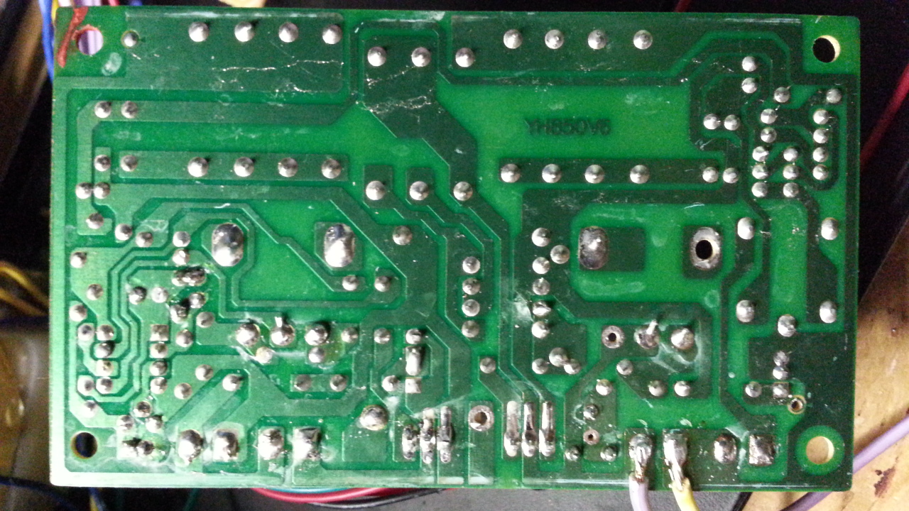

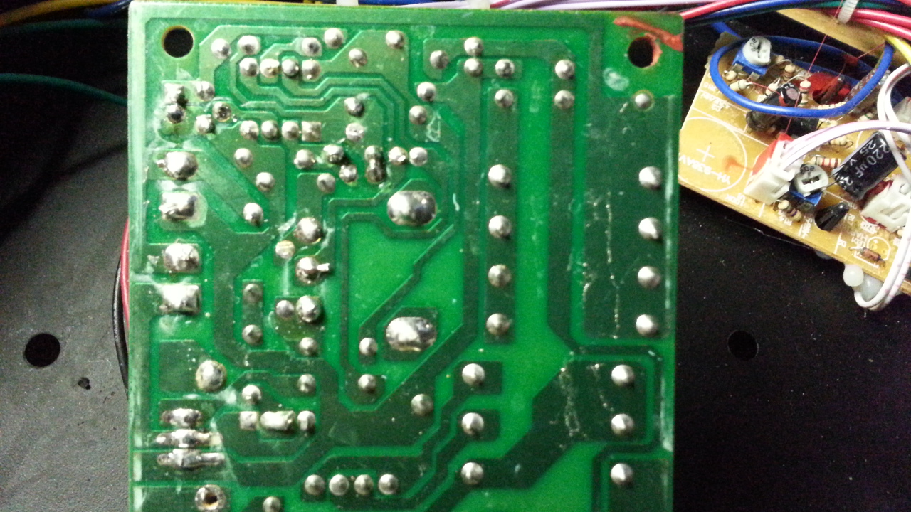

            #65
            Re: Rework Station Pump - Can They Be Repaired ?
            Here are some pics of the control board. It has two bt137 triacs and an lm358 on it as well as a/c input from the mains. Can anyone infer from the pics how this works ? And is it safe to put a scope on the two wires driving the magnetic coils ?
              • 31198
              #66
              so which pair of wires goes to the pump?
              • mmartell
                • Oct 2013
                • 3189
                #67
                The two soldered to the back of the board in pic 4 and pic 5.
                  • 31198
                  #68
                  resolder the power transistor or whatever it is,
                  the center pin looks strange in the foto's
                  • mmartell
                    • Oct 2013
                    • 3189
                    #69
                    Resoldered the two triacs, the lm358 and several dubious joints. Reassembled the pump unit minus the back plate so I could see the movement of the piston.
                    Fired it up and no change.
                    The frequency was measured at 60hz. The a/c voltage changes with the air speed knob but the frequency remains at 60hz.
                    I noticed now that the wand no longer heats up, don't know how long it's been like that or if it's a related problem yet.
                    Feel like I'm chasing my tail with this one.

                                    #77
                                    Used a short stack of 9v batteries to drive the piston in both directions so the pump itself is fine.
                                    The driver board itself consists of two BT137 triacs, an op amp, a couple of caps and several diodes and resistors including eleven high wattage ones.
                                    Earlier I measured the ac voltage to be variable (60-120v) at 60hz. There is no way this piston can oscillate that fast so there must be a breakdown of the circuit feeding it.
                                    Can anyone explain how they think the ac wave is constructed to drive the pump ? By what means can this circuit change a 120v 60hz voltage to say 120v at 5hz ?
