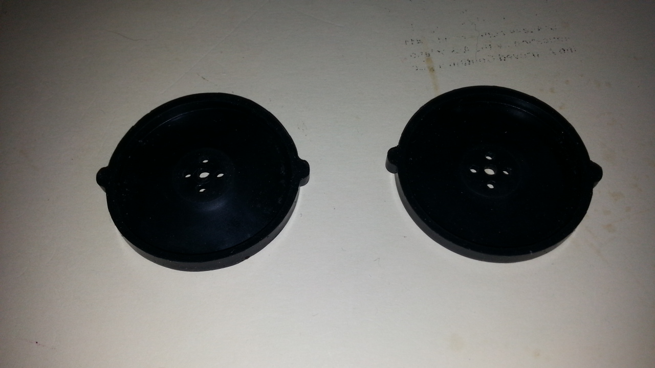

                  Re: Rework Station Pump - Can They Be Repaired ?
                  Removed the diaphragms and the bottom plate. The piston vibrates but does not move back and forth like it should. I can't yet tell if there is a track it should move in or moves just by magnetics ?
                  It seems like the diaphragms are weak, not torn in any way but too pliable. If these are meant to keep the piston in place then they are too weak as I can easily move the piston up and down with light pressure.
                  Any thoughts ?

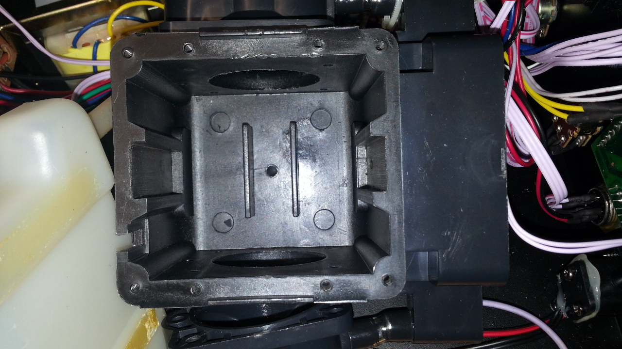

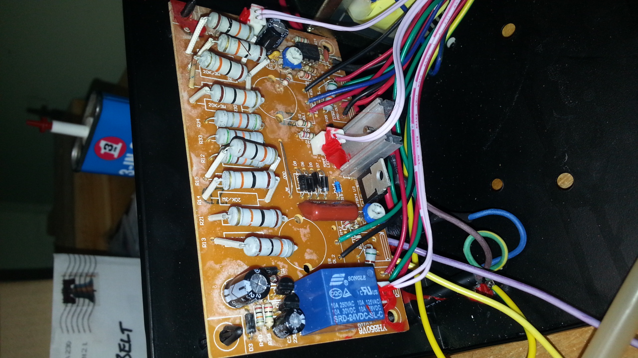

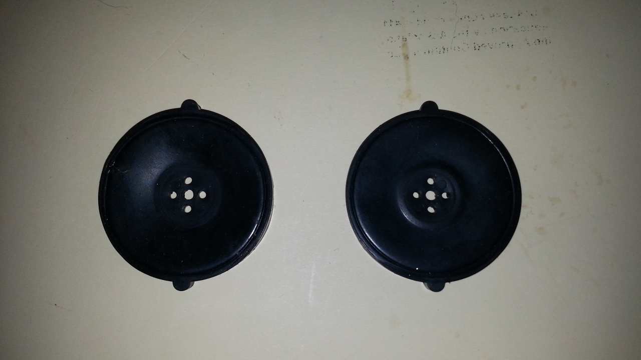

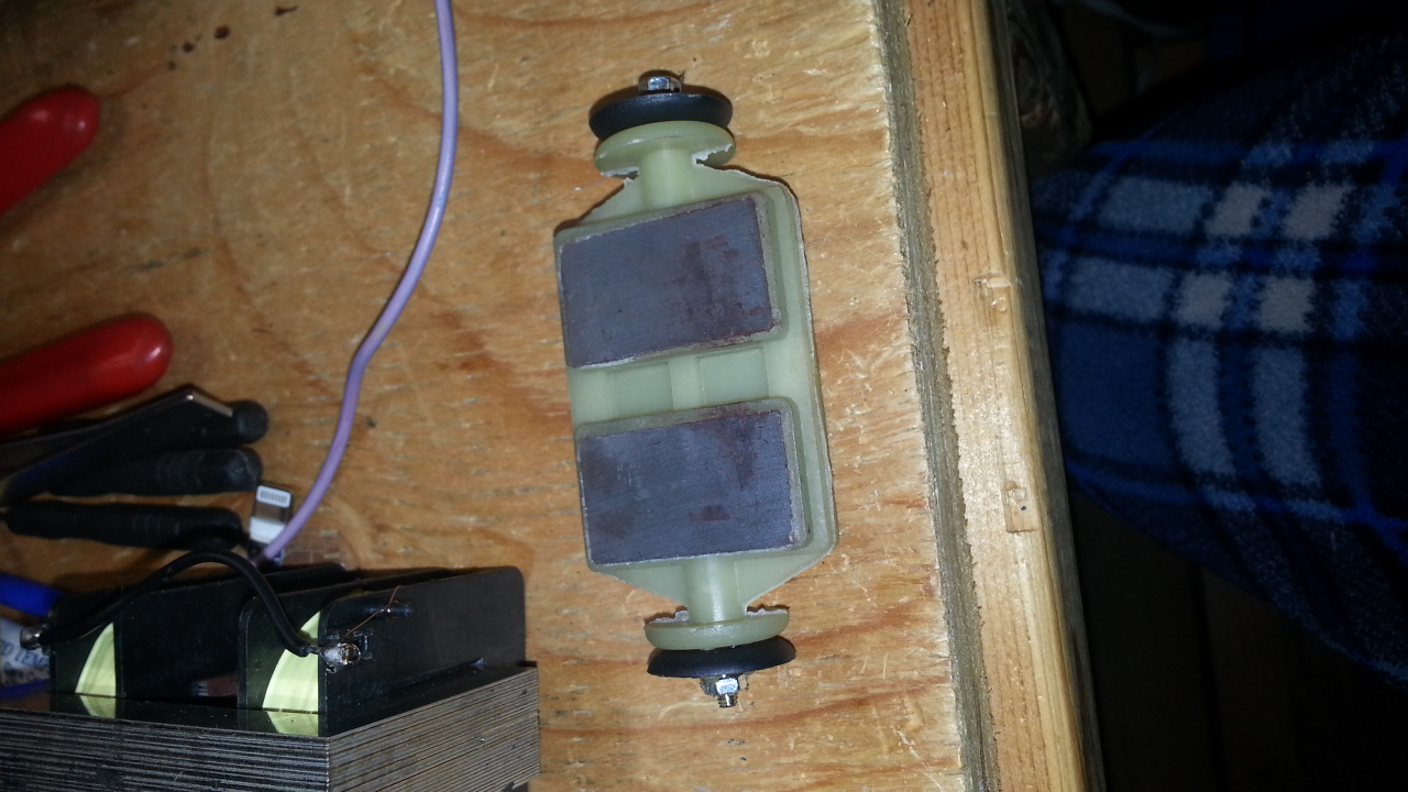

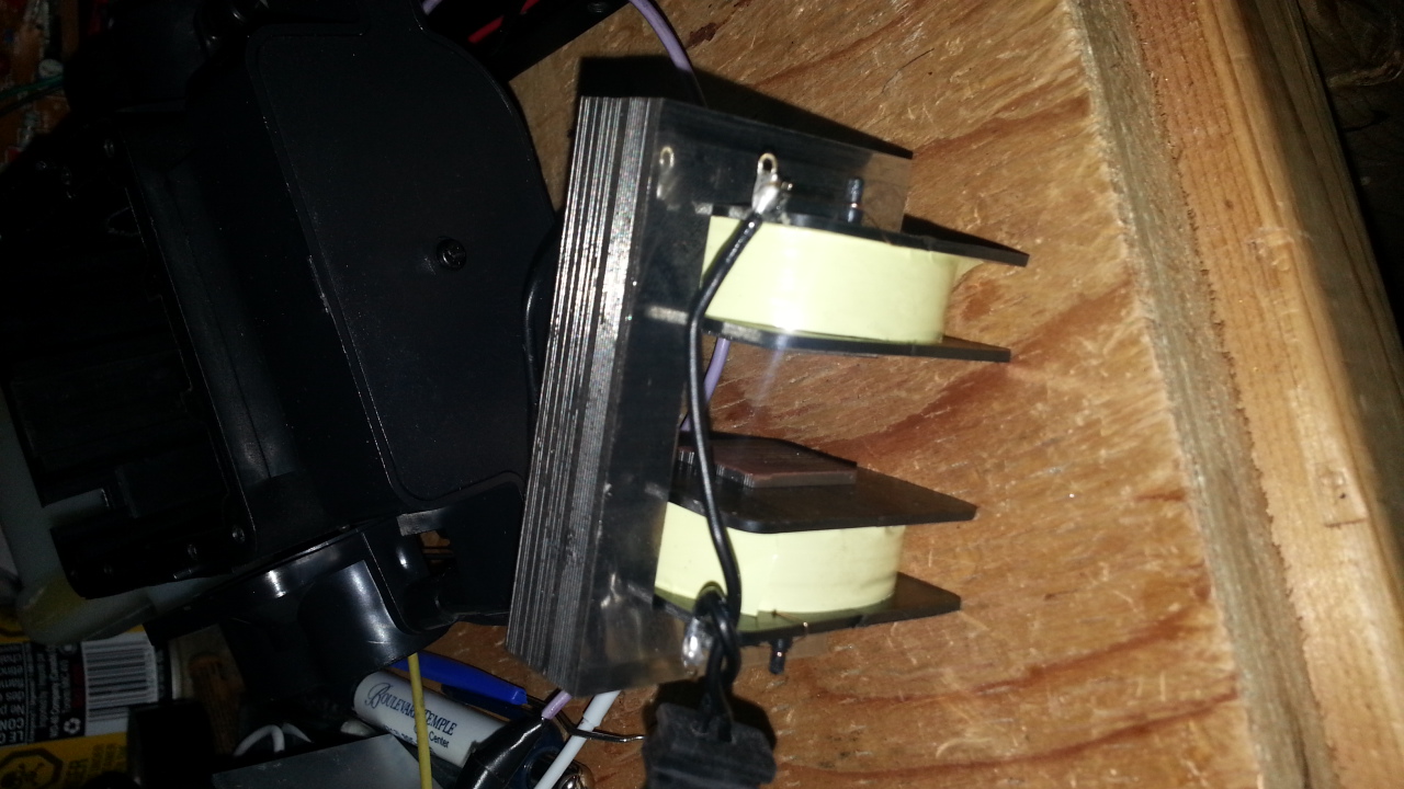

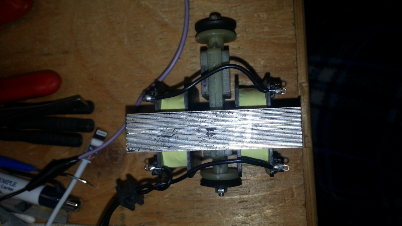

                          Some pics... they've all been rotated, yay.
                          The first pic shows the core with dual coils wired in series. Both coils ohm out to about 146ohm so I think they're good ??
                          The second shows the "piston" with dual magnets.
                          The third shows the piston inserted between the coils.
                          The fourth is the housing that the assembly slides down into.
                          The fifth is the control board.
                          There is no "track" or discernible way for the piston to be kept in place. In pic 3 the magnets are easily drawn to the core so when the whole unit is assembled they remain bound to each other such that no movement is possible whether power is applied to the coils or not. This is what makes me think the diaphragms (damn, pic coming!) should be stiff enough that when assembled they keep the piston BETWEEN the coils.
                          I'm sure someone here knows the precise theory of operation here so help me out. Are the diaphragms to blame or something else ?

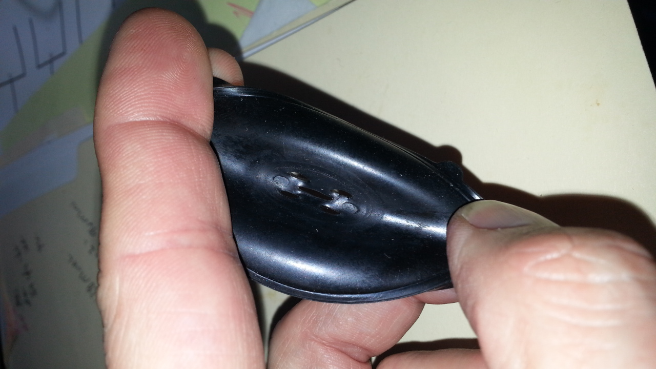

                          • mmartell
                            • Oct 2013
                            • 3189
                            Diaphragms. You can see in the third pic how easy it is to distort them with one hand.
                              Strange looking motor, for sure, I've never seen one like that. How are/were the diaphragms attached to the spindle? Just a guess, maybe each diaphrapm was ultrasonically or chemically welded to the black piece on each end, which made them stiff enough to keep things in place.
                              Looks like some kind of deposit on the control board, what do you reckon that is?
                                • 31197
                                the white is flux that got wet because they washed the pcb without removing it all first.
                                  The diaphragms are mounted to the spindle by a small nut, and secured around the perimeter by the chambers that get screwed down over them to the main assembly.
                                  Stab at theory of operation - the coils receive a pulsed voltage pulling one of the the piston magnets in line with the core providing a full stroke in one direction. When the pulse abates the piston returns to the center position where the next pulse pushes it further in that direction until the second piston magnet is in line with the core and the cycle continues.
                                  Is any of that correct ?
