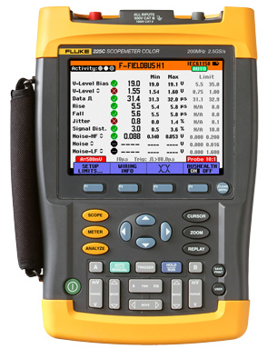

    Hi, I saw the handheld Fluke 225C scope and it looks great for troubleshooting bus systems like Profibus DP.
    But it's been discontinued.
    I found the recently released Fluke 125B which also has this system which Fluke calls "Bus Health Test"
    But compared to the old 225C it's very limited in bandwidth (40Mhz vs 200Mhz) and therefore not really something I feel is worth $2000
    The new Fluke 190 Series II scopes seem great, I especially like the ones with 4 input channels, it could be very useful to me.
    But they have dropped the "Bus Health Test" in this series, or atleast not released a model with it yet.
    Anyone got some ideas on why this is?
    Just for info the old 225C scope was based on the 190C scope, i.e. it the bus test was just a feature added and to differentiate it they gave it a new model name...

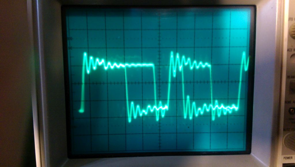

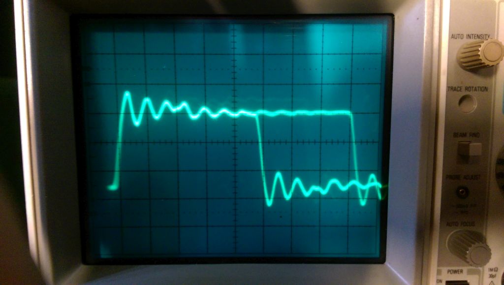

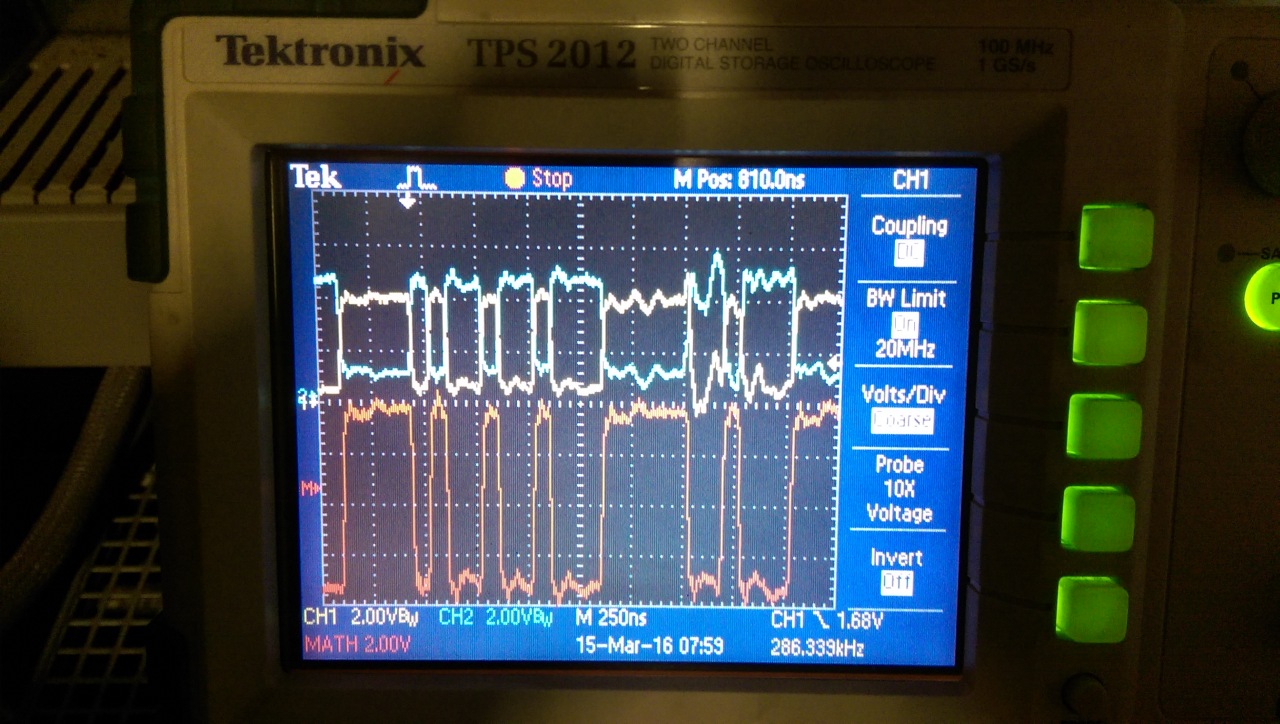

        Was actually troubleshooting a Profibus system today, had to use a scope to find the cause of the problem.
        A Siemens encoder had deformed it's PCB against it's casing and the copper layers in the PCB was therefore shorting to ground!
        Of course all the other devices in the machine was throwing errors except this one!
        Attached two pics of the waveform after I fixed it, amazing that it works so reliably when the waveform is not better!

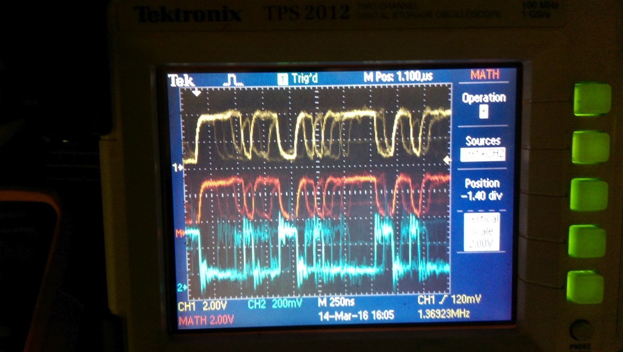

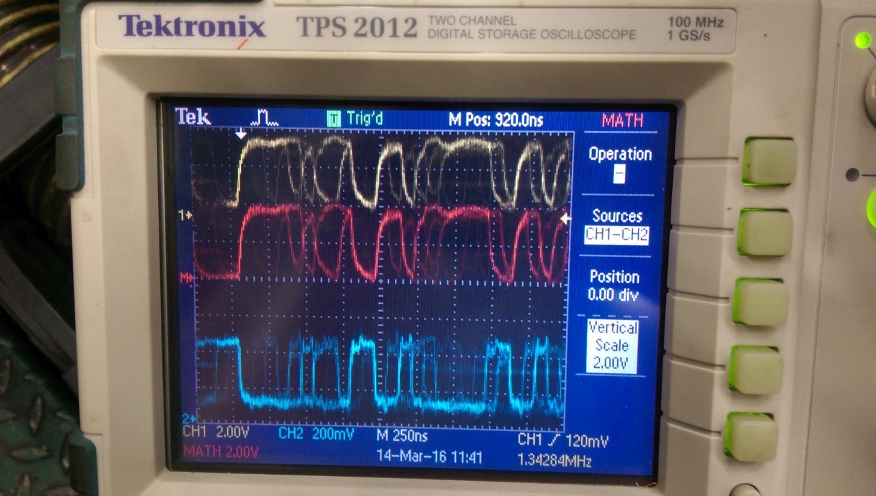

            Re: Successor to Fluke 225C scope or equivalent for Profibus signal analysis?
            You are correct that the scope is not able to trigger on the waveforms properly.
            I spent an hour this morning just testing on another machine but was unable to get it cleaned up.
            If I pause the signal it's correct but not during playback, so maybe the scope is simply too slow to do it, I'm not sure.
            I also noticed that when I simply move the vertical position up or down it introduces noise. (Even with no probe connected).
            So I guess something might be amiss with the scope I borrowed...

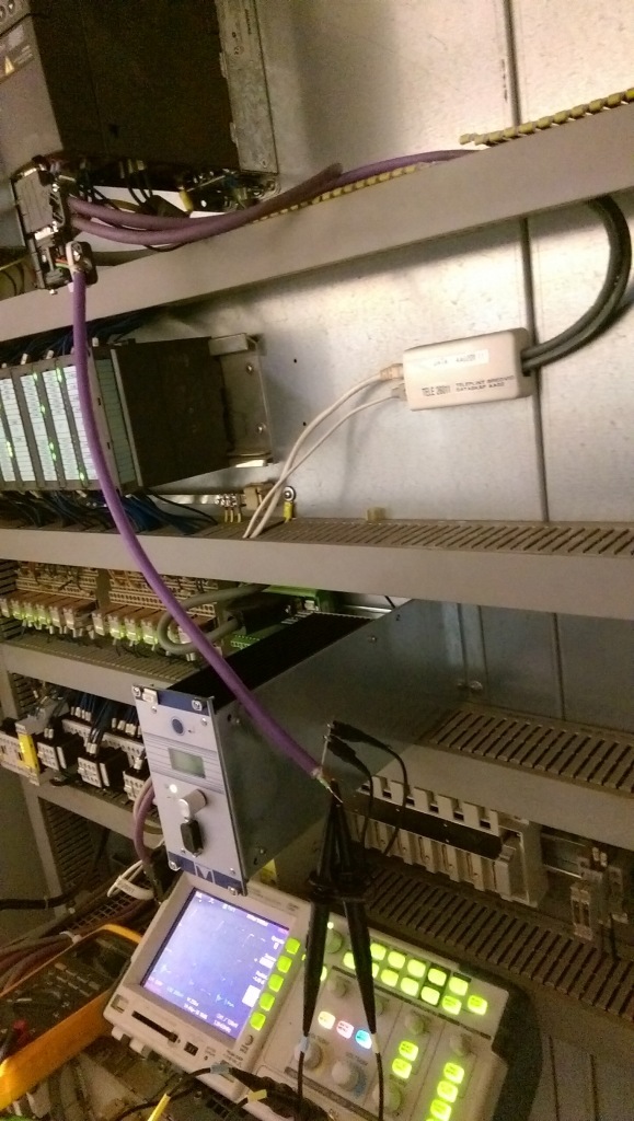

            Of course the small pigtail I hacked together might not be optimal.
            (Hence why I named the picture "Antenna-Setup" in my previous post )

                Yea the probes passed the scopes built in calibration test when I tried it yesterday.
                The waveform also looked good when I hooked it up to a AC>AC power adapter to just check the waveform in my apartment out of curiosity.
                I also tried some other PSU's and there where no problem with the waveform on those either.
                The scope isn't very fast though, I think it's quite old so maybe there was simply too much happening on the Profibus network for the scope to handle it?
                The specs I listed above that Profibus recommends seems to all be fulfilled by the scope I used:

                      Fluke got back to me, they said they dropped the Fluke 215C / 225C series with the Bus Test feature due to low demand, what a shame
                      I looked a little more at the new Fluke 125B but it does not even have isolated inputs so that makes me even less interested in it.
                      I've also looked at all major scope manufacturers but not found anyone else that offers similar functionality.

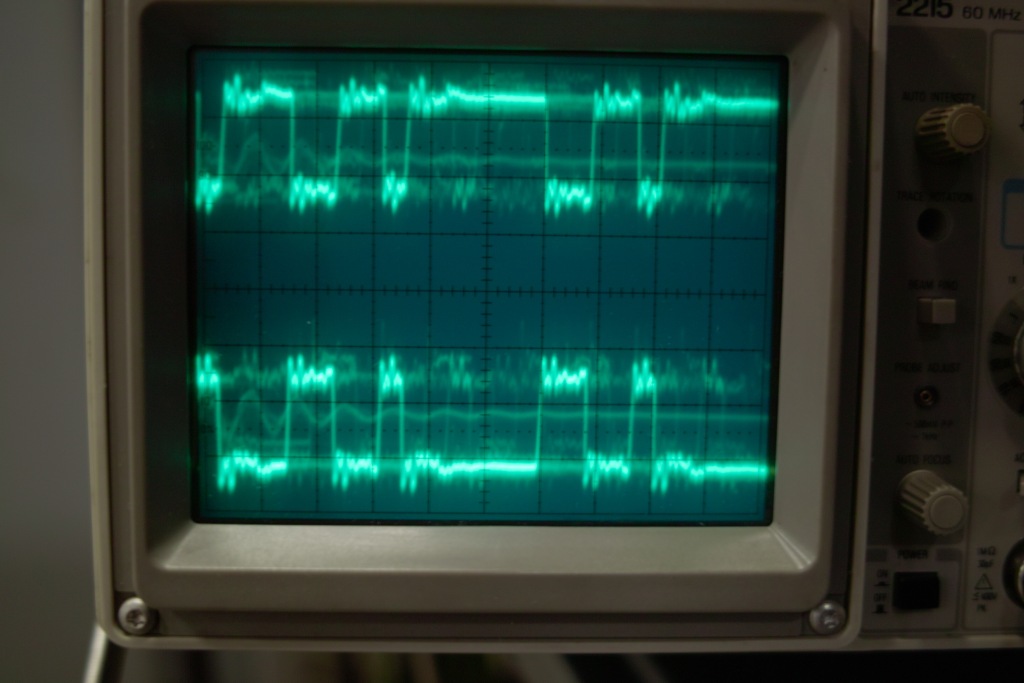

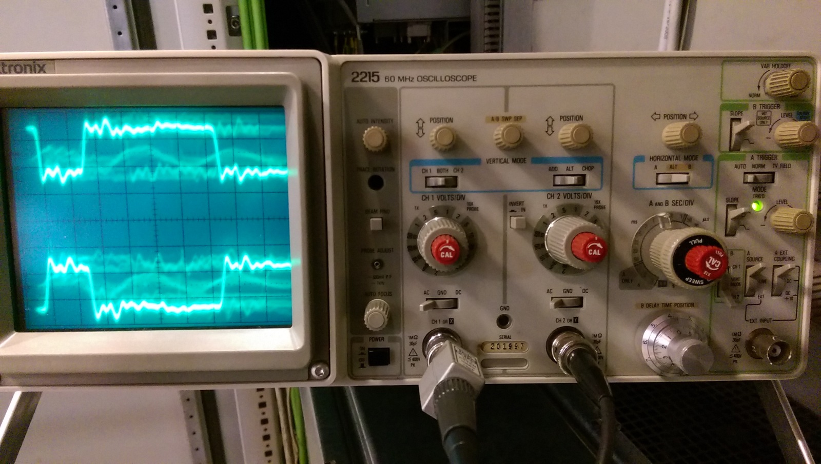

                          Played around with an analog Tektronix 2215 60Mhz scope today.
                          Must say it was a breeze to work with, it's only one year older than me so maybe that's why we got along!
                          This scope did not have any problems with the signal, however it is obvious that a ghost signal is there so I understand how a digital scope like I used before can get confused about what to trigger on.

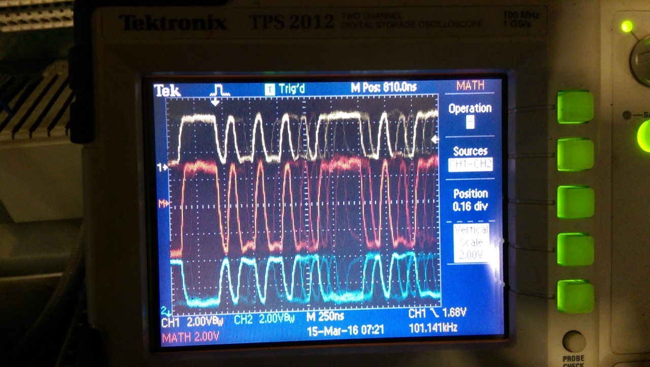

                              Fluke really came through to me.
                              They offered me a Fluke 225C at a price impossible to beat because it had no battery and intermittent power connection.
                              It was an easy fix, the PCB mounted power connector had gone bad, I ordered a new one from Fluke, plus battery and it works a treat
                              However just like the digital Tektronix TPS2012 I posted about above I'm unable to trigger on the Profibus signal.
                              Will try a simpler Profibus system when I have the possibility and see if it's any different.
                              Because I noticed with my analog Tektronix 2215 that I got a much cleaner signal on that machine...
                              (See attached pictures compared to the previous analog ones).
