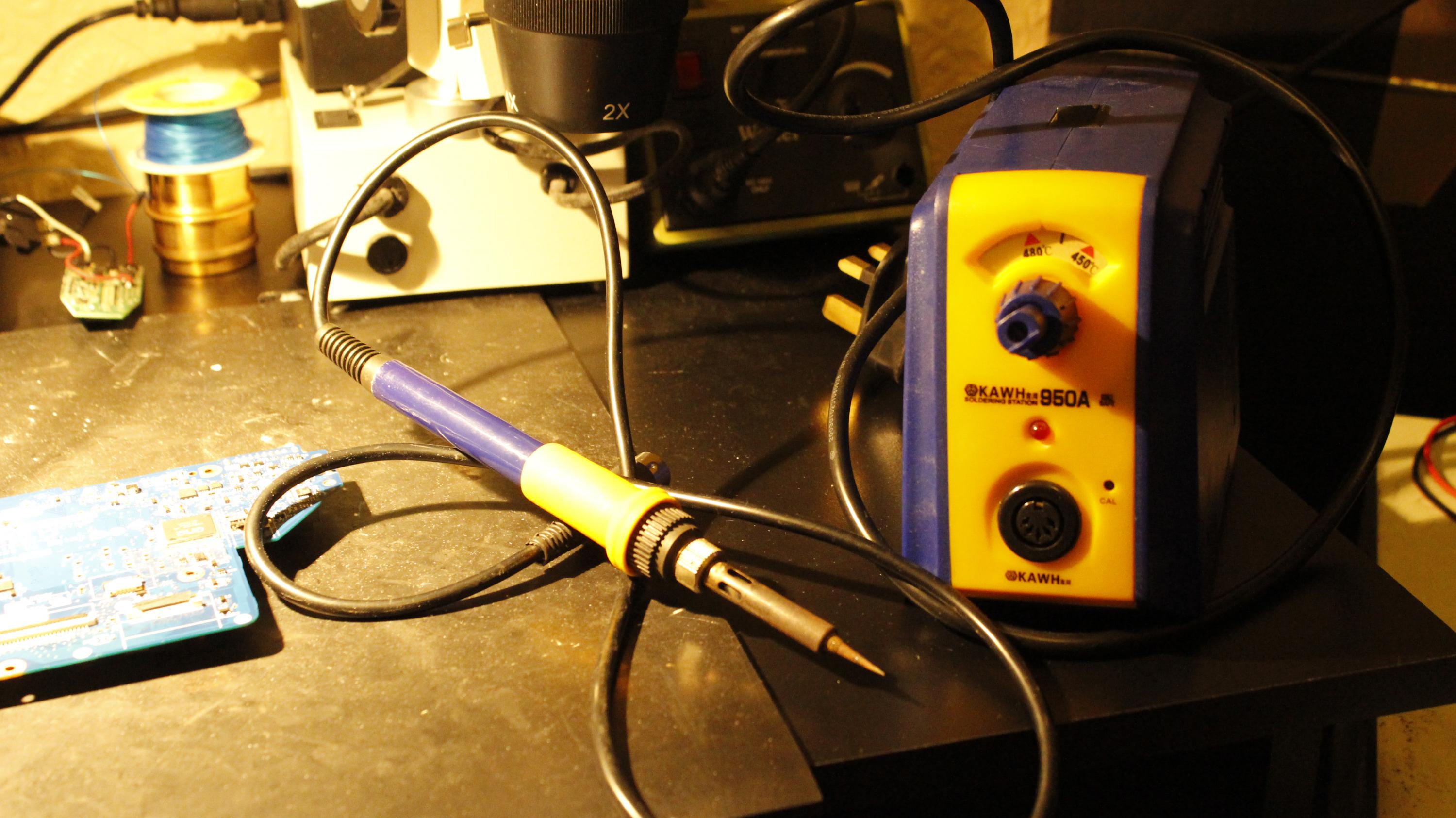

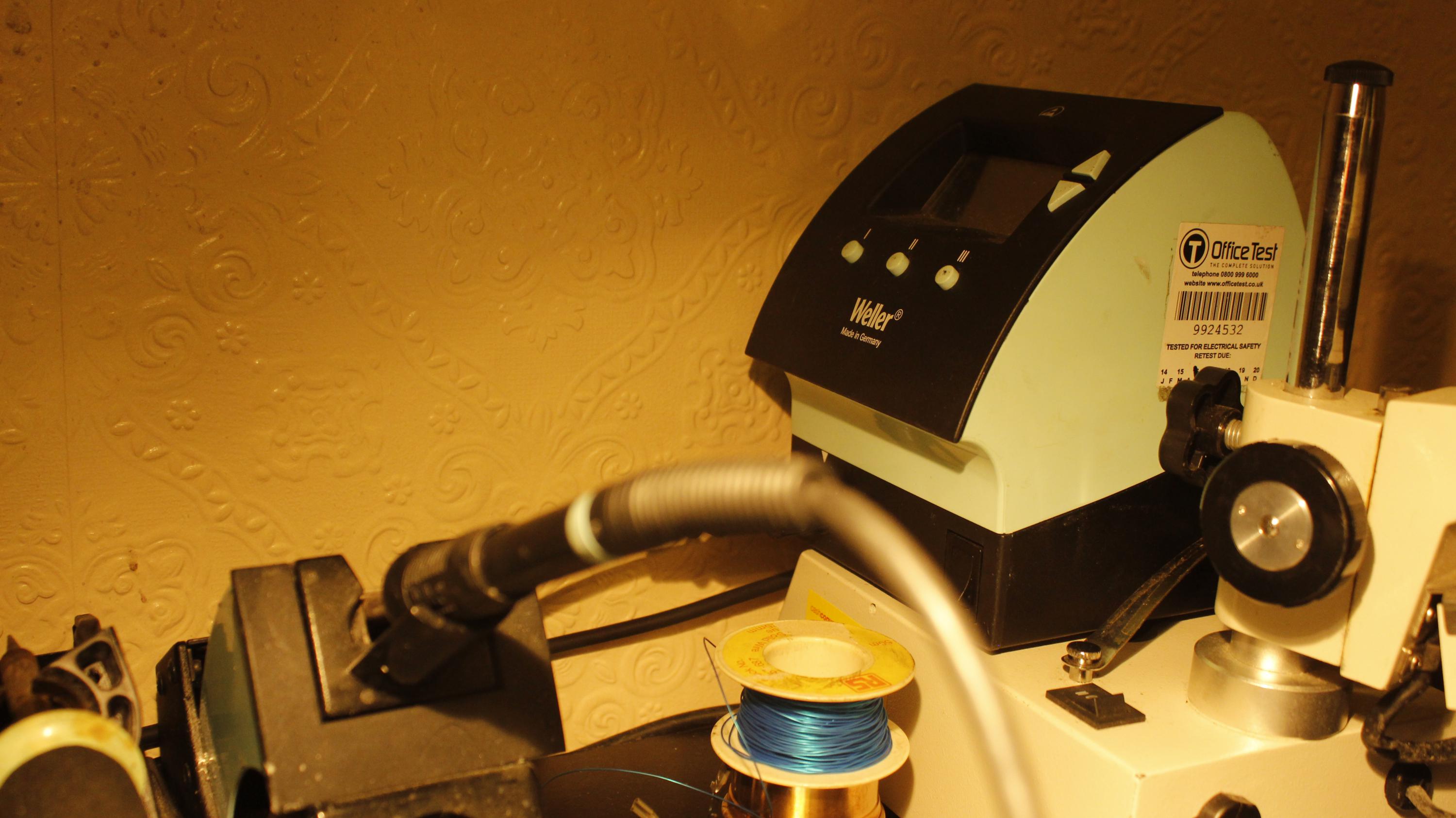

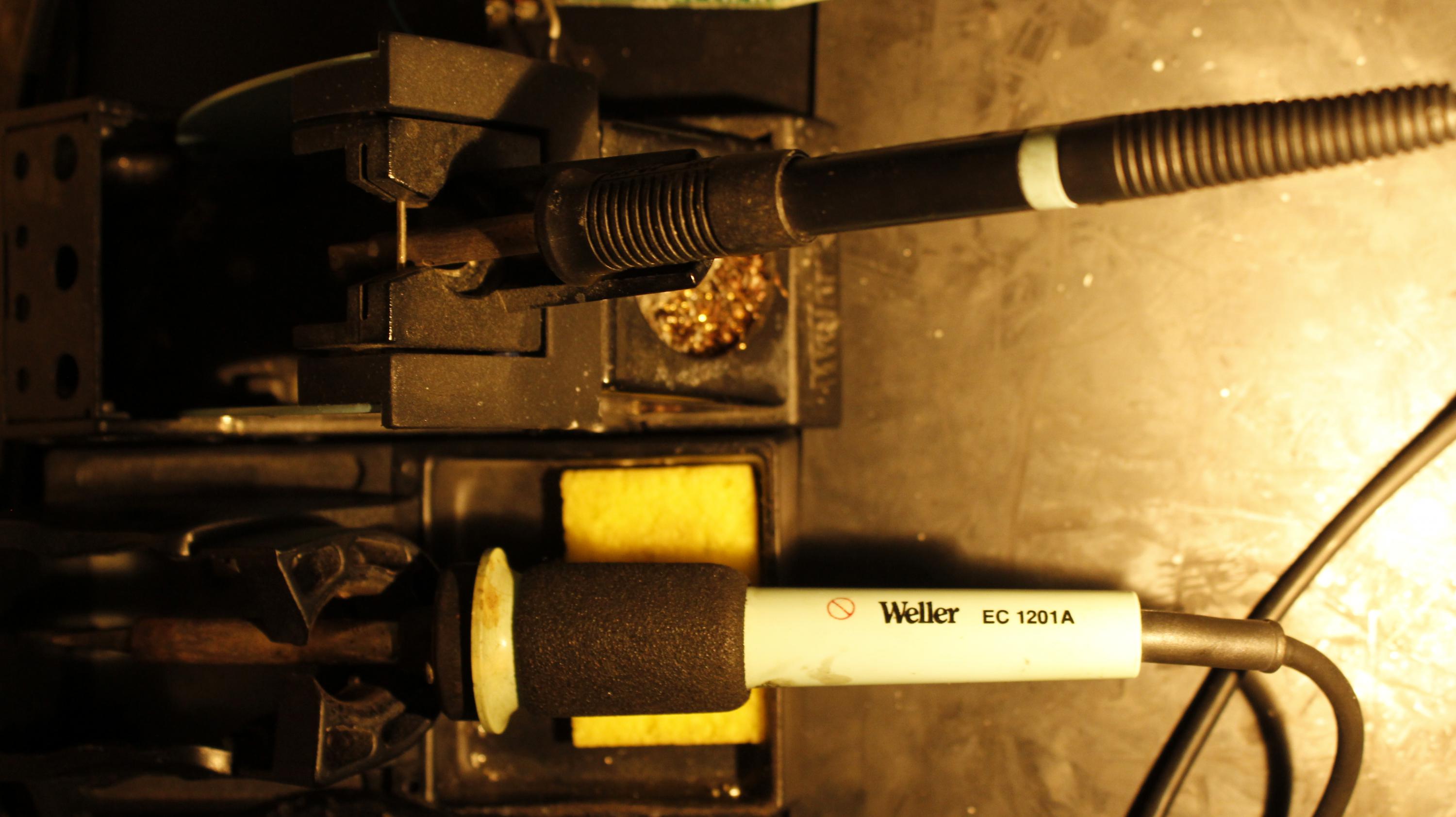

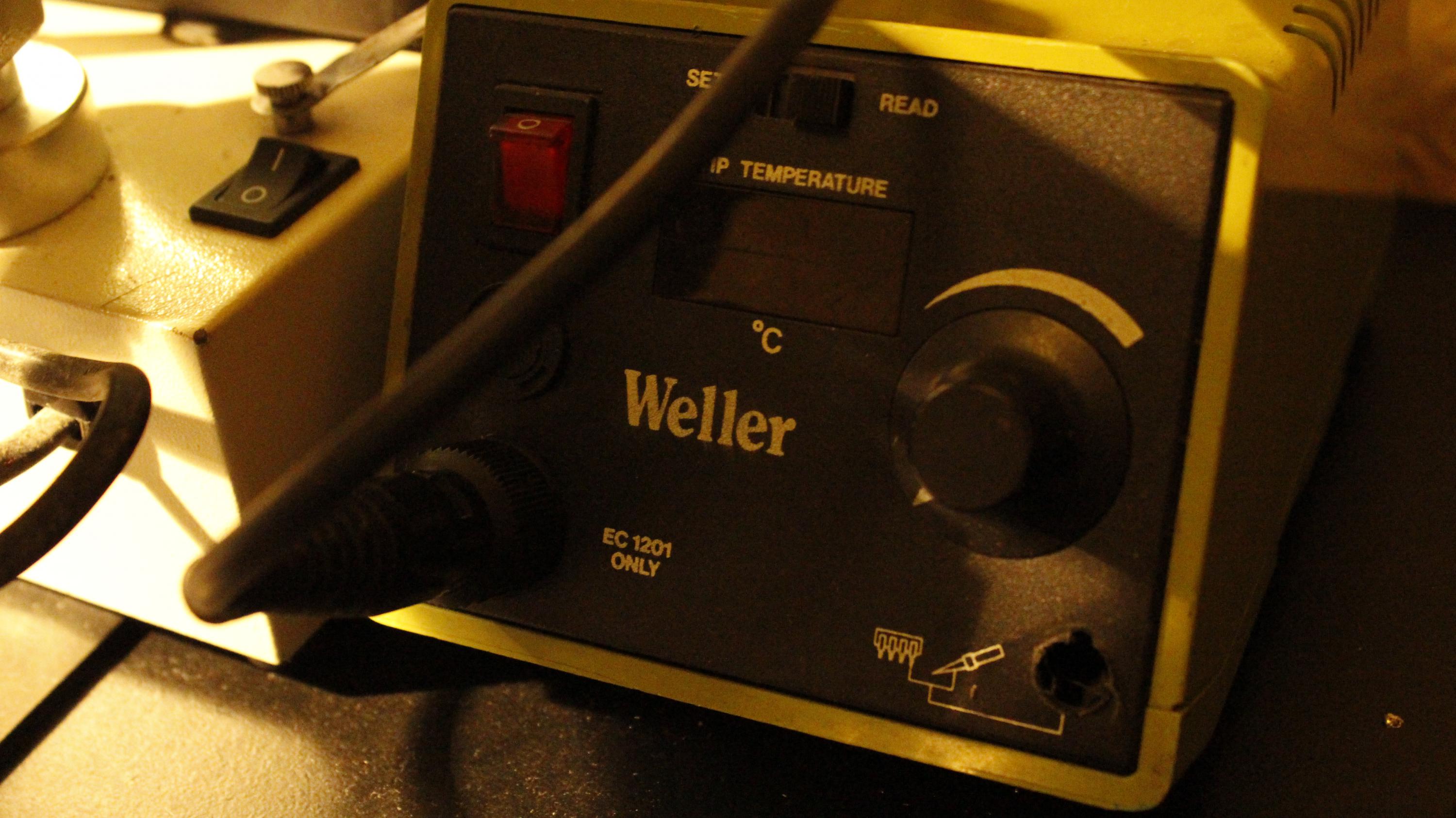

            YES! But there is a catch!
            You won`t really appreciate a soldering station until you get that chines crap and struggle with it.
            Even that crap station from 1st pic is much better but for me that is way far behind me.
            the second and third that makes me do stuff FAST!
            the wd1 its a dream and the ec2100 shows that i know what i`m doing.
            If you will work with this station you need to learn and earn that station because it will make you look good , you will make progress and on top of that you will be focus on your project not that silly iron how to maintain it.
            You will make mistakes on clients products if you don`t invest in a good station.
            I been in your path and believe me its no sunshine there.
            this one i show you its at home that feeds my fraking hobby.
            at work i got other 2 wd1`s( i love them ).
