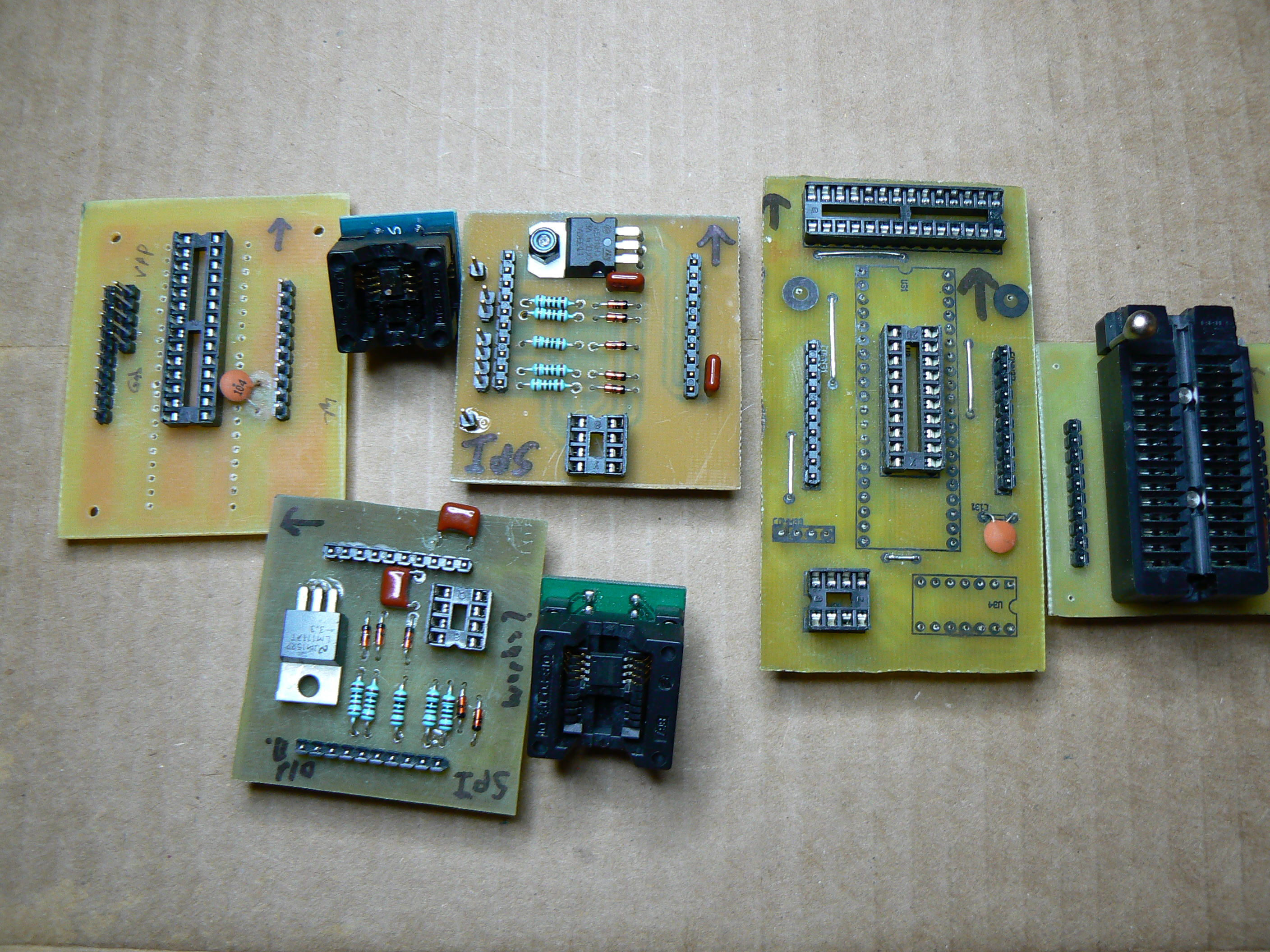

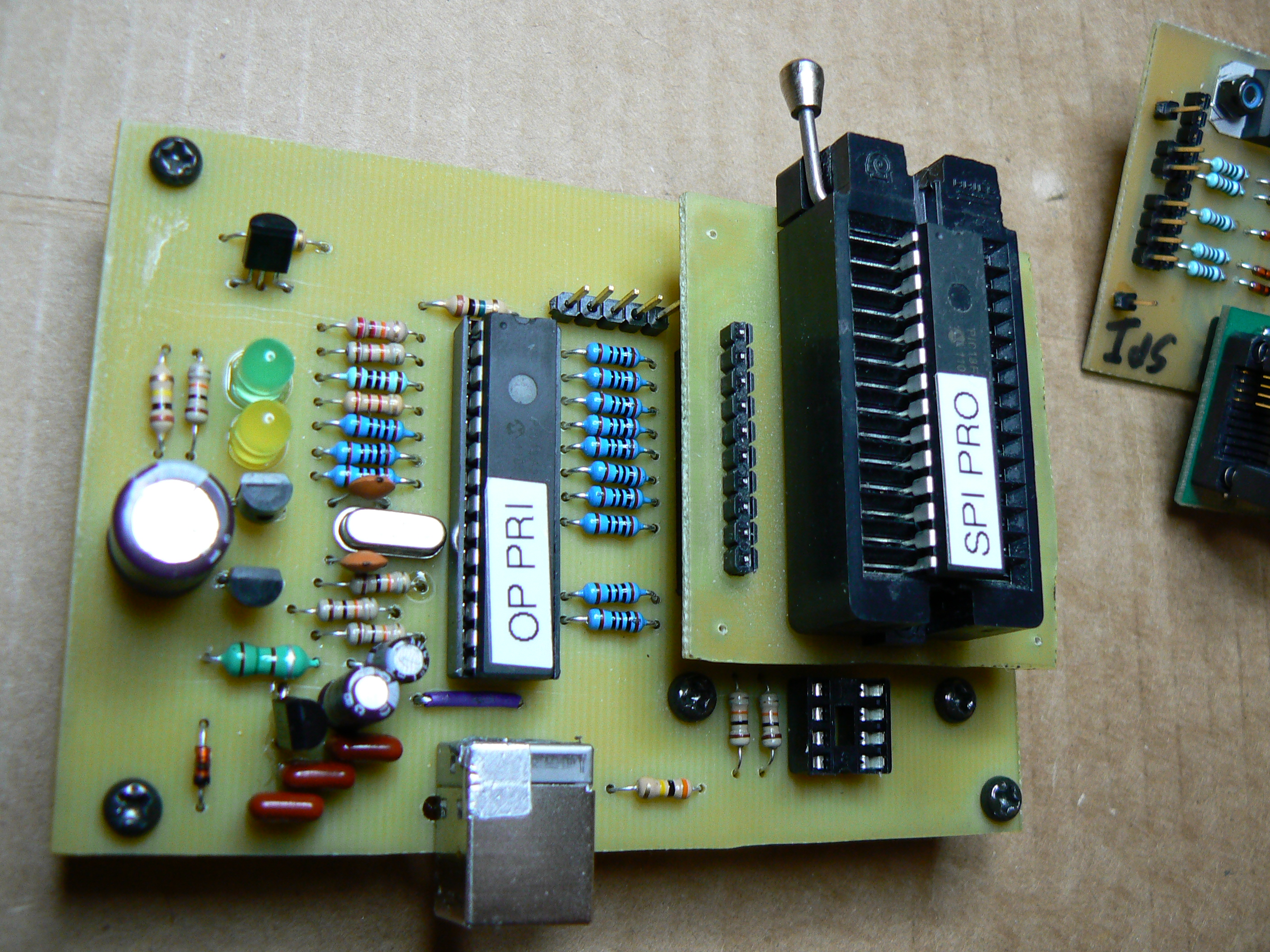

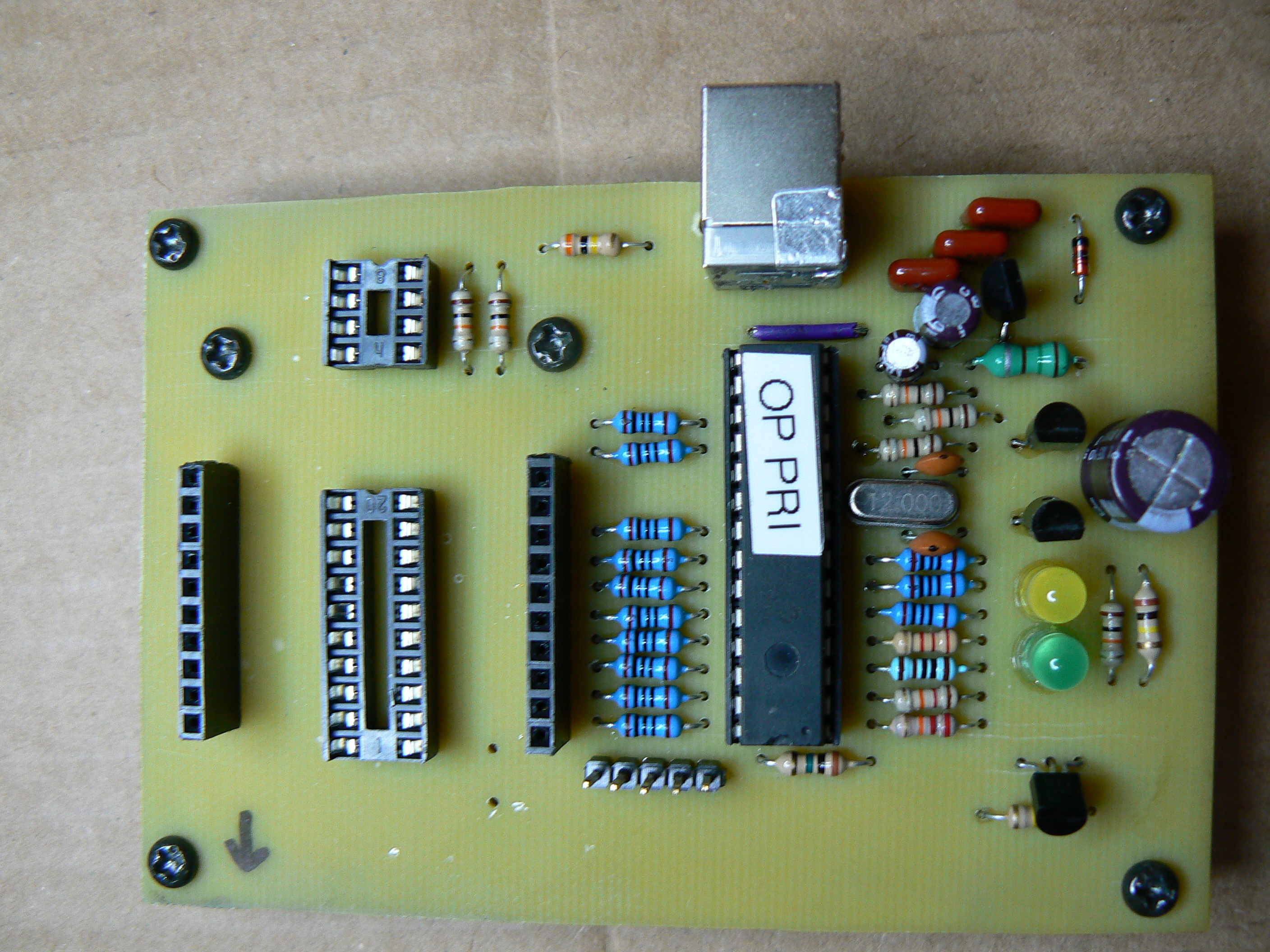

          Re: A good PIC programmer.
          If you are into DIY and want something more universal I would recommend the Open Programmer. It does PICs, Atmel, SPI, I2C, and more. It is also completely open source and does have ICD. (I have never used the ICD.) The real drawbacks are that you would have to build it yourself, and it is not directly supported from MPLab.
          http://openprog.altervista.org/OP_eng.html
          http://sourceforge.net/projects/openprogrammer/
