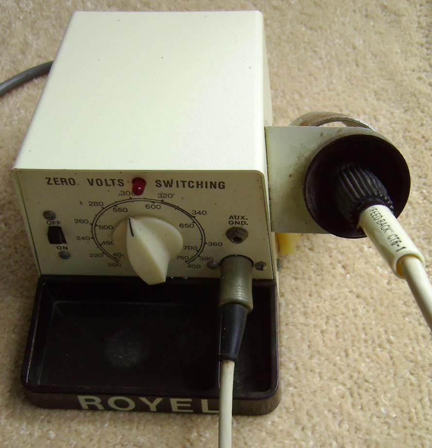

                In the meantime I've unpacked its predecessor, a reliable Aussie built-to-last station - coming up to its 30th birthday, and fired up without a problem

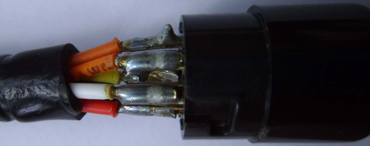

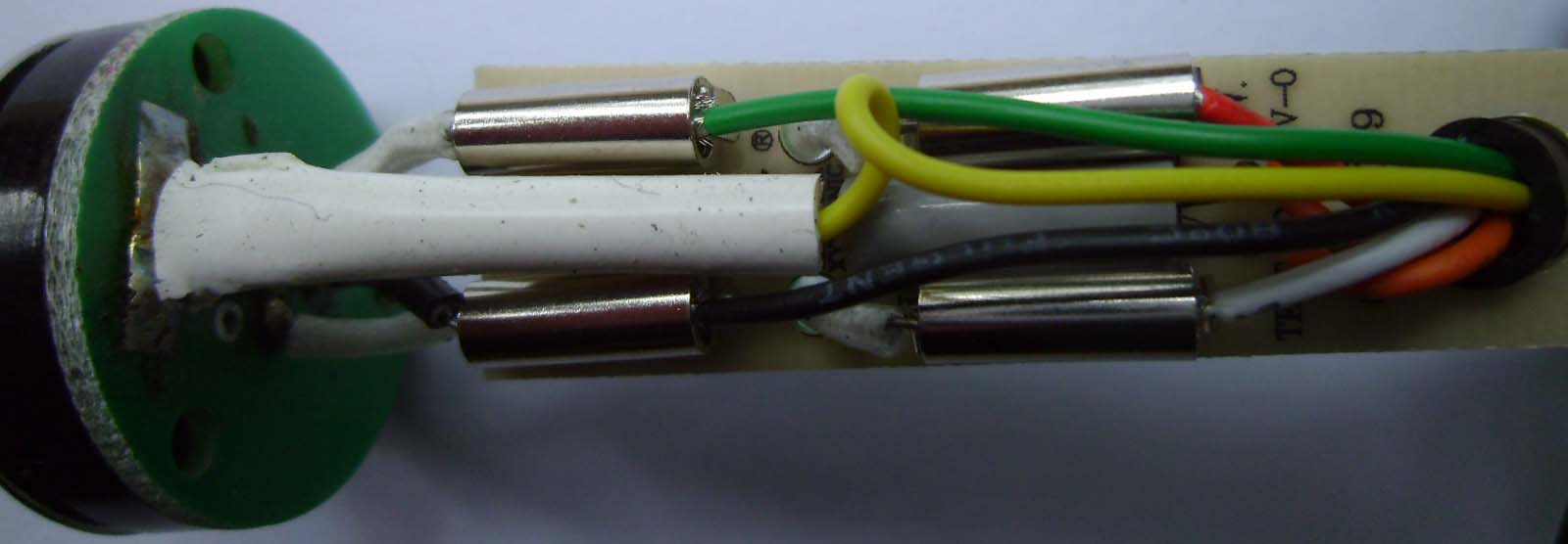

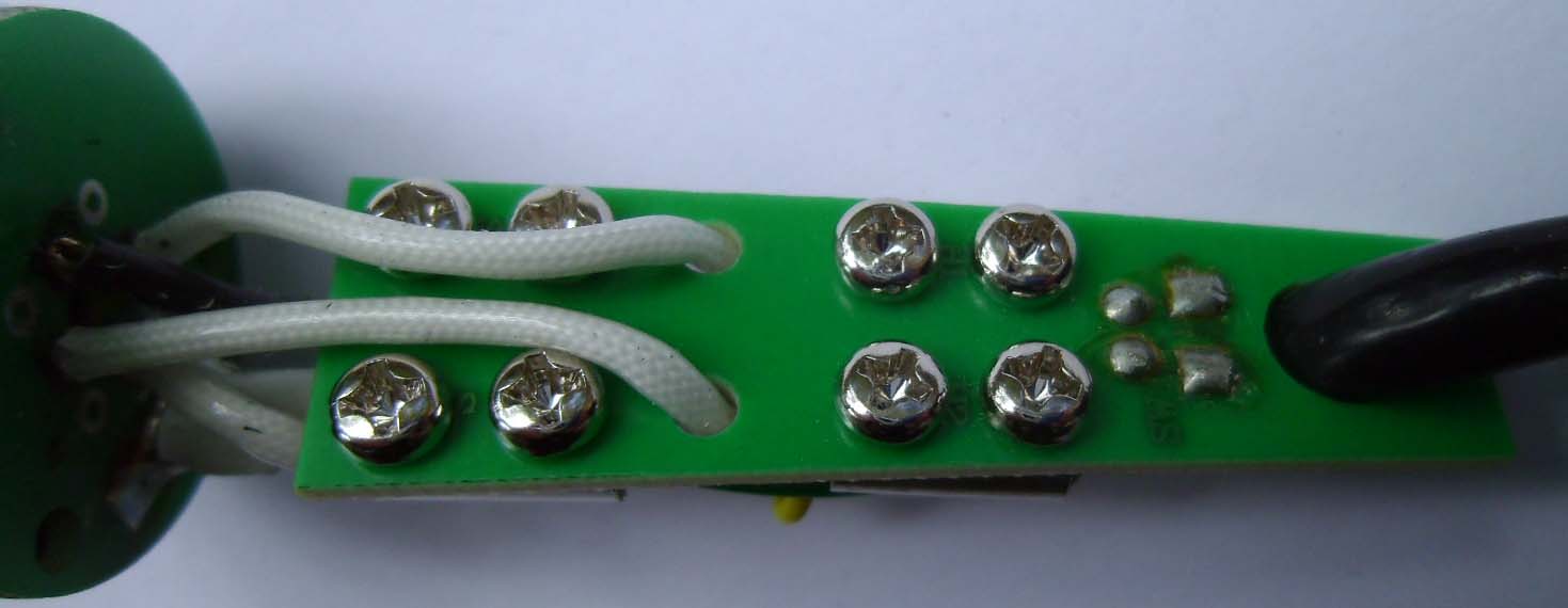

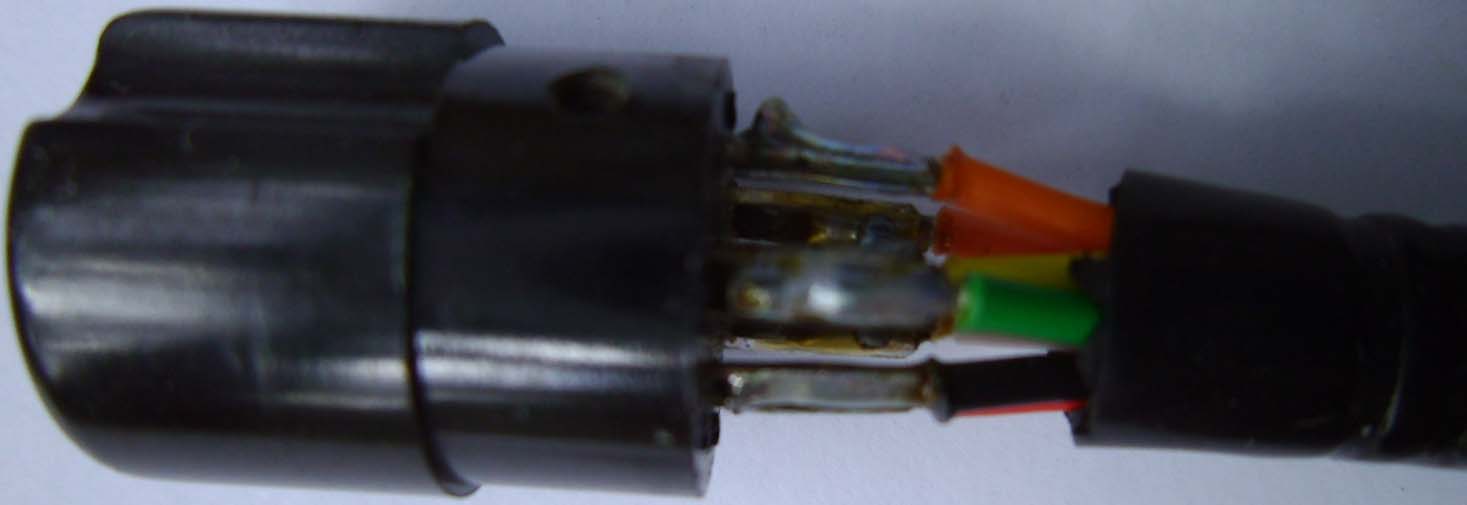

                  The screw at the other end of the handle must have been a cable clamp because after removing it, as well as the 3 self tappers, the assembly pulled apart fairly easily
                  There's continuity between the green & black wires shown in the pic
                  Also continuity between the two orange wires soldered to the PCB, under the red & white connections
                  Except for the orange wires, there seems to be one-for-one continuity between each of the wires and the connector that goes into the soldering station
                  What next - source another element and hope that's it ?
                  better to keep quiet and be thought a fool, than to open your mouth and remove all doubt
                    • 30985
                    Re: Altronics T2380 Soldering station busted
                    open the plug at the other end, and check continuity on all 5 wires.
                    • pfrcom
                      Oldbie
                      • Jun 2006
                      • 1230
                      Unsure what you're suggesting - I've already checked continuity on all 7 of the wires, from the element end to the outside of pins in the plug
                      And speaking of pins in the plug, their original soldered connections look perfect on the inside - refer to pics

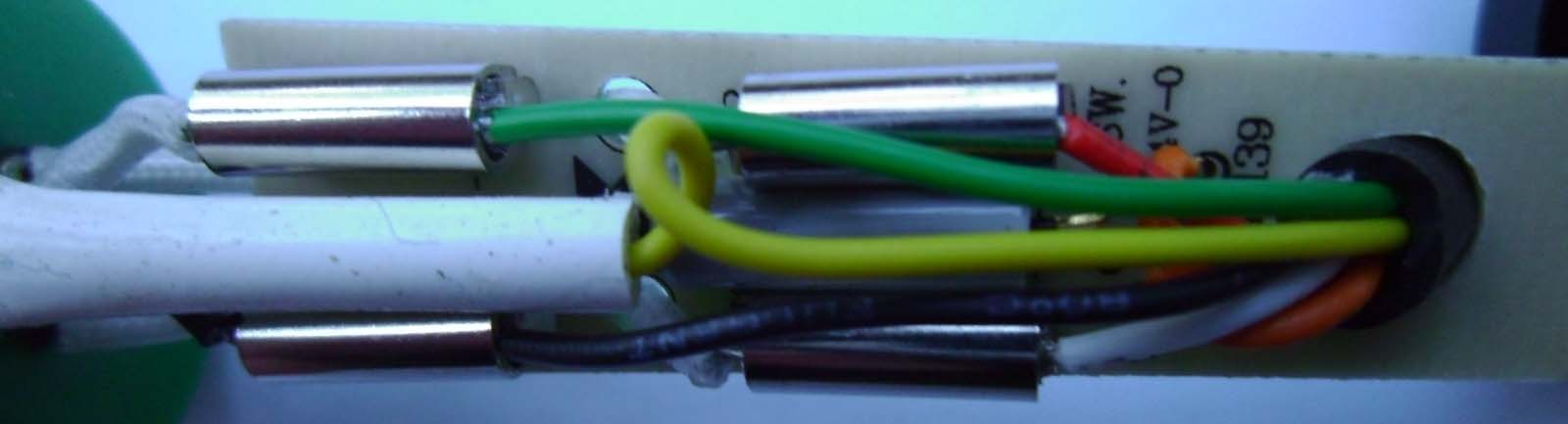

                      I've also added extra pics of the element end - is the yellow wire the one that delivers input power ? - I'm assuming it is, judging by the size of its soldered connection to the small round PCB
                      Which colour is the other power wire likely to be ?
                      Why are there two orange wires, and what are they likely to be for ?
                      The two square solder points next to where the black cable comes in, are where the orange wires connect to the rectangular PCB
                      The two smaller round solder points adjacent to the square ones, connect something coming out of the element - temperature sensing perhaps ?

                        • 30985
                        yellow looks lithe the earth wire to the body of the iron.
                        the orange pair may be a tilt switch or some other type of switch to detect if the iron is in the holder - does the holder have a magnet in it?
                        the white/red pair and the black/white pair - one is the element, the other is the sensor.
                        try this:
                        put a meter set to volts across one pair and heat the tip with a lighter.
                        if your on the sensor wires there is a 50/50 chance you will see a rising voltage as the tip heats.
                        if you do this with both pairs and dont see a low rising voltage, repeat it metering resistance.

                          I didn't see rising voltage on either pair
                          With the white & red wires, I saw resistance steadily falling from ~2800 to ~2200 ohms while heating the element with a heat gun
                          FWIW the rectangular PCB is marked:
                          S+ corresponding to black wire
                          S- green wire
                          H1 white wire
                          H2 red wire
                          I can't see any markings on the small round PCB which I assume connects directly to the element

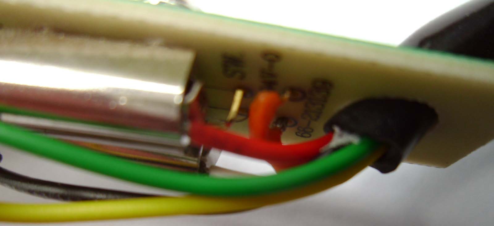

                            I mislead saying this - in fact there's a grey cylindrical component sandwiched between the two connectors into which the white & red wires go
                            The grey component has two wires coming out of it, one really fine and the other quite sturdy, which go to the smaller round solder points that I mentioned

                            • Agent24
                              I see dead caps
                              • Oct 2007
                              • 4950
                              • New Zealand
                              Any markings on it? Photo?

                                  • pfrcom
                                    Oldbie
                                    • Jun 2006
                                    • 1230
                                    It can be seen in the pic in post no. 9, beneath the yellow wire
                                    One of the leads coming out of the grey cylindrical component is extremely fine, so I'll let sleeping dogs lie rather than try lifting it up to view markings
                                    I took the cover off the station to see if anything obvious was wrong (nothing I could see)
                                    FWIW the two wires inside coming from the orange wires' places on the socket, seem to go to points on a sub-PCB marked LED
                                    Before re-assembling the soldering handle, I clipped test leads to the white & red wires marked H1 & H2 on its PCB
                                    Assuming H1 & H2 meant heater connections, I measured resistance first at ~6 Kohm (after sitting overnight in a chilly garage)
                                    Switching the station on, I saw voltage start at 0.25 climbing to ~0.3 - I was expecting something much higher, to drive a heating element
                                    To compound my confusion, inside the station I unclipped the connector going to the outside socket, then clipped the test leads on pins corresponding to H1 & H2, to which that connector joins
                                    Switching on again, I saw voltage start at ~0.4 then settle down to zero
