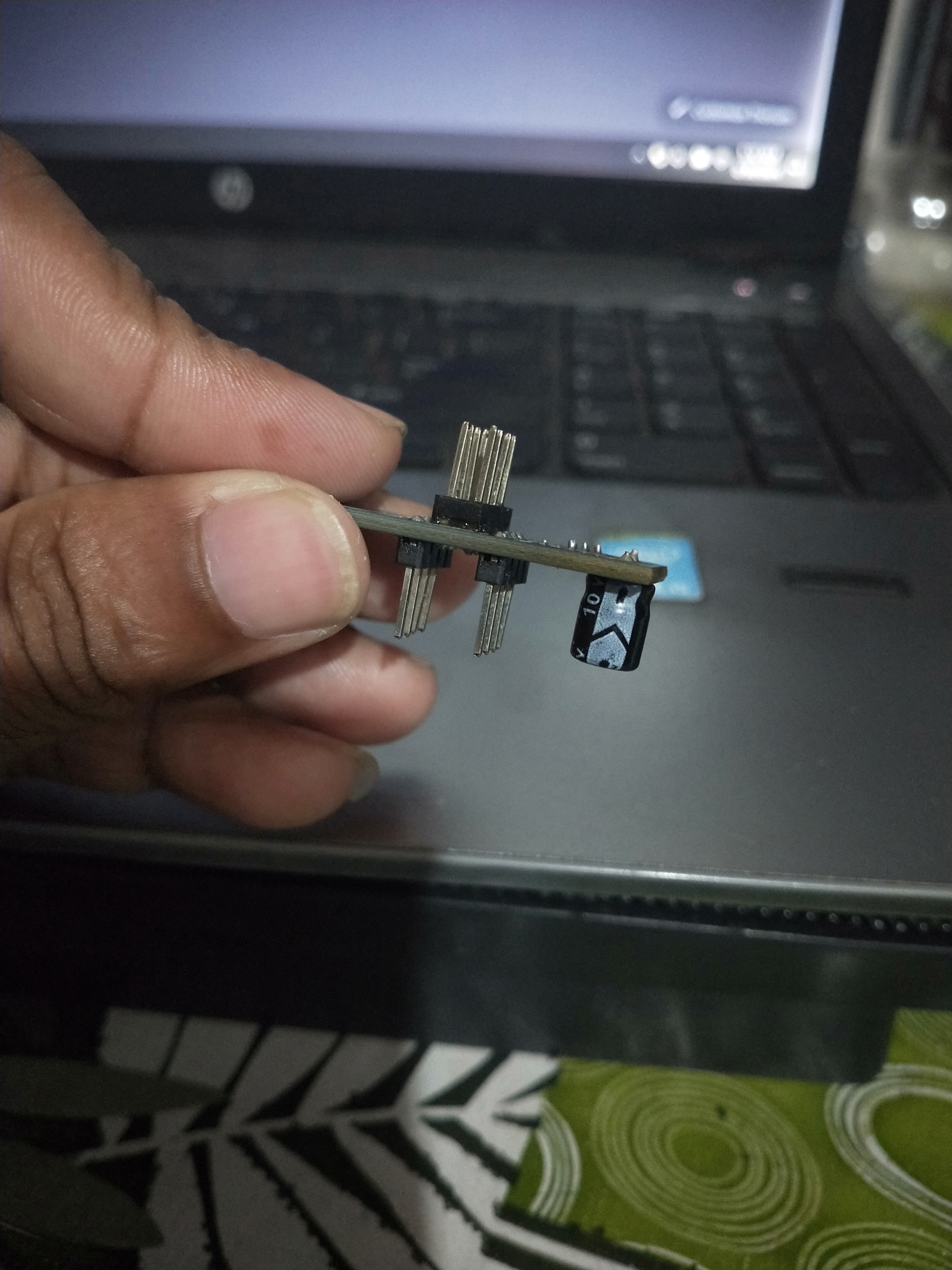

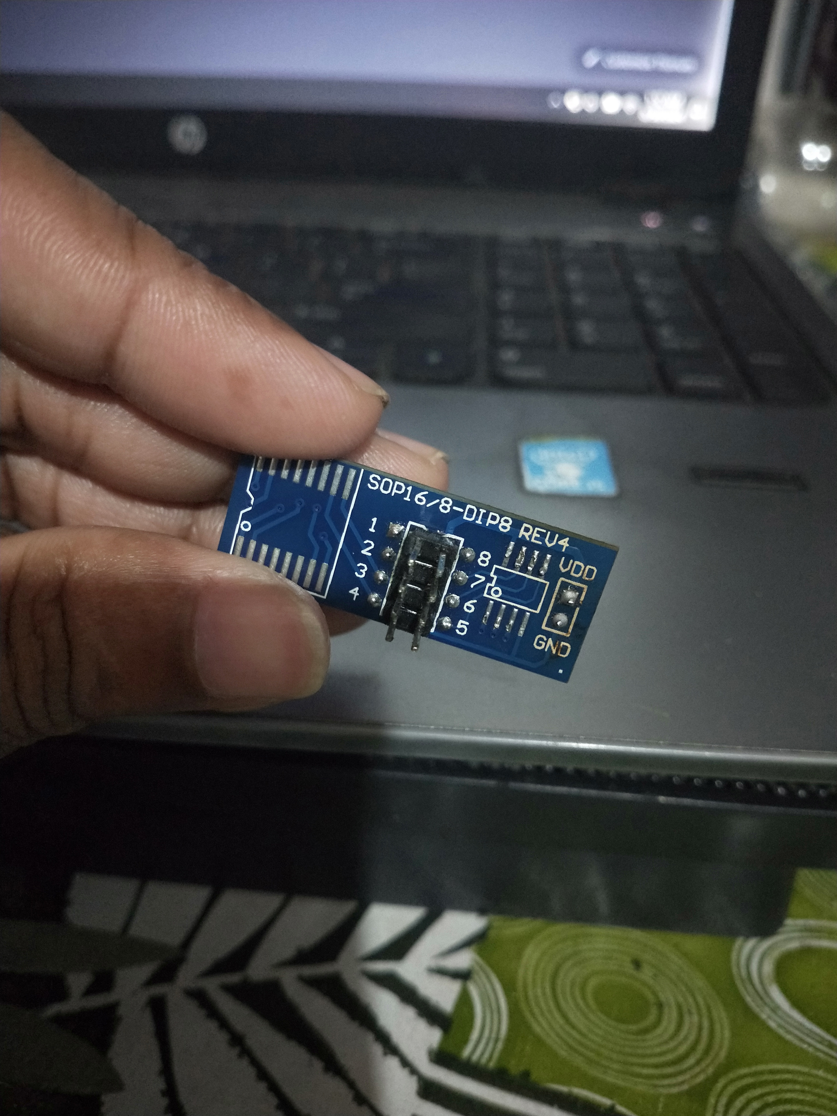

                  Originally posted by stj
                  post a picture of the board.
                  These are pictures of the programmer.
                    you can try one thing connect a capacitor from GND to VDD then try. your's and mine are same board and chip(CH341B not A)
