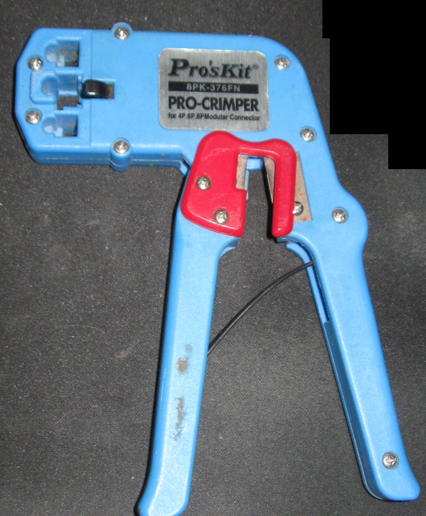

        For network and phone jacks, you want a crimper that puts the same amount of pressure on both ends of the jack.
        This is the tool I used years ago when I worked as network administrator (click to zoom):
        Not a professional tool by far, but way better than those cheaper things which put uneven pressure and in the case of cheaper jacks can even stretch the channels and weaken the jacks.
        For some connectors like Molex and so on, I use an Engineer PA-09 crimper... quality tool with good steel : http://global.rakuten.com/en/store/m...tem/800-pa-09/
        If you find a crimper for bnc made by them, it's worth it.
        For round crimping as is the case with the connectors the tool in first post does, it's not an issue, so I guess that one will works OK.
