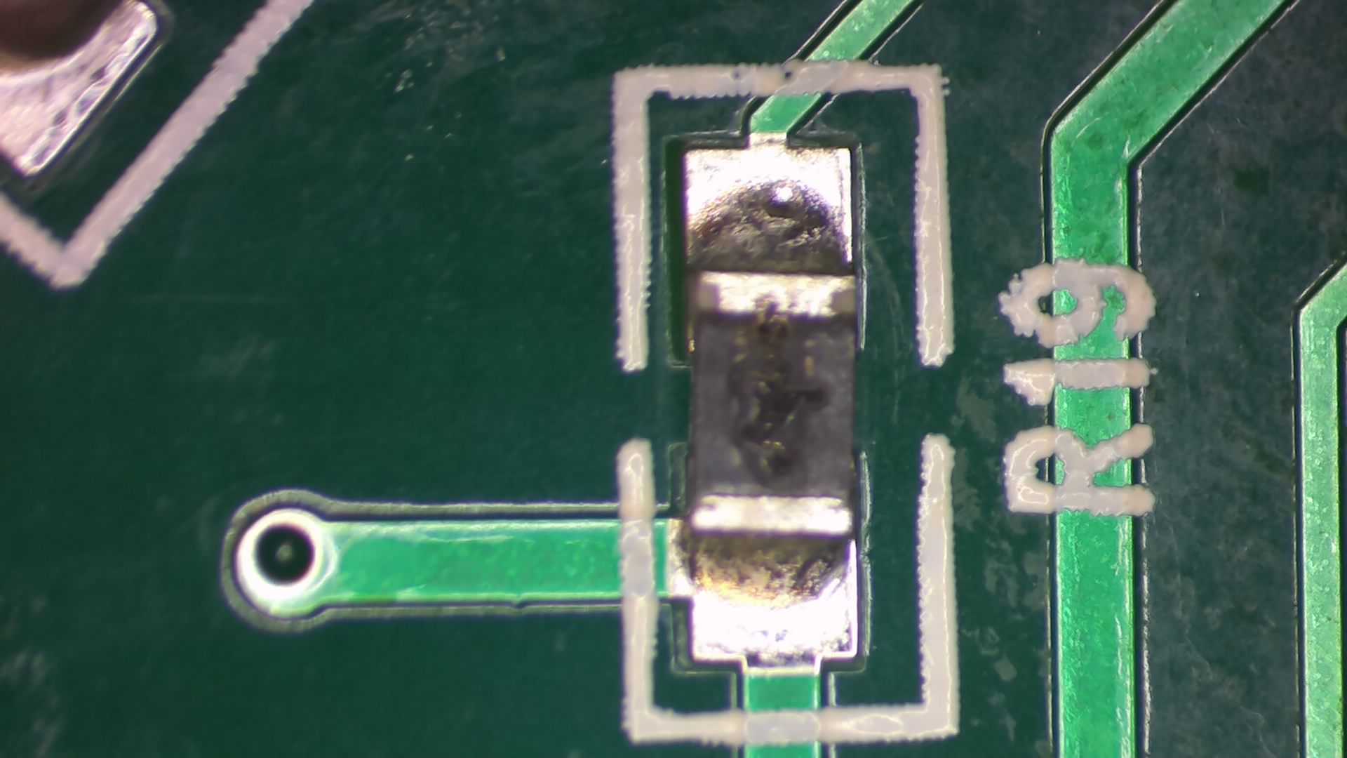

    I managed to blow the fuses in my Klein MM400 multimeter and when I replaced them I was still getting a cal and error0 message. I started looking around the board and found one resistor that was testing OL and has a visible burn mark on the top of it so I can't tell what the value is anymore. Its marked as R19 on the board and I included a picture below of what it looks like.

    Does anyone know from working on these what the value is or have this exact meter they could open up and check the value? It's not my only meter, but it is my first real non harbor freight meter so I'd like to see it working again if I can for sentimental reasons.

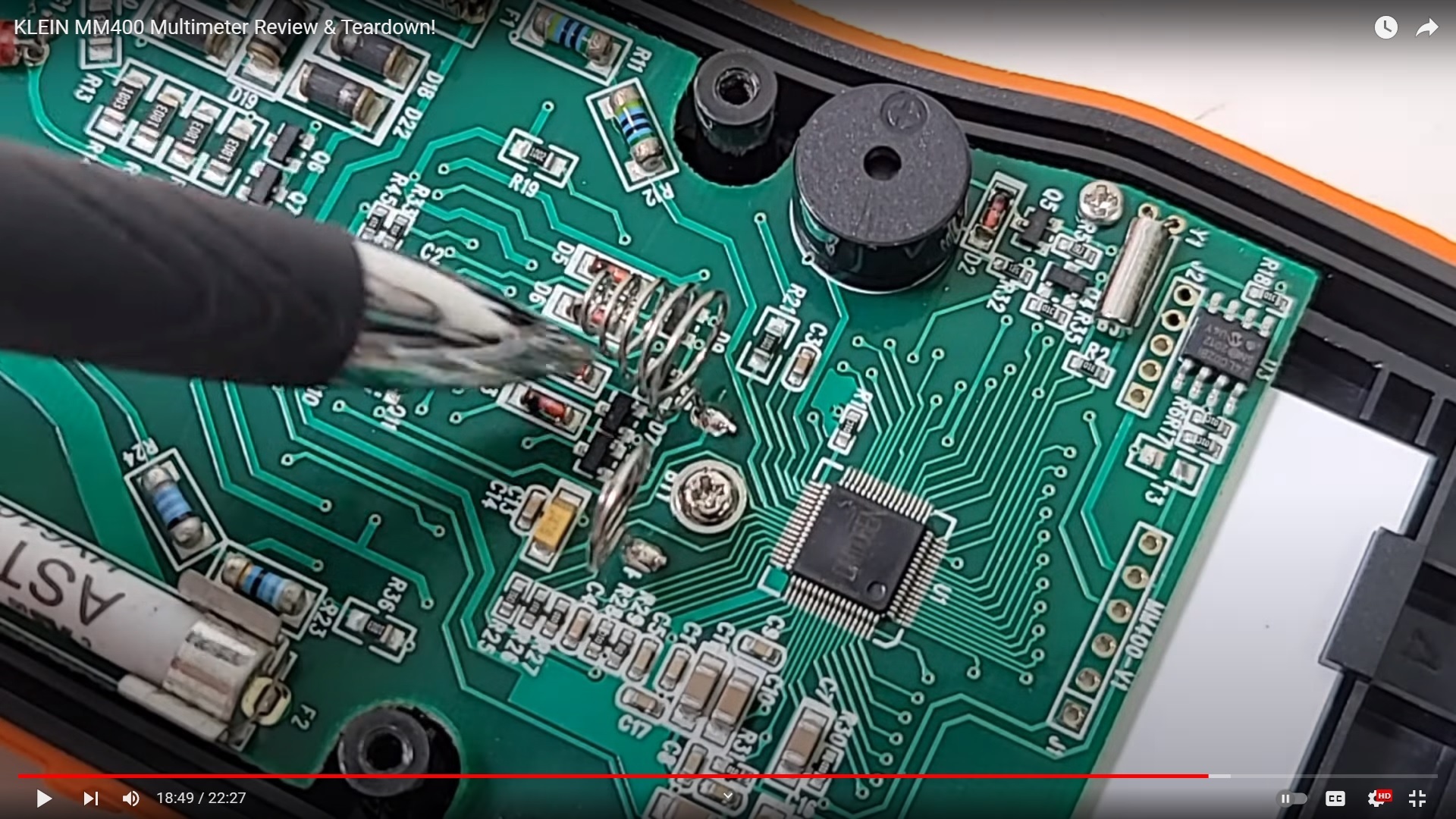

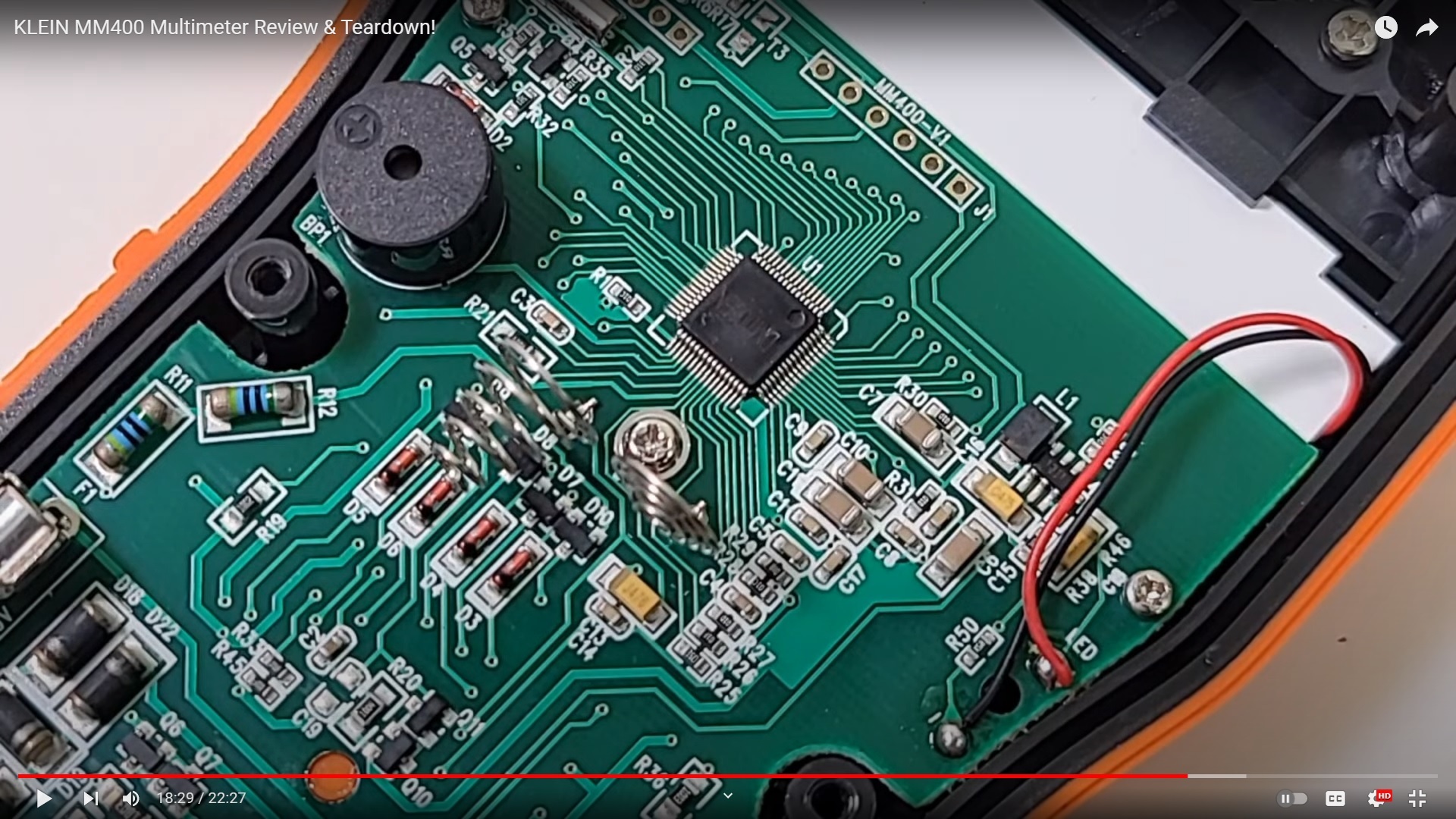

    I found this video and took this image, best I can do. KLEIN MM400 Multimeter Review & Teardown! - YouTube

      OP you're not telling us the whole story. The fuse is for protecting the shunts when measuring current. An overload there is supposed to be clamped by the 5 MELF diodes D18,19,20,21,22.
      R19 looks to be "1002" 10kΩ and burning that up takes a lot of voltage overload say over 120V. I would expect further damage but maybe you got lucky.
      If you have another multimeter, you can check some basics on the DMM chip to see if it survived, or the protective clamp transistors as well.

        Thank you for the photos I wasn't able to find that video when I was checking youtube for teardown videos or any repair videos for my model. That's exactly what I need. Fingers crossed that resistor is all that is wrong with it.

                Update on the blown resistor. I replaced it and then a short appeared on the main DM1106EN IC. I removed the shorted cap and the short was still there. I removed the IC and the short went away. Looks like I killed the main IC unfortunately.
                This DMM had a good decently long life for what I paid for it 8ish years ago ($30 on an amazon sale) so unfortunately it gets to be retired after a good working life of daily use.
