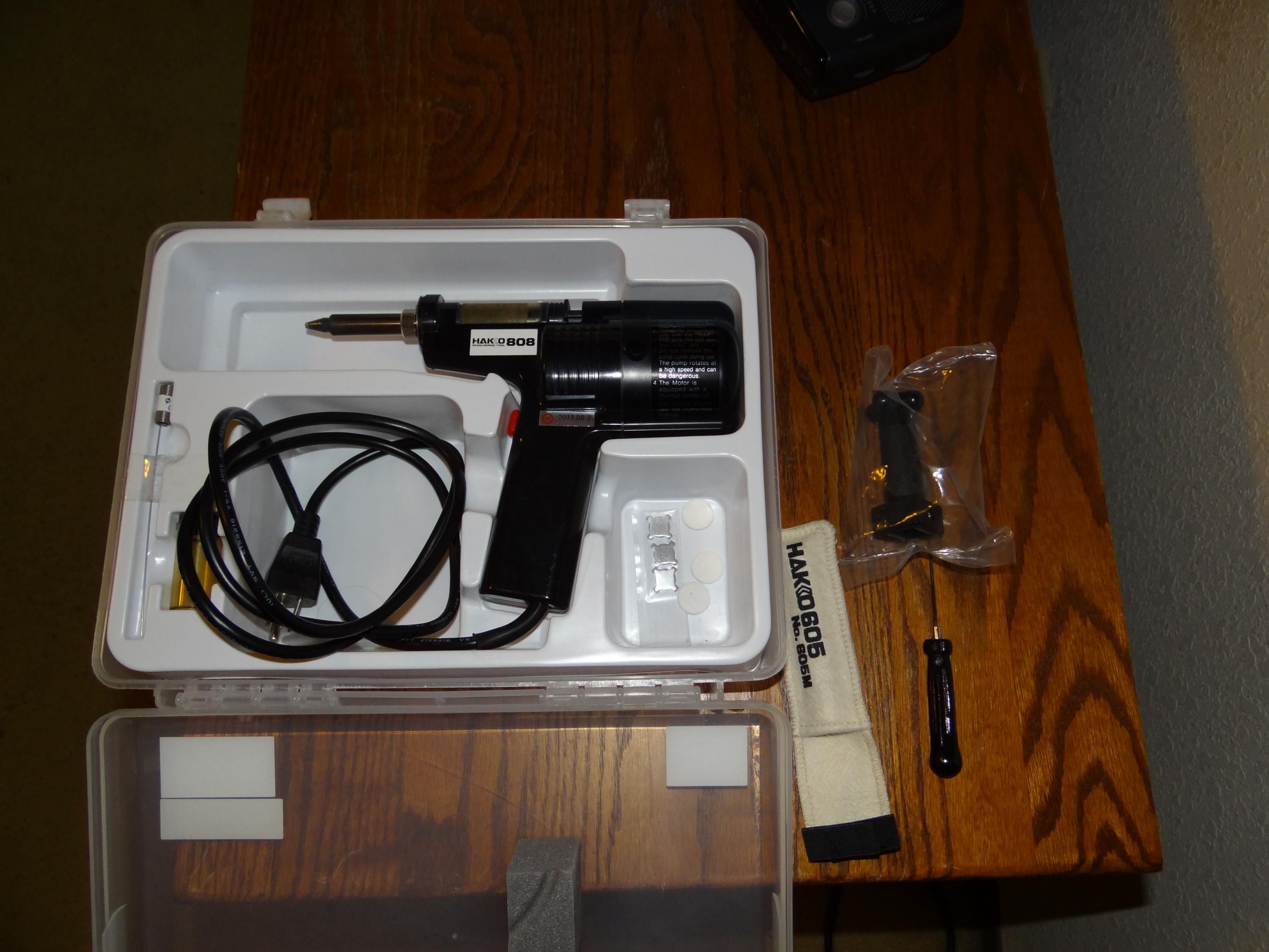

    Received a Hakko 808 yesterday, purchased at Fry's, delivered by a visiting family member.
    The packaging is suspect, no instructions, no cardboard on the front of the box.
    Missing the nut on the tip. I thought it came with 2 filter pipes, only 1.
    1 cleaning pin not 2.
    But the big problem is, it doesn't seem to get hot enough. Even cranked up all the way, it barely melts my standard leaded solder, doesn't do jack to my 2 test PCBs I tried.
    Guess I'm sending it back with my relatives.

    Here's a pic of my kit. I'm not sure what's included in the Fry's kit.
    Is there a small amount of solder on the leads you're trying to de-solder? I have to add solder on occasion to get the solder to melt and vacuum properly. I normally have the heater set between "2" and "3" on my gun. I might even go lower on single-layer boards. Otherwise, I rarely have issues with the tool; it's one tool I can't do without.

      Compared to yours, mine is missing one tube, the black-handled cleaning pin, the nut, the black wrench (though mine has a small metal one) otherwise it looks the same.
      Tried it again today on a spare monitor power supply board that I had already recapped. Even on small traces on a single-sided board with known leaded solder, it wouldn't melt. If I heated it with my other iron, then tried the 808 it would remove the solder if I worked fast, but definitely not hot enough.

        So my suspicion was correct. It was returned to Fry's today, and they apologized.
        Apparently that one was supposed to be sent back for repair, and somehow got put back in stock. My relative is shipping me a new one.
        I doubt that it was deliberate. Putting defective stock back in with good would just have it come back again, so it was likely an honest mistake. Unfortunately the person picking it up didn't know what it was supposed to look like, or have in the box.

            Got the replacement today. What a difference!
            This thing is the cat's ass. Did a quick test-desolder of 2 caps on a monitor pcb I had laying around. It heated up fast, sucked that solder out like <naw not going there>
            really well.
