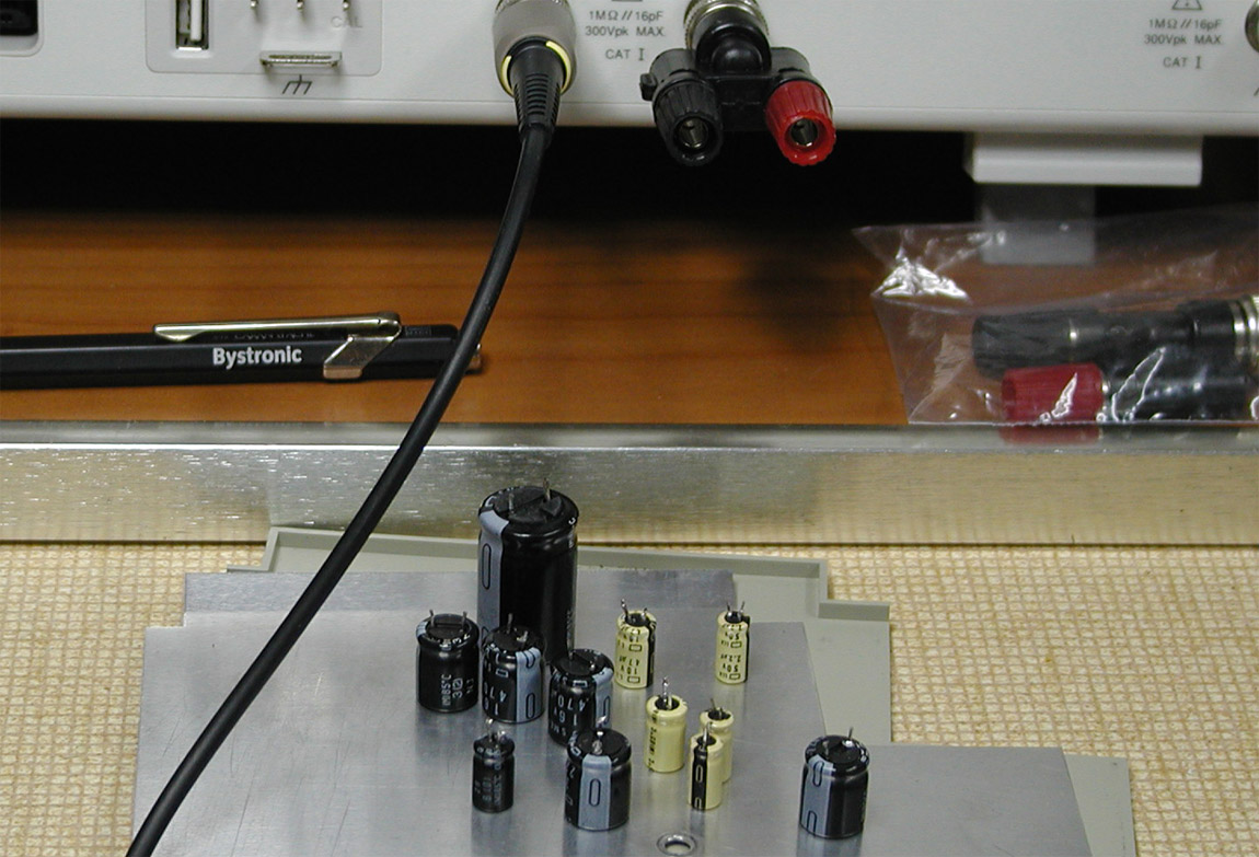

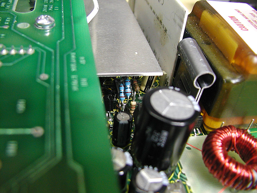

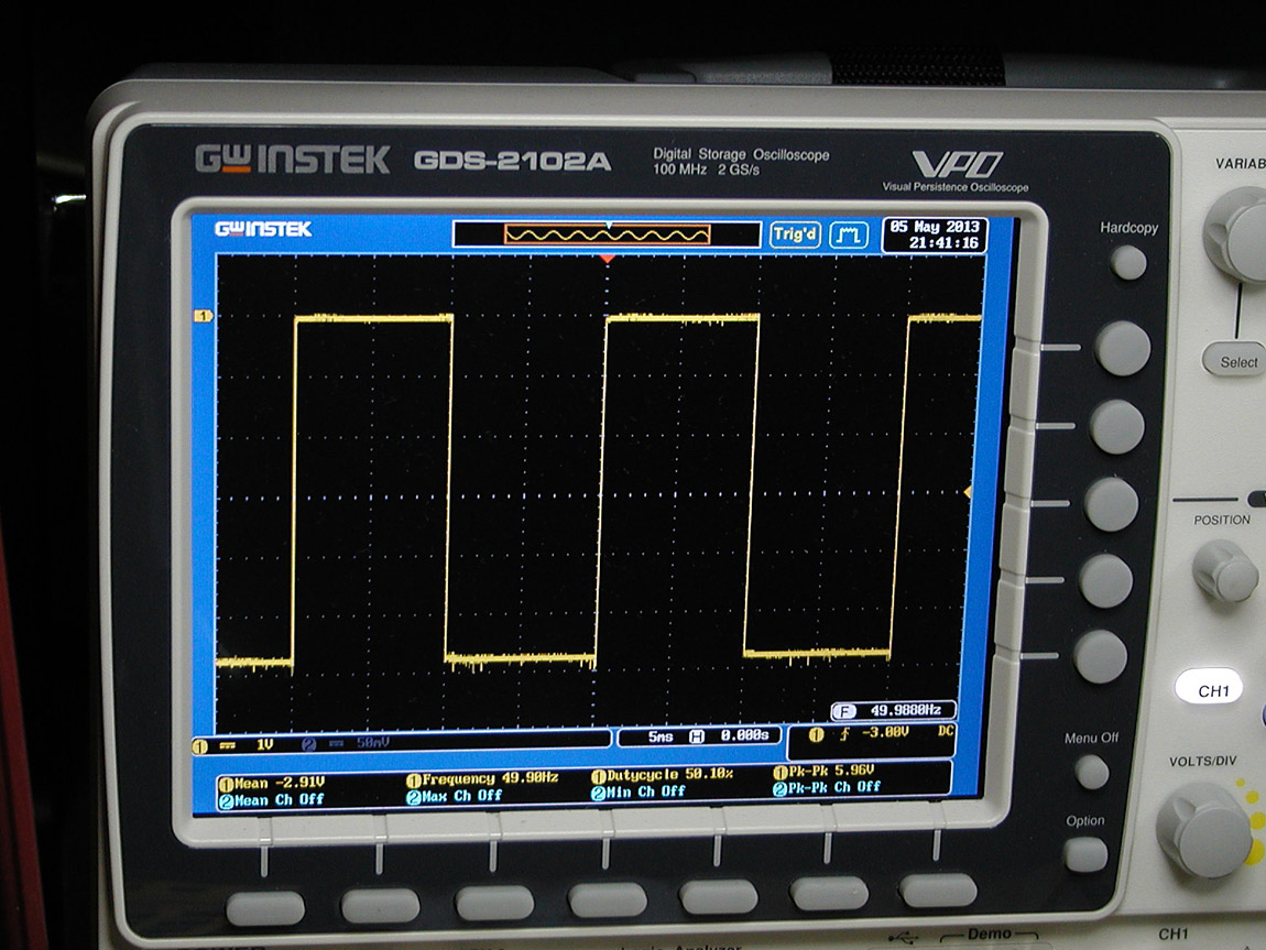

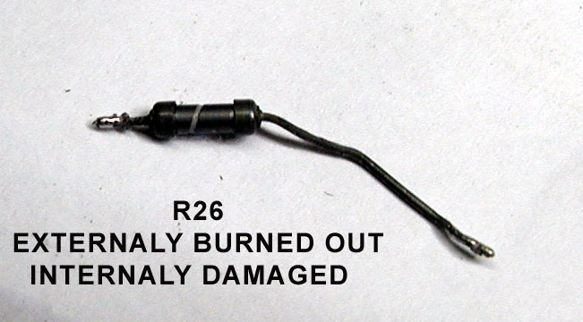

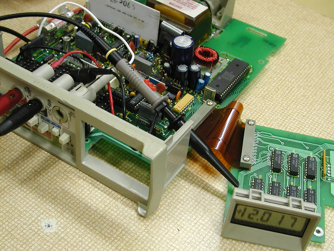

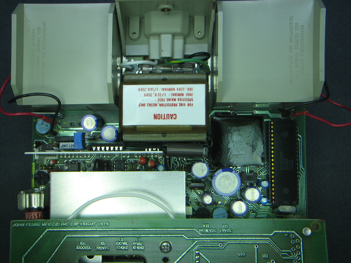

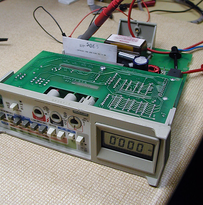

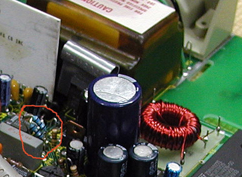

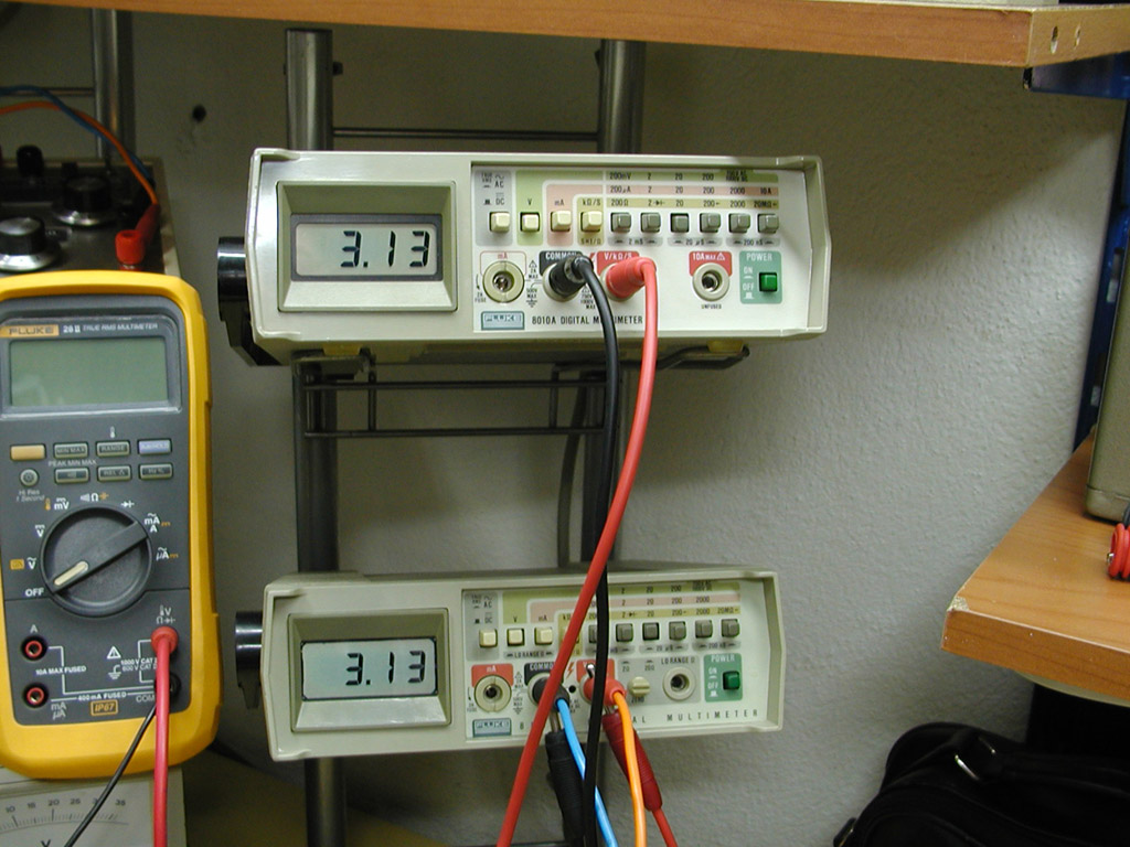

Recently I did a repair on my FLUKE 8050A bench top DMM.
I have all the available documentation and I did an complete calibration & adjustments.
Funny enough there is no info about zeroing out the display at DCV.
I get 2-3 additional counts at the last digit depending the range.
I can use REL if I need the most of it accuracy, but I was hopping for a repair tip, as it looks that this adjustment is totally undocumented.
