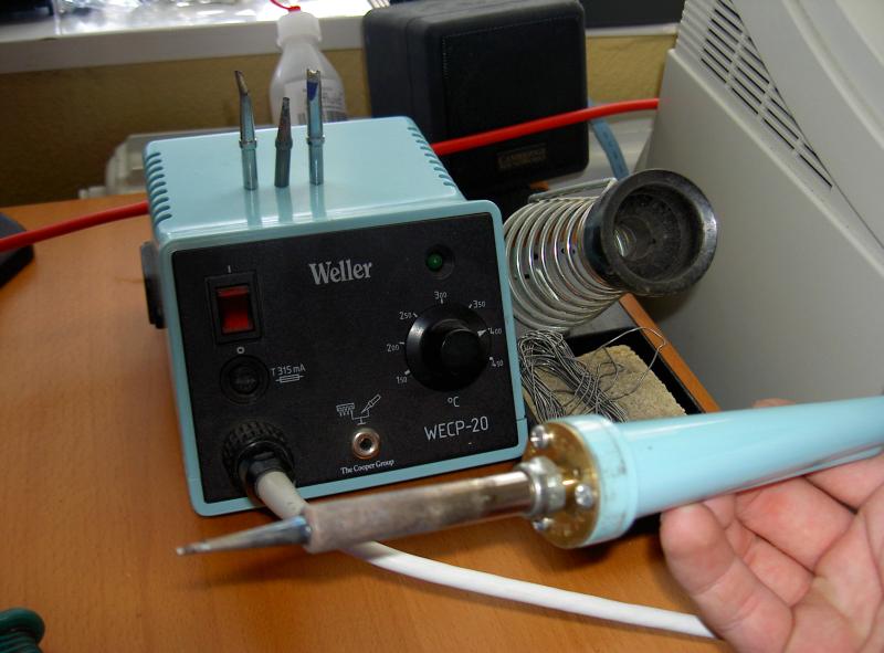

                      I use the iron in the pic, suits me well, I use a very fin tip, against the recommendation of some of the users on these forums... I think it works pretty well, though I must admit that on VRM layouts with large grounding copper planes it can be a bit difficult; but it gets the job done after some added solder etc...
                      I have a few other tips but have not really tried them out... (if it works...)

                        Thanks for the Pic. Just found out I can get the Pace ST-50 with PS-90 Iron and Stand for $230. Think I'll take that over the Weller WD1002 for the same price.
