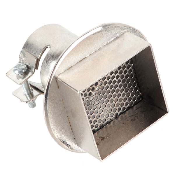

                  Got me thinking, I remember seeing a video on Youtube of someone using a heat gun in some kind of jig to remove a big BGA: http://www.youtube.com/watch?v=F3B83e0gp4Q
                  Doesn't show the setup in detail but it certainly looks like it works, he's got a thermocouple there but looks like just for readout and not controlling anything.
                  There may be some kind of grille etc inside that square pipe to reduce airflow and\or make the heating\airflow more uniform etc. No idea if it's necessary but I notice that some BGA nozzles sold for SMD Rework stations have a grille in them: http://www.ebay.com/itm/BGA-Nozzle-2...-/260913745008
                  Also, there's this: http://www.youtube.com/watch?v=ZrWRToFImbk (Stand which should work with majority of hot air rework stations)
                  But this one: http://www.youtube.com/watch?v=38IaWi7Y-Nw seems to use a hotplate for bottom heating\preheating. I have noticed the 'proper' BGA rework stations also have a bottom heater, so might be worth looking into. I think for anything this major you should probably do preheating etc.
