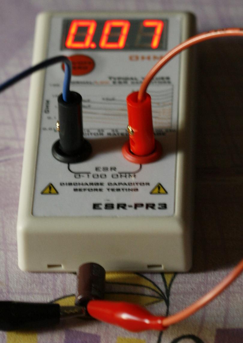

            There is an ESR-meter made by somebody here in Romania which has 2 decimals.
            It's spot-on compared with a Fluke 189, which also can measure with 2 decimals.
            Not bad for a device that costs around 30 euros, but still not as stable and calibrated against standards like the Fluke.
            Here's a picture measuring a (still) good low-ESR 470uF/25V cap, Hermei LL series.
            To add some on-topic: with a digital ESR meter you can choose the best piece in a batch of caps.

                    Re: What an analog ESR meter will and won't do
                    @ ipman: Isn't that the one from x-roast.home.ro? I wanted one myself but i wasn't sure how well it did.
                    Yes, this is the one. Works just fine.
                    I've just aquired today a 1964 analog volt-ampermeter for two bucks. Works like new, hard to believe.
                    @Longbow: such fine resolution and accuracy will be required only in very special and particular applications and caps will be expensive and big. Never seen one of these, but as far as I've encountered caps (until now) had no such low values. In usual device repairs, like monitors, TV's, motherboards, etc.
