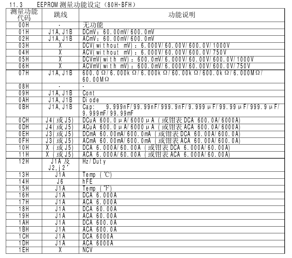

                    Re: UNI-T UT210D/210E Digital Clamp Meter
                    well the way it works is each position on the rotary switch has 4 slots in the eeprom,
                    not all are used, but a value in a slot sets the chip mode and the mode button advances through them.
                    the switch also configures the input circuits - so you can only move stuff in the same switch position.
                    for example, the first position may be volts.
                    for that, slot1 may have the byte for AC, slot2 DC and the last 2 slots empty (00) so you would swap those 2 bytes over,
                    the eeprom contains cal data - so NEVER use someone elses dump and always keep a backup of yours.
                    this will help more than your attachement i think.
