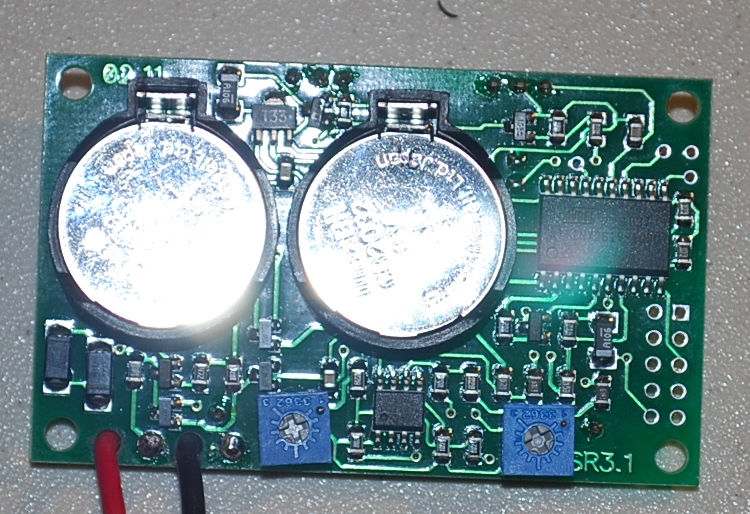

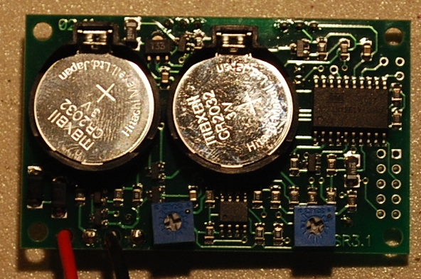

      Here are two pictures. I hope they confirm what you'd like to investigate further. I've just been told my order won't be fulfilled/sent until the beginning of September, too.
        Re: I fried my ESR Micro 3.1 ...
        Those two black rectangles to the left of the cables are probably the diodes ipman was referring to. Are they shorted?
          Never seen this one in particular, but most ESR meters have two back-to-back diodes at the input for protection against charged caps.
          seanc indicated the two SMD diodes at left, and most probably he's right. Check them for shorts.
          You can even remove them, but this will leave you without protection and at the next mistake ... you will need a new one for sure. And considering that Michael is not delivering anymore these devices ... take care of what you have.

                      For back to back diodes the same voltage drop in both directions is what we expect. Near 0.500v in both directions means neither the diodes nor any parallel device is shorted. If the diodes are shorted there's no need to remove them from the circuit. They will read shorted in both directions. The diodes would need to be removed to determine whether they are shorted or something else.

                        What else should I examine? I'm still getting zero for capacitance and non-readings for ESR. Looks like the logic chip's OK. I even tried putting capacitor leads directly on the board (where the probe wires are connected), but I'm not sure if I made a good-enough connection.
                          Weird. If the cap was charged, these back-to-back diodes had to discharge the cap. Any voltage drop exceeding the diode forward drop voltage should have opened one of the diodes and short the cap leads, protecting the rest of the ESR meter.
                          But your readings show that diodes are good. To be sure, remove them and measure them individually.
                          If you want to try, put that capacitor at the diodes terminals or afther, even better: remove the diodes and measure without them.

                                    Turns out my 1 Ohm resistor was open. It did its job very well as a fuse, and now I must replace it. The only other number I ne to follow is "0805".
