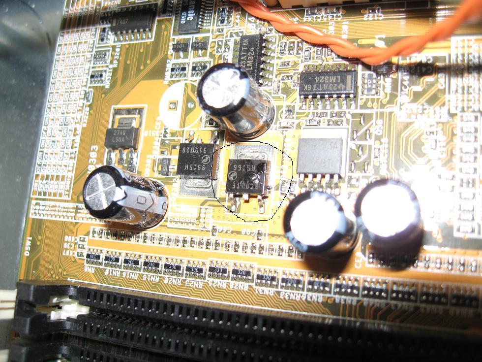

    Hello everyone.
    I have an ASUS A7V8X-X motherboard. Last night I left the computer on. When I came back to it it appeared to be in sleep mode but wouldn't reactivate.
    I turned it off and then tried to reboot and I had no POST beep, although the green power LED was lit, the drives all span and the CPU fan started up. The monitor remained blank with its LED flashing.
    I have tried resetting the CMOS, and replacing the CMOS battery. I have tried reseating the Video Card and RAM, and swapping RAM around the slots. Lastly I tried another CPU and while I was doing that I noticed a component near the CPU seems to have blown. Here is a picture of it - one of the square chips with 9915H on it.
    Does anyone know what it is, and if replacing it (assuming I can locate another and do so successfully) is likely to revive my motherboard?

    been there done that.check for bad psu/ram.
    thats the vdimm regulator.

      Woah, a fried MOSFET!

                As was said, that wouldn't be likely blow the MOSFET.
                You pretty much need a short somewhere to blow a MOSFET.
                A bad [w/short in] stick of RAM or CPU might do it.
                A shorted to ground cap might too.

                            Correction, Not likely to blow THAT MOSFET.
                            That one is for main RAM power. [Basically Vcc]
                            It [too fast of RAM] might blow the Vtt regulator and that might be a MOSFET [vice some other kind of VR] but it would be a much smaller part than the one you circled.
                            The Vtt regulator being weak is part of why those boards have restrictions on RAM.
                            Vtt is the logic signal voltage.
                            - Vtt applied = high = a logic "1"
                            - Ground [or nearly] applied = low = a logic "0"
                            The higher the frequency the more load on the Vtt regulator.
