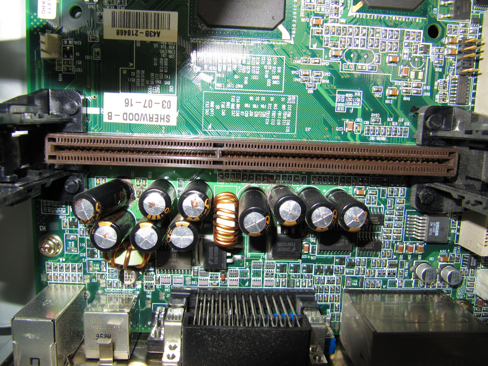

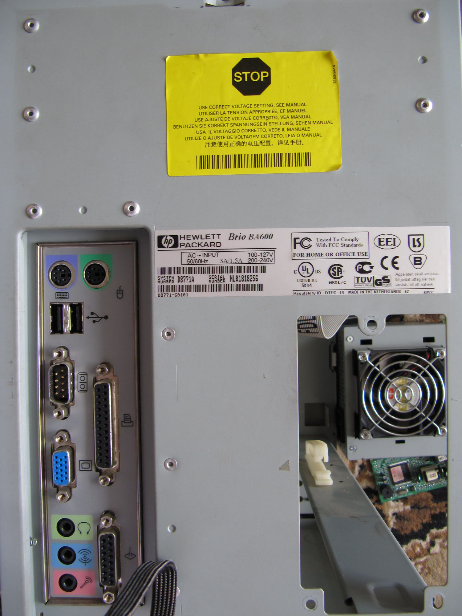

    I found it some days ago.

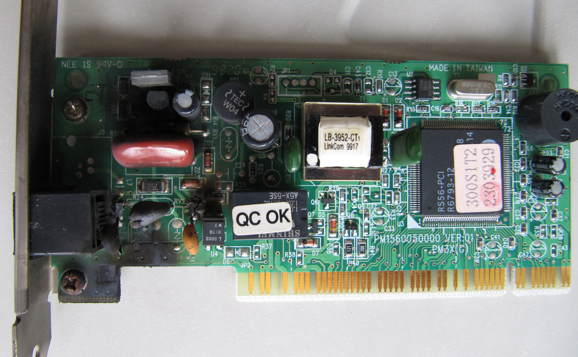

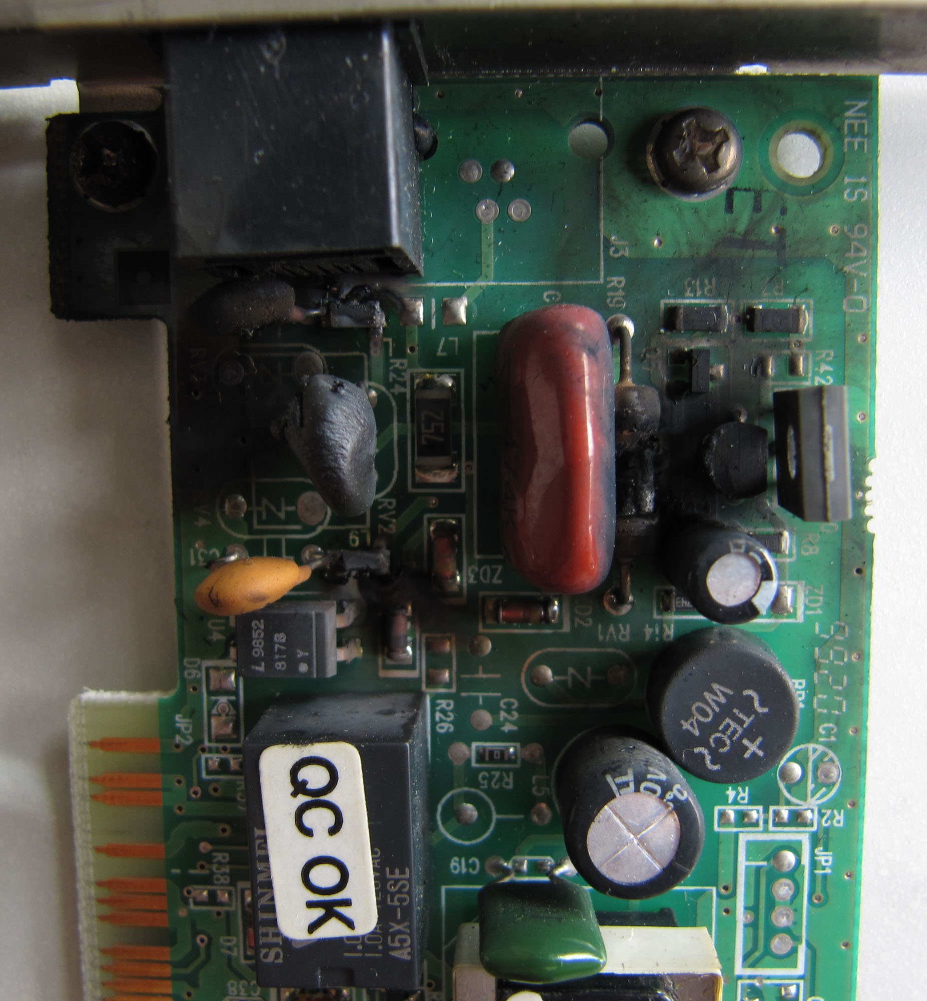

    The modem it had inside is completely burnt...
    The motherboard is full of bad caps that are not only bulging but also leaking from the bottom side.
    It had a LiteOn PS-5900-2H psu that seems to be ok.
    I would like to power it on and see if it boots.

    recap it, as those iq caps will both dry up, bulge, and leak. they are made by OST, and they seem to be even lower in quality.
    then again, it looks like a power surge went to the phone jack... ouch... but the board should be all right, it looks like the modem took the blow.

      From the looks of it that modem got fried by a lightning strike to the phone line. I'm willing to bet improper or no grounding at that homes telephone interface box.

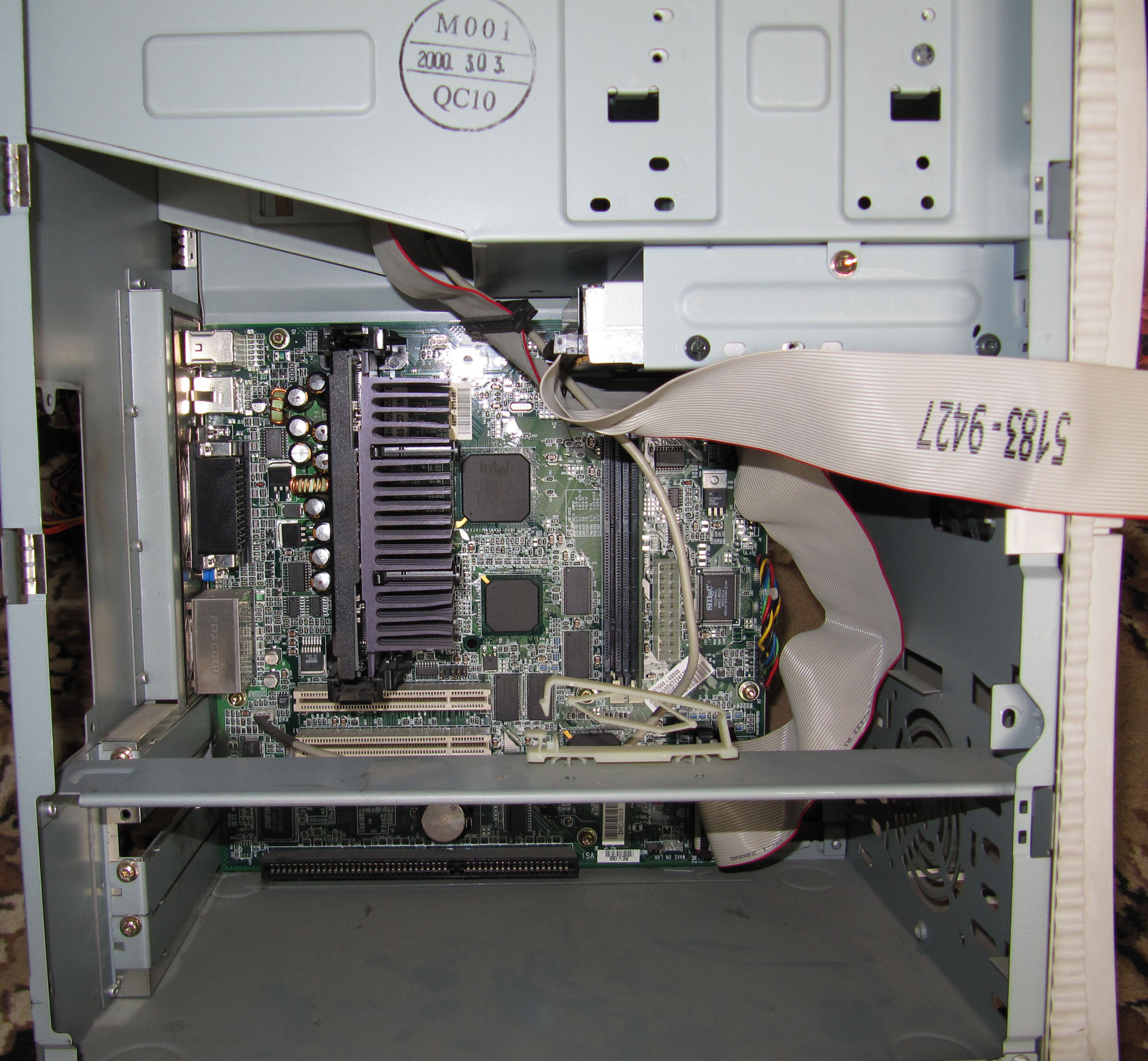

          It boots!
          It was able to boot from cd and floppy and start xp setup. Maybe, I will recap it sometime.
