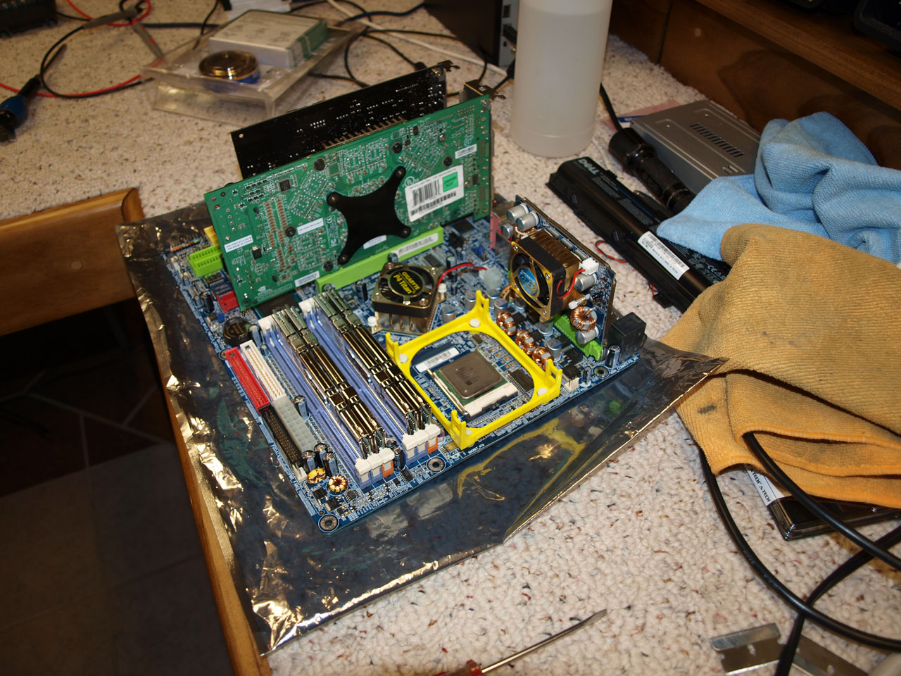

              Originally posted by momaka
              ...But now I've come to appreciate them quite a bit more.
              My appreciation comes with some of the weird enthusiast goodies that were available for them, and a crossover from the days when these things had to be fabricated versus just being able to buy! I'm mentioning this for a reason, and it'll come out later in the thread. Games that were slightly older than netburst also tended to play well on them. Q3A and UT for example (two of my favorite older games); which were playable on a P2, played nicer on a P3, and played fabulous on a P4; with a good GPU of course.
              I think it's the motherboard (well, OK, and the GPU too ) here that really sets it apart with the modular VRM module and 6 RAM slots. In case of the latter, I have not seen or heard of such a beast before. Very very interesting!
              On top of the modular VRM, there's also an onboard as well. It will run without the added VRM.... The VRM is supposed to add increased stability with the higher TDP P4's or with overclocking....or so I read....but yea, interesting feature...and the board was 100% complete, all accessories present. It also had a add-on card to allow one of the SATA ports to function as an eSATA.
              Reminds me of that one motherboard with the vacuum tube for the audio circuit. I'm sure many of you here know which one I'm talking about (sorry that I don't recall its brand and model at the moment.)
              It was AOpen. The AX4B-533 TUBE model. I recapped a bunch of those way back in the day....as if the heat of the CPU wasn't enough to roast the motherboard caps; add a vacuum tube to the mix!! That goofy board reminds me of the $1000 cable making a recording made with a $2 cable "sound better"....but apparently they're collectors' items now...they're nearly impossible to find today.

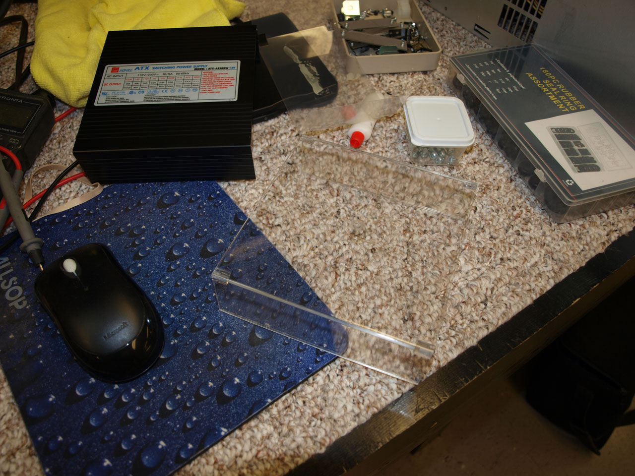

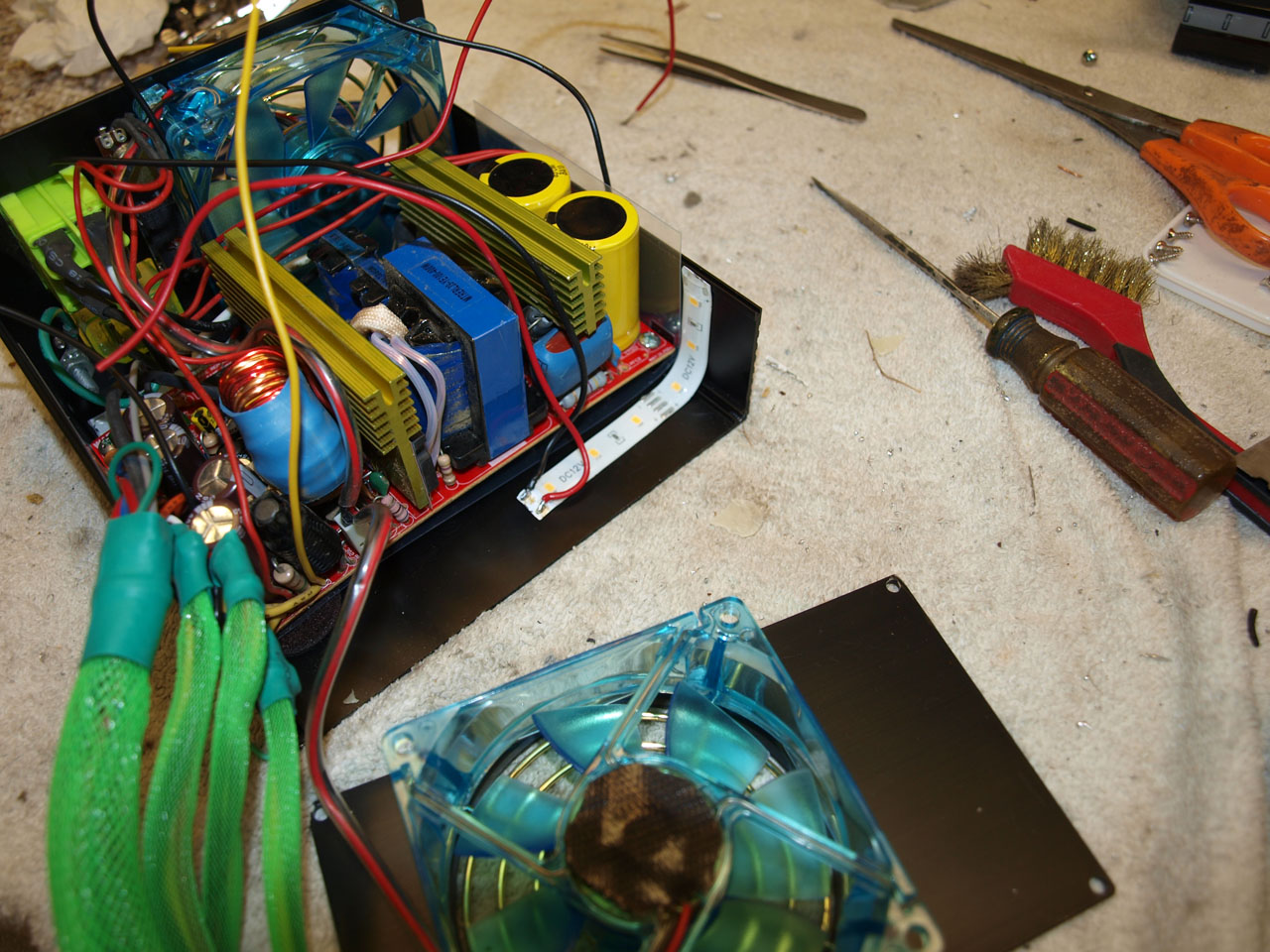

                    Today's task was to tackle the power supply that originated with this system... I have never seen one of these before (transparent case)....but lets have some fun with it!
                    It was grungy.....
                    When it came to servicing this unit, I really liked the way it came apart.....but that was about all I can say I liked about it from a servicer standpoint.
                    The build quality was fair at best.... The PCB was rather flimsy and a corner had cracked. I attribute that to the way it was shoehorned into the main part of the body as well, there are small mounting brackets that slip into a track in the aluminum, and they don't sit flush, so it stressed teh corners. Fortunately, no trace damage resulted from the broken corner, we're still good to move forward.
                    Yay, a bunch of spooged fukkyou's!! Note the one under the heatsink....it expanded itself so tightly in there, it was a real joy to remove it....I was almost forced to desolder all the FET's and remove the sink....but I finally got it loose. Also note how discolored it is....it was supposed to be yellow like the rest of them....but it apparently got very hot.
                    Fresh caps.
                    Now time for the fans. To their credit, they actually spun smoothly and the bushing sleeves had not dried out.....but I wanted to clean & repack them anyway. These were 'siamese twins'....joined at the power wire....so that made washing real fun.... There was no way to separate them without cutting, depinning, or desoldering....so I just made due.
                    Just like the day they were born!
                    Also washed the shell and the clear cover. The clear cover still had the protective film on it... Yea, I'm sure that sounds all well & good....but bear in mind it's been on there 20+ years.... Removing it was no treat!!
                    Not bad!

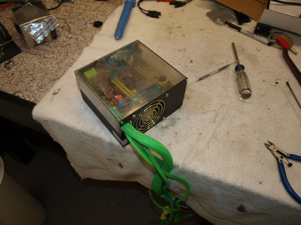

                    Now lets have REAL some fun!! Hmmm....extra wires....
                    Ohh hell no....
                    PSU buttoned up. All voltages present and some very noise-free outputs. Not bad if I do say so myself!! I've seen 'high end' PSU's making more output noise than this!
                    ...and done!!
                    Now the cheesiness you've all been waiting for!! ...and keep in mind, this isn't the end to the strangeness this build will render!!
                    The clear portion faces downward in the case, so this is what you'll see peering into the big window on the case....
                    Note the translucent power connector plug! The pics don't do that justice, it lights up in a super-cool pimptastic manner!!
                    What's under it will be nicely lighted....and it'll make more sense later on. ...but in the mean time, the power supply has been revived; plus some!!

                            Originally posted by Topcat
                            Shockingly enough, the caps in the primary side were in spec, I checked them...they were values I didnt have on hand....so if they were out of whack, I'd have had to place an order..... The only ones that spooged were teh secondary caps. I didn't look to see if they were all the same series.
                            No, the primaries and secondary caps are different.
                            Primary should be "LP" series, if from Fuhjyyu (and I think I can see that on your PSU pictures... but you can easy check by glancing through that clear window ). The secondaries were probably Fuhjyyu TNR's. They're all yellow because Apevia / YY order them this way. On my ATX-IB680W, they're CapXon KM, also in the same yellow color. Definitely custom ordered... but always terrible choice of cap brands, though.
                            I'm genuinely surprised to hear that, given the number of system's that have gone through your shop.
                            https://www.badcaps.net/forum/attach...1&d=1647636250
                            Agreed. These are great to take apart, until you get to the recapping part - the secondary side capacitors were literally an afterthought to the PCB's design. Apevia/YoungYear just shoved them all in there where space allowed.
                            What they should have done, IMO, is scrap the front fan and make the PCB bigger to make everything fit. Notice how big that main PS transformer is? It's ERL44, IIRC. The output inductor is also T130 size (1.3" diameter), which is appropriate for the power rating of the PSU. They didn't skimp on the size when it came to parts (and size does matter when it comes to half bridge PSUs. ) But the PCB layout is very sub-par.
                            Looks good... though I'm curious how that would have looked with some UV LEDs instead of the strip. I might try that on mine.
                            And if you add an LED behind/inside the power switch and connect it to the 5VSB, you'd be level 9999 pimp
                            Indeed...the sink is less than impressive for the GPU chip itself, but the RAM chips are very well cooled...I picked up on that as well. I am not going to uograde it like the one in the other thread apparently was....this thing won't be ran much, honestly....I'd prefer to keep it original. I did a quick ebay search for that Zalman cooler....just for grins. None to be found.
                            Yeah, I know what you mean here - indeed it's also cool to keep the card with the stock cooler, just for the originality of it.
                            And yes, those Zalman coolers pop-up very rarely on eBay. Takes regular checking for it to find one. I think some older MSI gaming cards came with one (IIRC, HD4850/4870 cards), so could get one broken just for the cooler if you really needed it.
                            Or maybe with your luck, someone will just drop one off for you for recycling this week?
                              I'm not done yet....but the clearance was tight around the switch...but I bet I could make something fit.
                                Yup, +5vstby indeed....I figured that out when I saw how 'overdone' it was compared to the others....and then of course looking at the circuitry in its path. Makes me wonder what the inside looks like...
                                I forgot to mention in my previous post: that resistor next to the 5VSB cap looks like it could have contributed allot to it as well?
                                I also moticed something else funny in the same picture: the fuse is heatshrinked but not over the glass.
                                I guess the OEM of this thing must like glass sharpnel flying everywhere in their nice plexi glass
                                Also forgot to mention another thing that crossed my mind:
                                Those LED's you installed are very near the primary side.
                                If anything comes loose there and touches the high voltage it would end very badly...

                                  Re: Topcat's Ultimate Pentium 4 Retro Gamer!
                                  The fan is actually pinning that in place by a good half inch (note the direction of the wires) and everything is tied up well. The exposed terminals aren't going anywhere, the rest is encased in the rubber coating. I actually thought of that. If they came loose, there's really noplace for them to go.

                                    I ordered a couple new 40mm fans for the northbridge and for the secondary VRM. They actually came with the heatsinks....they were new. Since one fan on this system (VRM fan) was wonky, I just went ahead and replaced them both....if nothing else, so they match.
                                    Old fans removed & disassembled.
                                    The next round of fun was swapping the plugs over....
                                    ...and done! Two fresh new fans! Yes, I did grease them even though they were new.
                                    Now for her to reveal one of her well kept secrets. This was an inadvertent find when scouting a new heatsink/fan. I really wanted to use this Zalman Heatsink & fan on this build, but this Gigabyte has too much jazz packed on it, there was no way it could fit. It hit the VRM on one side of the CPU and hit RAM on the other. Not even close enough to modify...so that got quickly scrubbed....and I was looking for an alternative to cooling besides the yawn yawn boring Intel stock coolers....and I stumbled upon this; which is why I mentioned the long lost PC enthusiast base from this era.......because here's what I came up with!
                                    A Zalman ZM-WB4 Plus water block for a socket 478! Now we're talking! I didn't think any of these were even left.... Finding one new old stock apparently not an easy feat....and it didn't cost much; $26 IIRC.
                                    Alright, I know what you're thinking....water cooling is not a big deal today....you can buy prefabbed coolers all day long, all self-contained units...just plug them in and go.....so why is this significant? The last CPU I liquid cooled was a Pentium 3 750/100 @ 1GHz/133 in an Asus CUVX4-E....not really a big deal today; a whopping 250MHz overclock (coppermines were awesome overclockers if kept cooled)....but at the time, the P3 @ 1GHz was astronomical in price versus the P3 @ 750... Be that as it may, here's the fun part....you couldn't just go buy water cooling gear back then....it all had to be fabricated... Pumps were no biggie, those decorative back yard pond pumps worked great. The radiator wasn't a big deal either, I used a heater core out of a Mazda pickup. The greatness came in the form of the water block made to fit on a socket 370. I was lucky enough to have a friend who's dad owned a machine shop....and not an engine shop.... He did design & fab engineer work for a local manufacturer and had some wicked tooling available. Long story short, he fabricated a water block from copper not only for flow & cooling but also so it could be attached to a S370 using those two stupid little tabs on the ZIF socket. He welded 2x 5/16" fuel line barbs; input and output into the block....and turned it over to me and told me to figure out the rest....and I did! ...and my first (and only) water cooled system was born... This was maybe 2000-ish.... I ended up selling the system to his son (my friend) for what I had in it; he wanted a gaming rig....and after the fab work his dad did (for free), I would feel like a jerk making money on it....so I gave it away for cost. IIRC the GPU was a Radeon 8500. I ran it for about 5 months and never had a bit of trouble out of it.
                                    Ok, fast forward to today....I've done a few pre-fab liquid cooled rigs for customers here & there....nothing to write home about...and no, nothing will ever live up to the hand crafted water block of decades past.....but I'm going to make a little attempt at it anyway....and this is the start!!
