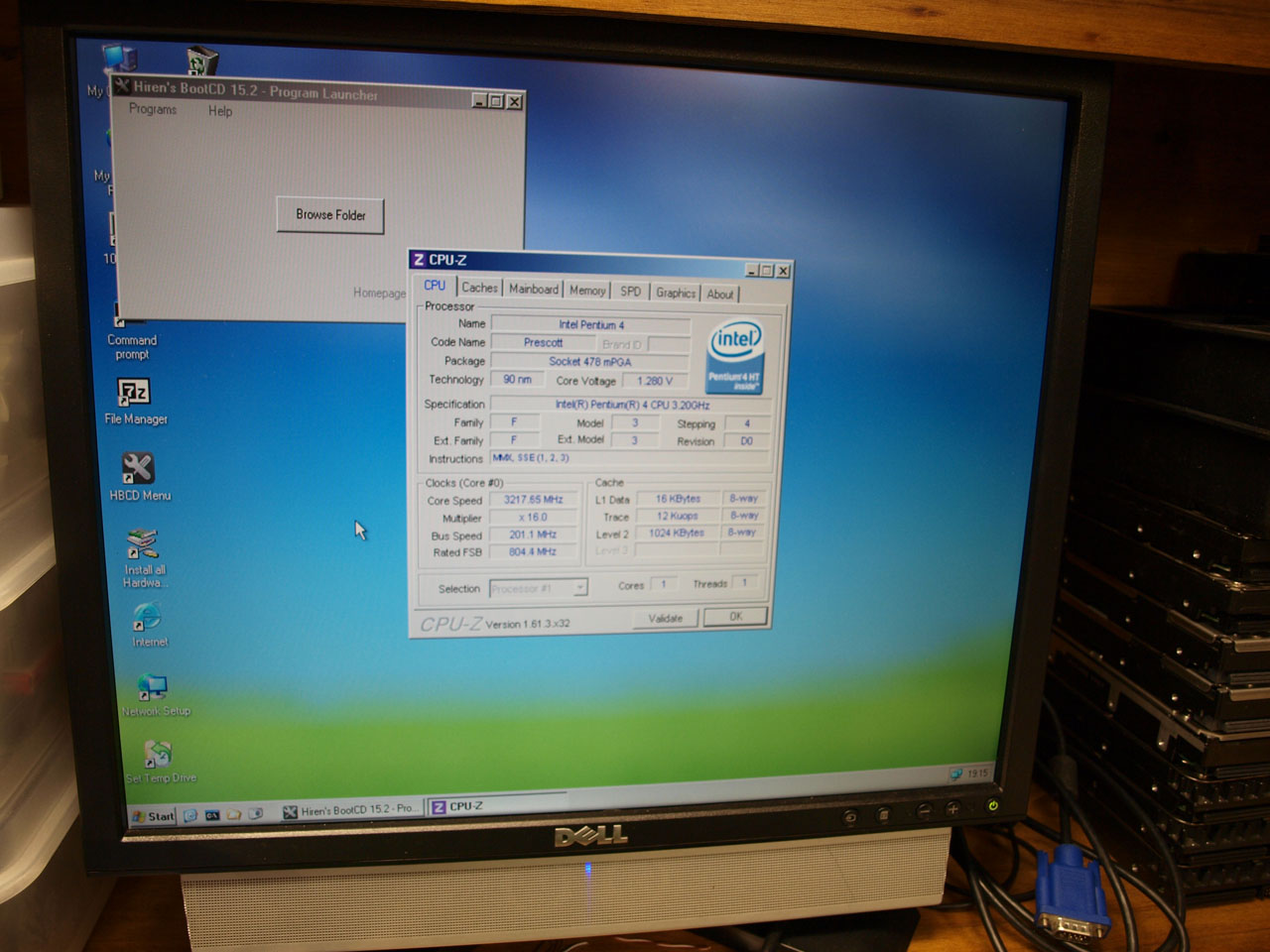

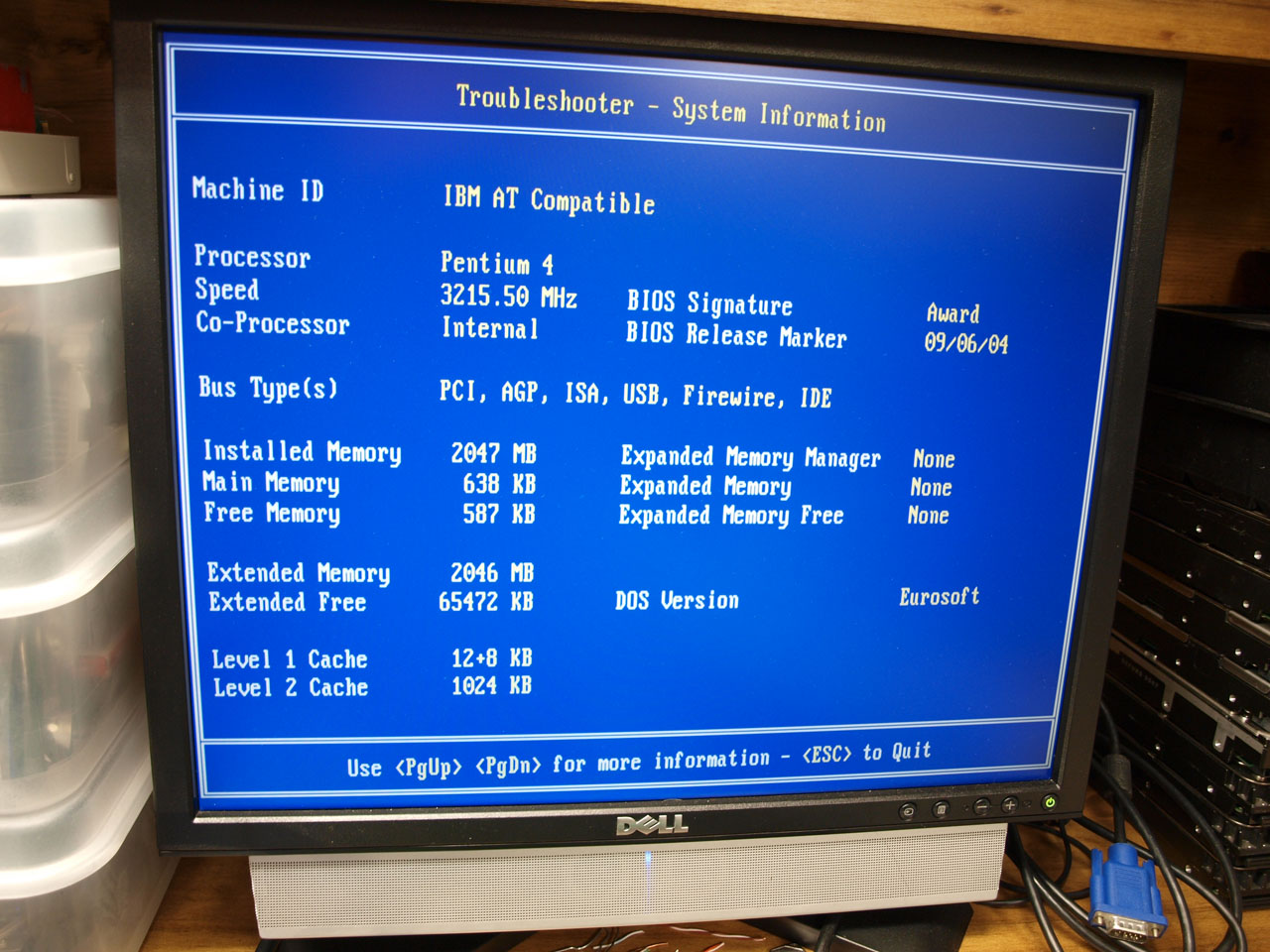

      The mailman brought a package from China today, it was the Prescott P4 @ 3.2GHz. Testing it out, and it worked. I'm also testing the keyboard & touchpad out for aother ongoing project.... I got a couple of these in a junk box from someone....the other one works and has already been put back to use. This one has been sitting....but it's time to see what it's all about....and it works like a champ!
      Yeah baby!!
      Booted from Hiren's XP, life is good!!
      I've never tried overclocking a Prescott, or really any P4 for that matter....so I don't know how receptive they are to it....but we'll find out when this one goes together!
              nice, i see it seems to be a 1.3v stock vcore part so u may be able to get some overclocking headroom out of it. stock vcores for prescotts are in the 1.2 to 1.4v range. the only p4 prescott i have is a 3 ghz cpu with a high stock vcore of 1.3875v. wont overclock even 5 mhz off the fsb without crapping out in any stress test. bum chip! not overclockable at all to me!

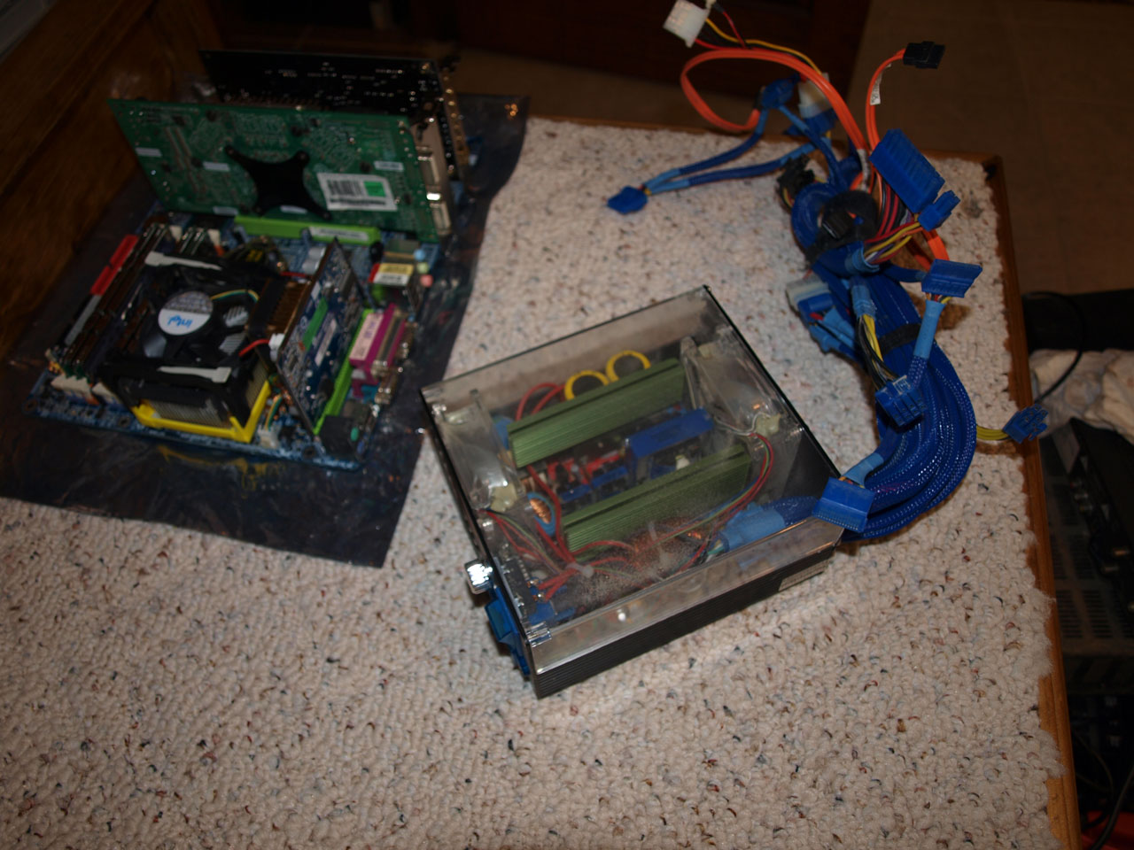

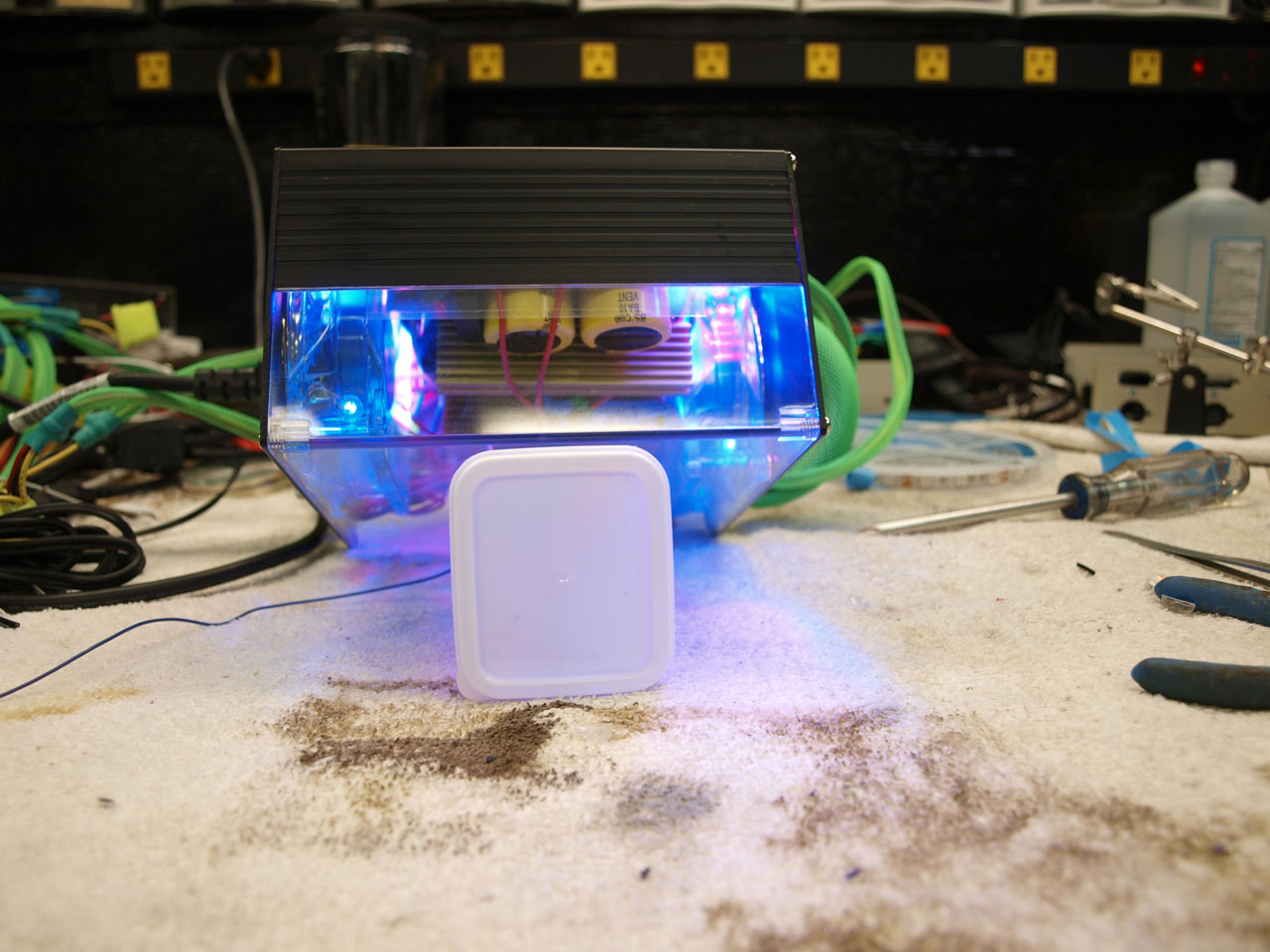

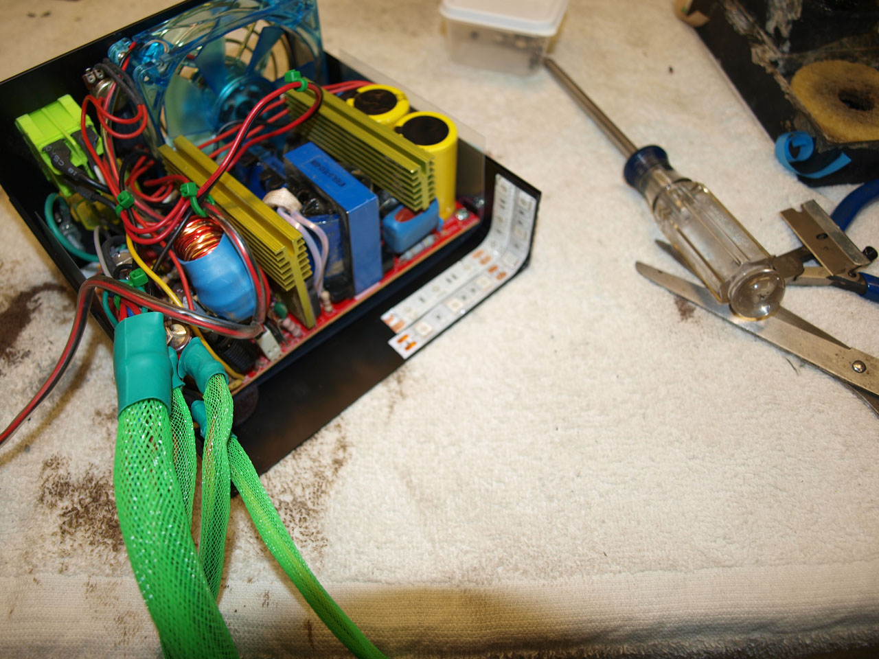

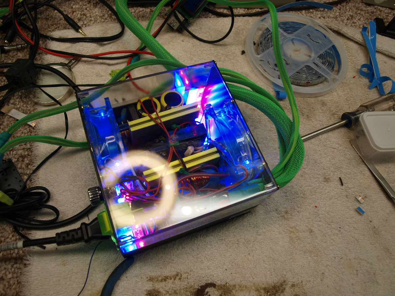

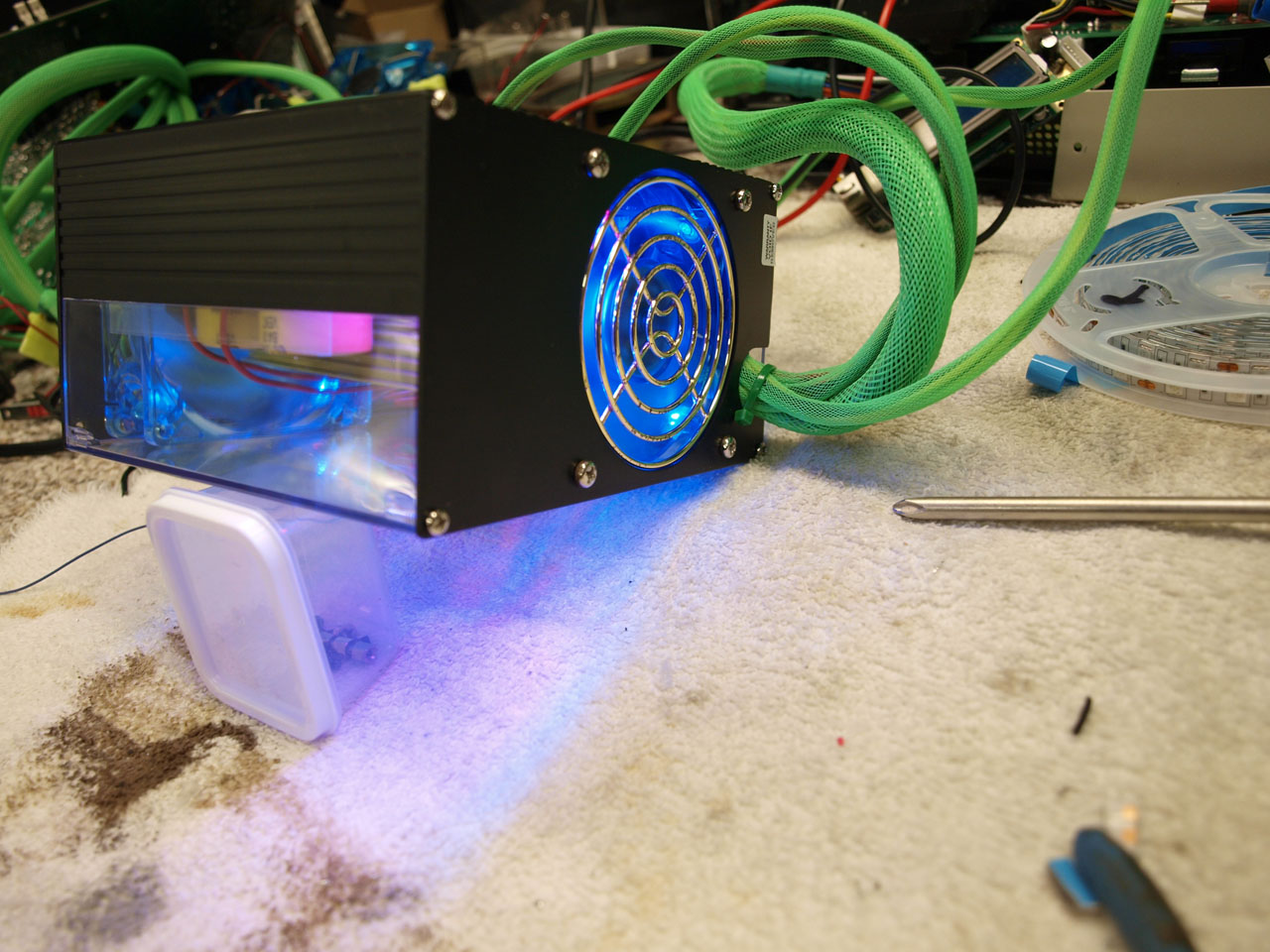

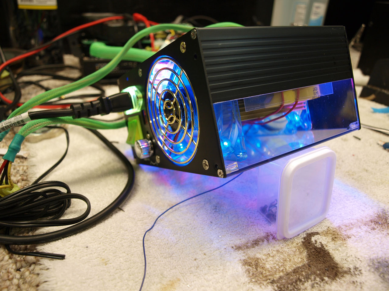

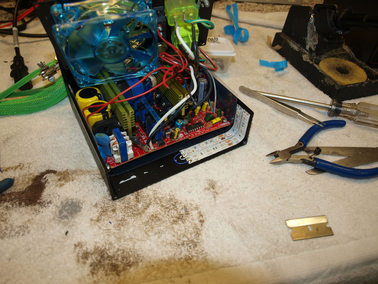

                Ok, a little version 2 of the lighting in this PSU.... I wouldn't have normally taken it apart just for this....but I'm working on another one for someone else that's similar to this that has other weird problems beyond capacitors.... I wanted to take some measurements & look at some components....and well, I had the red & blue LED tape; plenty leftover from another project.
                Anyway....I removed the white LED's and did a strip of blue and a strip of red down each side where the white was. The output side:
                The input side:
                Reassembled. This is what you see with a direct view into it, which in even a windowed case you won't get this kind of angle....
                This is more along the lines of what you'll see:
                Much bolder & better lit for as ricey as this build will be; this is only the beginning!!

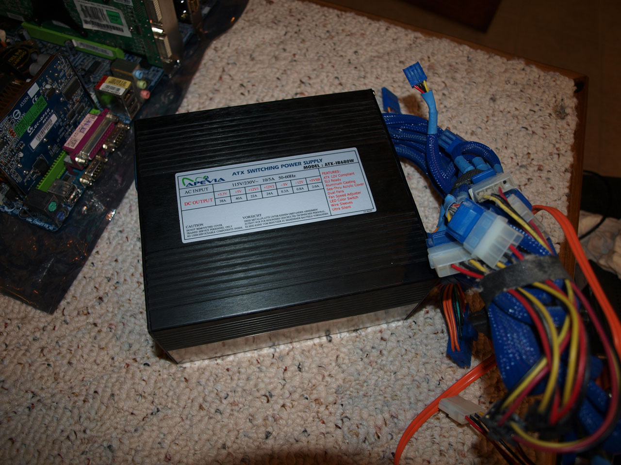

                    Well, I heisted the Apevia PSU from this build to use in a genuine Apevia case in THIS BUILD....but worry not, I tracked down another one just as goofy; another Apevia I found on ebay. THis one is rated @ 680 watt. I noticed the heatsinks are a little longer and the main transformer is a little bigger (I haven't checked the numbers). Also has lighting that the color can be selected; red, blue, or green....yippie!! It's in fabulous condition, just dirty. It needs a recapping, but I did pretest it, and it works. There was a 'make offer'; and I offered $20....I don't think I've ever had an offer accepted this fast!! I literally hit 'submit', got up to take a leak, and when I got back the offer had been accepted! ...and the shipping was free.
                    Next is to rework it.

                      Could be a 40 or 42 size transformer (did any manufacturer ever go past 40?) which is rather surprising. Some of Leadman/Sun Pro units also did that from what I recall. Small BJT and standby transformers but the main one was some EI-40 monster (and I have desoldered one to actually confirm this) and the heatsinks were rather thick. Similar in design to momaka's RX-380K but much thicker than his. Oh, and either had
                      TO-220AB 13009s or D304X.

                        Originally posted by Topcat
                        This one is rated @ 680 watt. I noticed the heatsinks are a little longer and the main transformer is a little bigger (I haven't checked the numbers). Also has lighting that the color can be selected; red, blue, or green....yippie!!
                        Well the lighting makes ALL the difference, without that it would be rated for only 180W continuous

                            Considering most of the parts do look really big (from main caps all the way to the main transformer and output torroid - the last one is a thicc ass boi I see), I would do a recap on the secondary and then have fun with it.
                            As cute as the yellow caps may look, they're crap at best. Primaries can stay, since Apevia didn't invest in APFC (or even a PFC coil, for that matter.) so even if they're Fuhjyyu or Capxon, those rarely go bad on the primary. 5vSB onwards though, that's where the would start from, at least for me.

                              Yeah, the listing probably had an auto-accept set to $20... so it seems you nailed it for the lowest auto-accept price the seller had. That's not bad at all! I think someday these could be highly collectible for anyone doing retro builds. Not many of them floating around due to bad caps... at least until someone finds an old forgotten "gaming" PC in the attic of their house and puts the parts for sale on eBay. In my case, I got the same 680W "ATX-ib680W" model with same selectable tri-color output for the price of....
                              $9.40 shipped to my door.
                              It was dusty, but the caps in it were still good, surprisingly. I pre-emptively recapped it, of course. Just haven't posted it on here. And the pictures have been sitting on my PC since April of 2021!
                              44 size on my ATX-ib680W.
                              And yes, it is a real 44 size: measures 44 mm at the top, as it should.
                              Apevia didn't do too bad of a job with these PSUs, to be completely honest, at least in terms of component sizing. Where they goofed is the secondary side - extremely cramped and messy. They should have ditched the rear (front, actually) fan and used a bigger PCB... and with proper stand-offs. But apart from that, these are actually solid PSUs.
                              Not the ATX-ib680W. Both the driver and 5VSB traffos are proper height and 19 size core.
                              Oh, and either had TO-220AB 13009s or D304X.
                              TO-3P parts on both my ATX-ib680W and ATX-As520W. The latter is posted here already if you do a search, but I never finished the recap, if I recall correctly.
                              That would be the double and tripple -fan PowMax units with all of the LED fans. I forgot the model on these, but JhonnyGuru had one in a basement roundup review, and the unit did hilariously bad. I don't think it even managed 180W IIRC. It really was BAD.
                              The 5VSB is a must. It's a 2-transistor self-oscillating design, alas without a critical electrolytic cap on the primary. But still, when the 5VSB output caps go, silly things can happen. Here, I had to dig out my ATX-As520W thread to show it:
