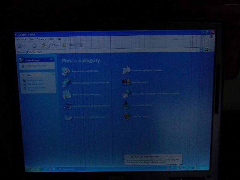

            Here's a picture the seller sent me if that helps...

              I have an IBM LCD 17" monitor doing the same thing. I scrapped it out. I narrowed the problem down to the video processing board.

                Basically this one's a no-go isn't it?

                  So from that picture do you guys think it'd be viable if I buy it? Or are the costs of fixing that screen gonna end up more than the laptop itself?

                    You should be able to go to dell's website and get the service manual for that laptop. Flip through it and find the part numbers for the motherboard and the LCD panel. Check ebay to see how much parts will cost. Worst case scenerio would be replacing the entire mobo. Best case scenerio it's just the screen or connector. If you can get the entire mobo cheap enough from ebay, I'd say it would be worth picking up.

                        I have seen many screens that do that, and it is the conroller board behind the screen that was going out.
                        Ask the seller if the lines change, appear random, are always the same lines. If the lines are always in the same spot, it is most likely that the screen just needs replaced.
                        When the screen does random stuff, and lines jump all over the place, typically that is bad GPU, or GPU ram. If that is the case, majority of the time that means you have to replace the Mobo, and it just isn't worth it.
                        You also want to consider how much a replacement screen is going to cost, and see if it is worth it.

                            That's almost a T-CON but more intergerated into small panels (smaller than 24"). Once that fails, it's scrap since due to cost reasons the "T-CON" is bonded to the column drivers.
