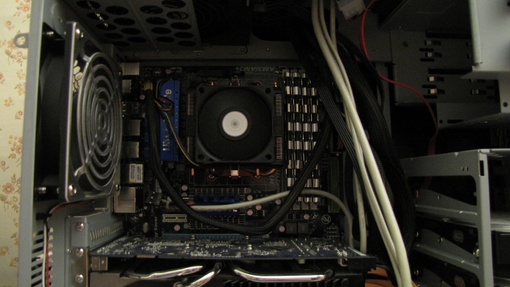

    I have a Phenom II X4 955, and the stock cooler is too loud for me.
    I have the Noctua NH-U9B SE2 in mind as a replacement, But I don't think it will clear my RAM. My motherboard is a Gigabyte GA-MA790X-UD4P, and I have all 4 slots filled with Mushkin RAM that has heatsinks.
    Any of you guys know of a cooler that would work without too much hacking?

                    I just noticed something odd. According to the hardware monitor, both my case and CPU temp are about 49 degrees. How could the CPU be anywhere near ambient temp with the stock cooler? It has to be wrong, because the CPU fan slows down when I remove the side cover from the case.
                    I have a hot fanless Geforce 9600GT, which is probably why my case temp is so high.

                        Looks like his is the smaller heatpipe heatsink AMD provides with their higher end processors.

                          It is indeed a heatpipe. I'm wondering if what I really need is better airflow through the case.
                          The case has 3 120mm fans running at 1000 RPM or so. There are 2 in the front with filters, and one in the back. Hardly any air goes through them, considering the size.

                              Are you referring to the stock cooler, or the Rosewill one?
                              The stock one does have a copper base if I recall, but it is too small and has poor airflow.
                              Do you have any recommendations for something that will fit, and still be able to clear my RAM chips?

                                  The one in the picture is the stock one, which I am currently using. That is the one I referred to as the down flow.
                                  The Rosewill would blow down towards the video card or up to the PSU, depending on which direction I install it.
