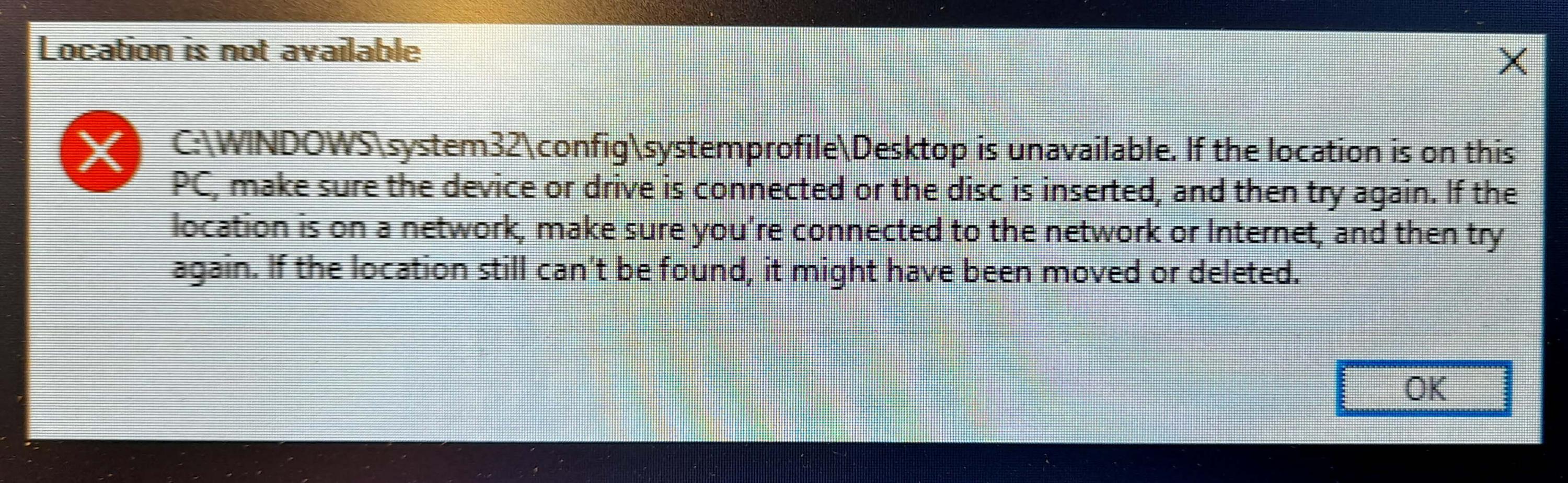

    Hi All,
    I am trying to fix a friends PC that originally had W7 and then was 'upgraded' to W10. It now wont run properly. I have tried repairing it by Windows recovery but it just gets stuck and hangs. Booting from W10 installation disc also hangs.
    On the same PC I have now installed W10 on a formated HD and have connected the damaged disc which now appears as F:
    Is there a way I can repair the original HD W10 installation remotely in this configuration?
    If so what would this technique be called?

                  Re: Fixing a broken W10 disk remotely
                  I ran the boot repair app once again and it reported that it had fixed the problem.
                  I rebooted the original disc and ended up with the same issue where I can log in using an administrator account.
                  The desktop appears along with the message below:
                  If I click the OK in the message it just repeats.
                  Clicking on the Start button does nothing. Same with the task bar search box.
                  The only way I can shut down the PC is via CTRL+ALT+DEL
                  Tomorrow I try repairing the HD from the W10 installation disc.
                  AAMOI why the different SATA port?
                      OK I think i'm getting there, I managed to replace the missing Desktop folder.
                      I can now navigate to the user files and copy them off. The Windows install is pretty crippled so once all the files are copied off i'll format and reinstall W10.
                      Many thanks to all.
