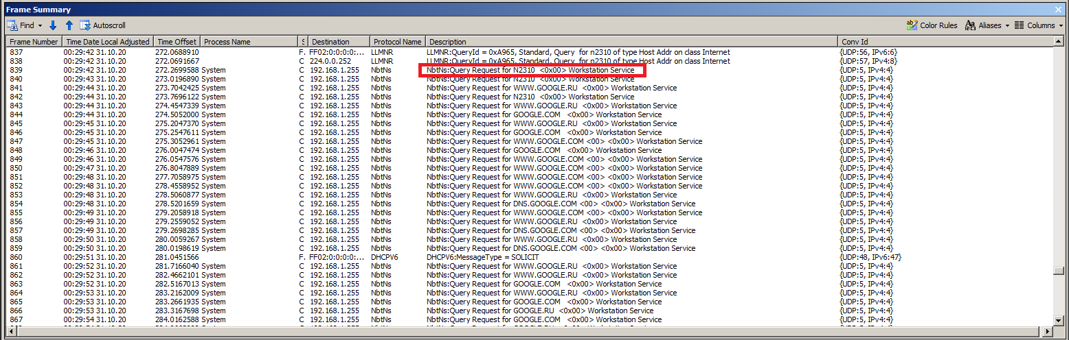

    I have an old NAS, Thecus N2310 with PowerPC 465 CPU @800 MHz
    There is a teardown https://www.youtube.com/watch?v=L3z3A9Tk8X4
    I have experienced frequent problems with system corruption, resulting in emergency and temporary repair and I thought to check the CR1220 battery, similar to computer motherboards, which was outside the parameters with a voltage of 2.5V.
    I have already replaced the battery, but I can't start the NAS to continue with OS6 installation or reinstall procedure.
    Although there are methods specific to the manufacturer to rewrite the firmware, I failed to do this and, similarly to computers, I think that there should be a method to force the writing of the firmware or the start of the writing sequence.
    Can you give me a solution to revive this NAS?

      The firmware is stored on the Micron nand flash: https://techplayboy.com/10959/thecus...rage-review/4/
      There is a procedure to force write firmware:
      http://esupport.thecus.com/Knowledge...27-usb-upgrade
      But I think the process cannot start because I used multiple usb flash disks without success.
      And I keep thinking that maybe I can get him to start reading the USB flash somehow...
      LE:
      I verified with a backup hdd but is not initialised, does not spin at all. I also suspect that the USB flash disk is not detected because the boot procedure is not initialized.
      Anyway, I'm intrigued by the LAN led and power led continuous activity. I think that only trough LAN port I could force a write but I can't figure out how, if a device is not identified by the router.
      LE2:
      I took courage. I thought of connecting my NAS directly to the computer. I captured the activity with Netmonitor3 and I see that the NAS is identified. But I don't know how relevant the information is. What is certain is that it is detected and there is a chance to be accessed, to receive an order through a protocol accepted on etehrnet ...

        The LEDs associated with the LAN may be driven entirely by hardware. I.e., they may simply reflect the signals detected on the network connector. Don't assume the processor is actually involved.
        You can use a network monitor to see if there really is any traffic originated by the NAS -- best done on a quiescent network, though.
        LE2:
        DHCP, BOOTP (simpler than DHCP so present in older devices), TFTP are the most common protocols relied upon for initializing "appliances" -- because they are low level and don't rely on a full stack to function correctly (less code to go wrong).
        You can watch for this sort of traffic on your network (start the analyzer BEFORE you power on the NAS so you can see EVERYTHING that it may be emitting).
        Once you have the firmware functional, you'll have to see how to coax the NAS into accepting it's "software".
        As that software will likely be stored on one (or more) disks, it's usually wise to image the disk after the NAS is working properly; this makes repeating the process a lot easier (just install the image on a new disk using another computer!)
        Damn near every NAS that I've owned has had a different procedure for reinitializing the software (after replacing drives). Taking notes helps to give you clues for the next NAS you end up annoyed with! :> Restoring images is a sort of universal way of avoiding the hassle.

          Thanks for this very valuable information . I will move on to experiment as soon as possible.
          Unfortunately I have 3 disks with previous images but none can start the NAS. It is not actually physically turned on.
