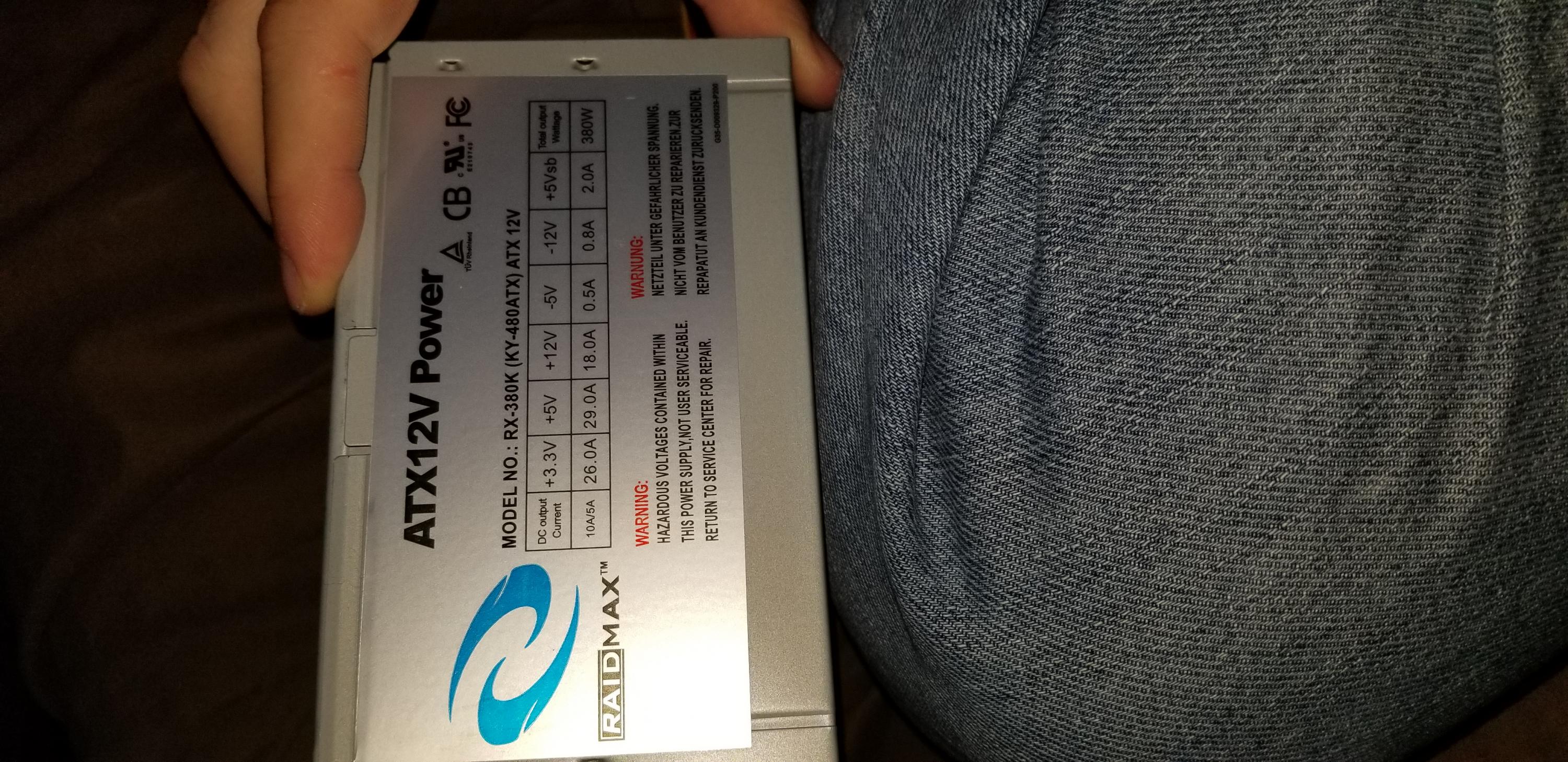

                      Oh my god guys, it's been so long since I built her that system (haswell celeron), the motherboard was a MSI pro, solid.
                      But the case, I recognized. It was an old one, I don't remember putting it together, but now that I looked the cpu up on my newegg history. I got the parts 4/10/2014
                      The case wasn't ordered from newegg. Must have been one I had around, with the power supply too. I recognized it as the same one another customer of mine that after eight years before the fan seized and caught fire
                      May I present...after six years...an oversight of mine an rx-380k (and yes LOL I see the four diodes instead of a rectifier).
                      Still I can't deny how long these lasted. Eight and six years. Luckily this one died with a pop and not smoke. Was a low wattage, but still.
                      Put an antec 380 in there to hold her over.

                        Oh yeah if you notice, a small cap popped, one next to the bloated one

                            Dude, this thing is beyond gutless. The diodes in place of the bridge rectifier are least of its problems. Look at those tiny output caps and toroids! I don't even want to know how much ripple this was outputting... or EMI/RFI for that matter. Looks like the 5VSB went over-voltage, making that cap burst (which is the second 5VSB filter cap.) Be glad it didn't take out the mobo.
                            Yes, it's a miracle those PSUs survived that long. But really, I wouldn't put that even in any of my own PCs, let alone someone else's. With that said, I do have one of these RX-380K PSUs as well (acquired from replacing a family friend's desktop PSU over a decade ago), except mine is made by Sun Pro. Still gutless, though. I removed some parts from it and disabled it from working, so that no one can mistakenly take it and use it again. I also used the 5VSB circuit to drive a flyback traffo from a CRT TV for some high voltage fun.
