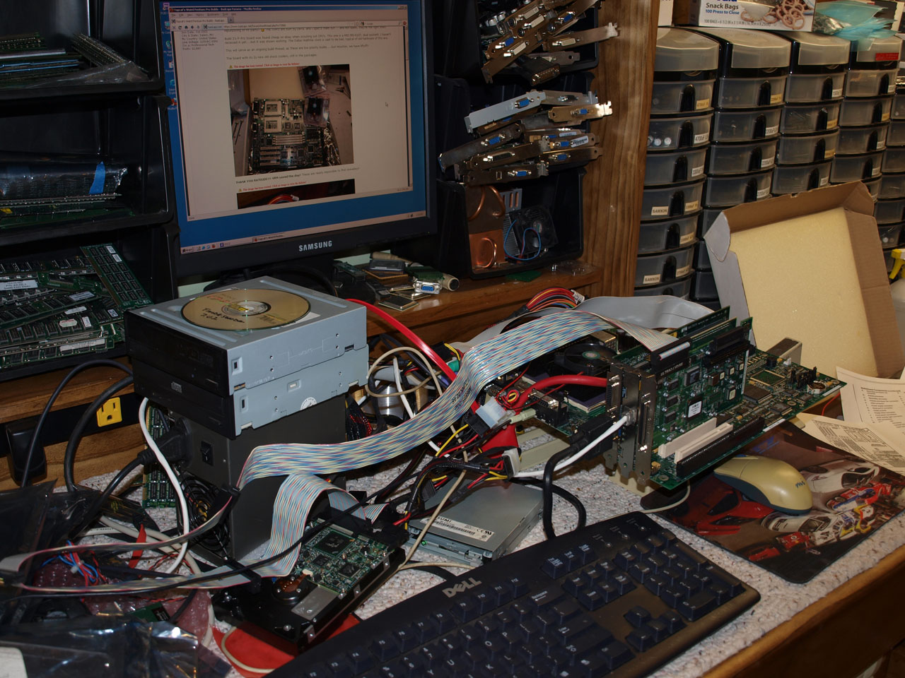

    No vintage pentium classic era collection is complete without a Pentium Pro system, well this thread is a 2-fer build....
    Both builds are keeping true to my form, they are nothing less than dual CPU's. I picked up motherboard one (Intel PR440FX) from a local junk pile. This find was completely inadvertent....I wasn't even remotely looking for anything like this, it just happen to be there...'new old stock', and untested. I bought a pair of 200MHz 512k CPU's & 512mb parity/buffered ECC EDO DIMM's to test it....the board was good...but there was a problem.... A VRM was needed in order to run a second CPU.....and this is where it gets good!! Remember that unrepairable Intel dual P2 board Ratdude gave me? Well, I bilked the voltage regulator chip off one of the VRM's for THIS BUILD...but there was one left....this unrepairable board has now saved 2 other boards through the repurposing of its parts!! The VRM's are built by Delta, and I spec'd them out.....and hot damn, they're the right ones!

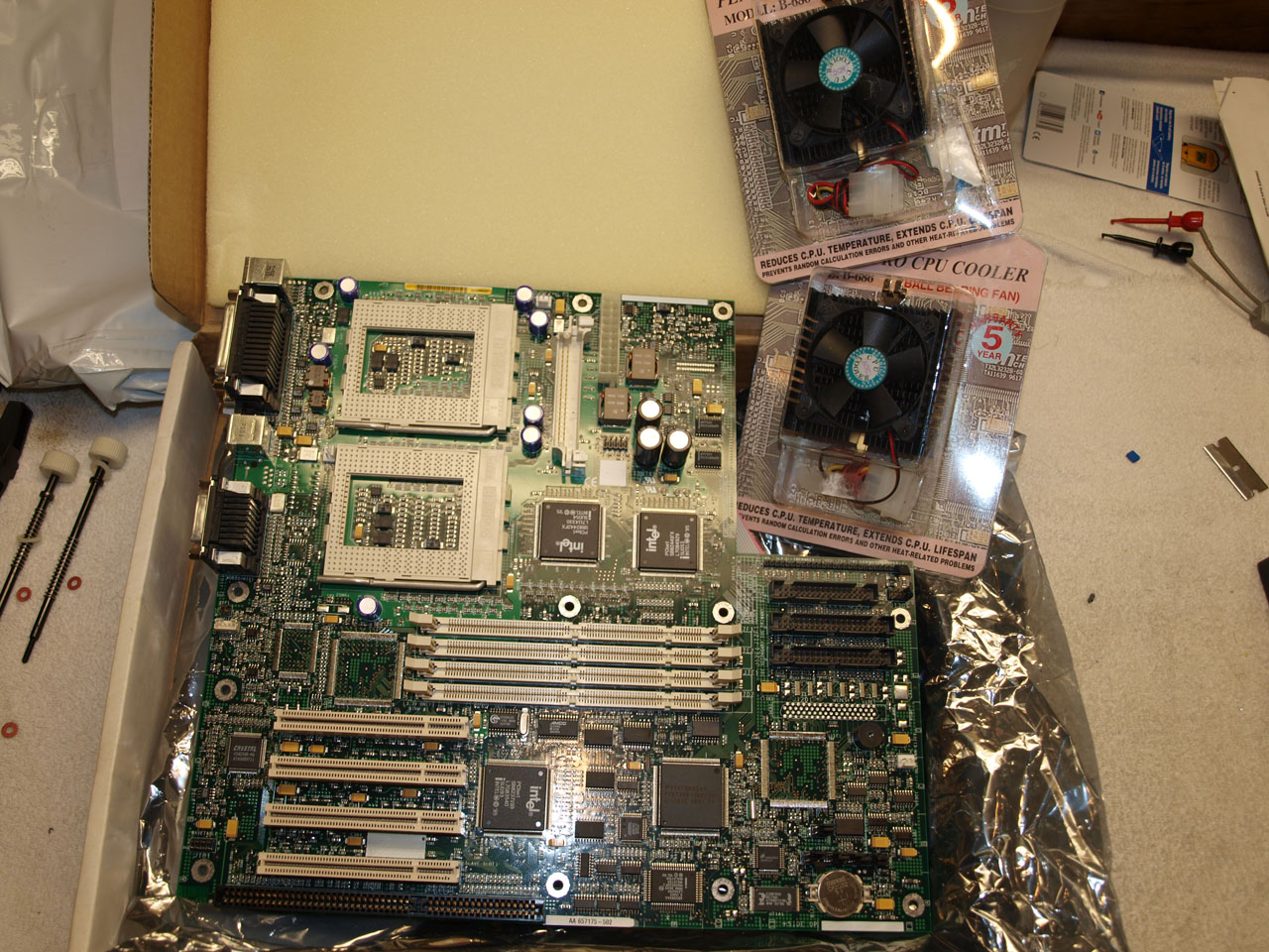

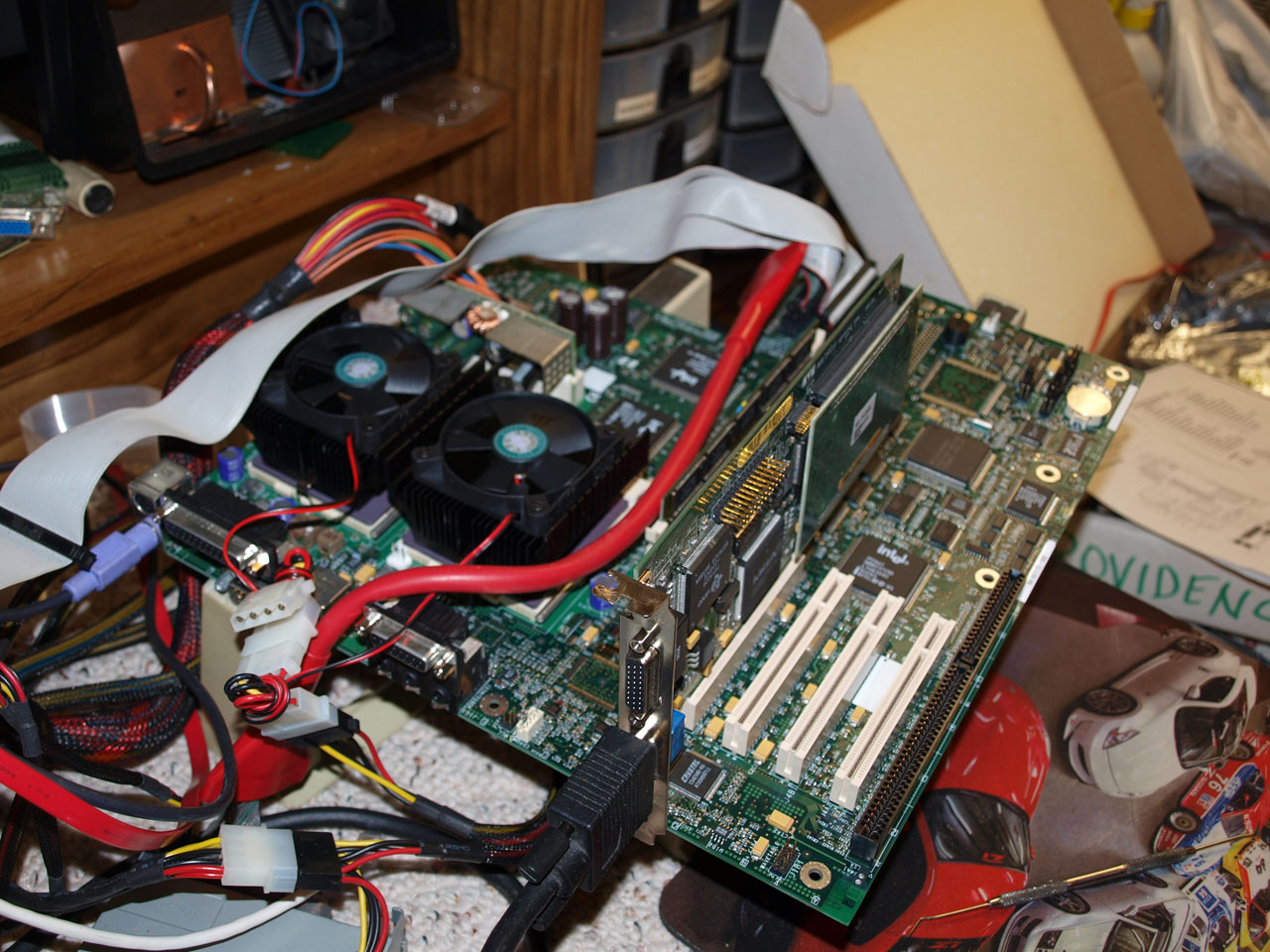

    Build 2's P-Pro board was found cheap on ebay when scouting out CPU's. This one is a MSI MS-6107, dual socket8. I haven't received it yet....but it was shown working. The Dallas realtime clock is said to be bad, typical of old hardware of this era.
    This will serve as an ongoing build thread, as these are low priority builds.....but Houston, we have liftoff!!

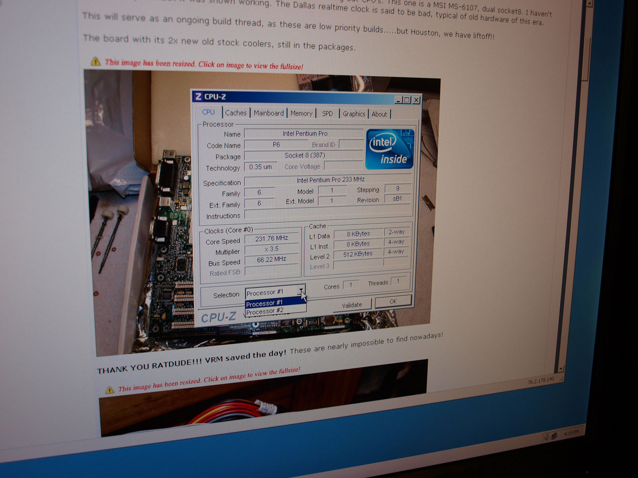

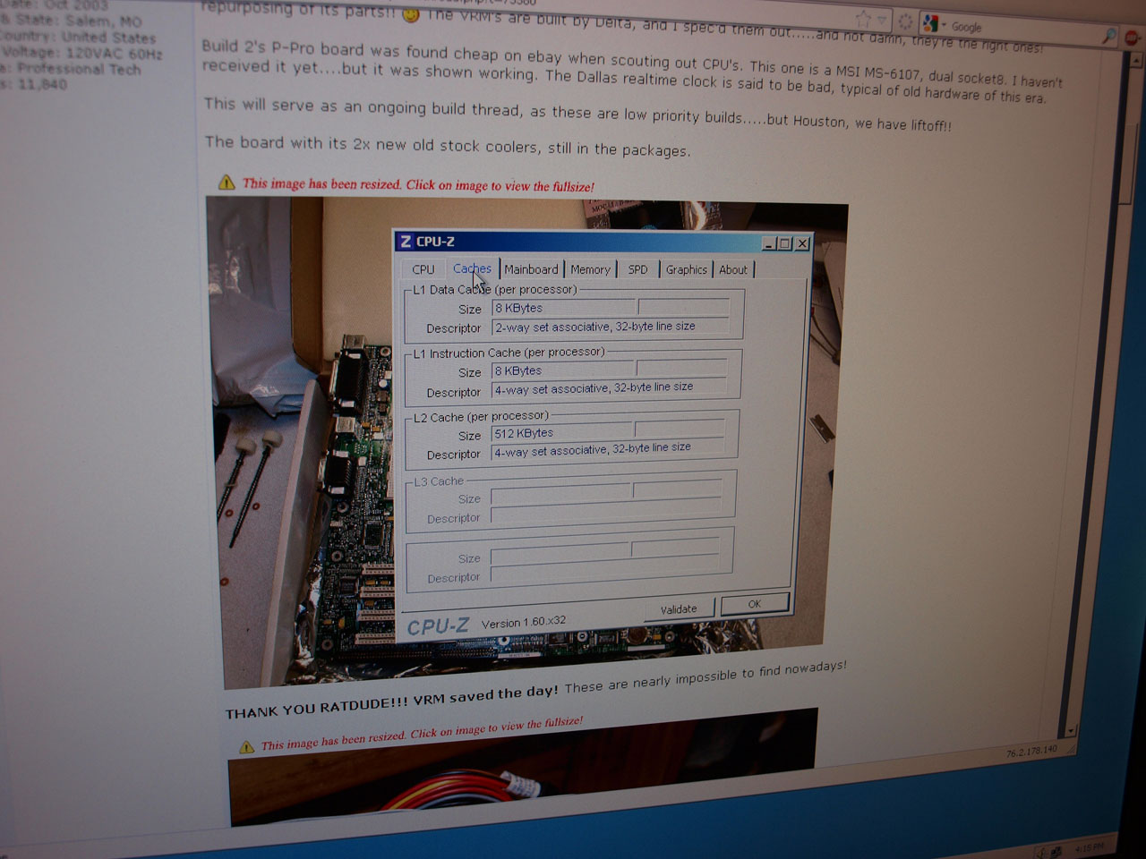

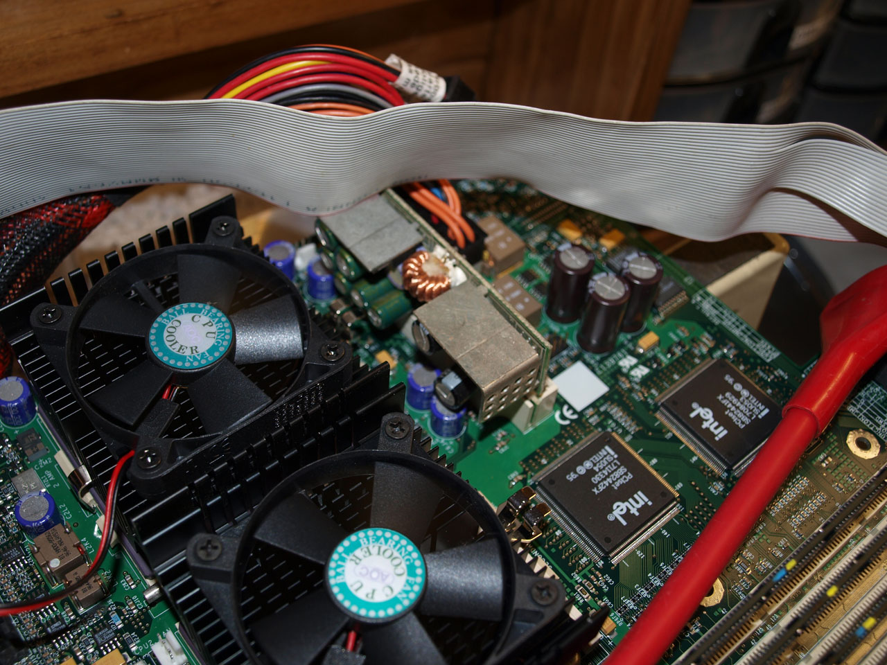

    The board with its 2x new old stock coolers, still in the packages.
    THANK YOU RATDUDE!!! VRM saved the day! These are nearly impossible to find nowadays!

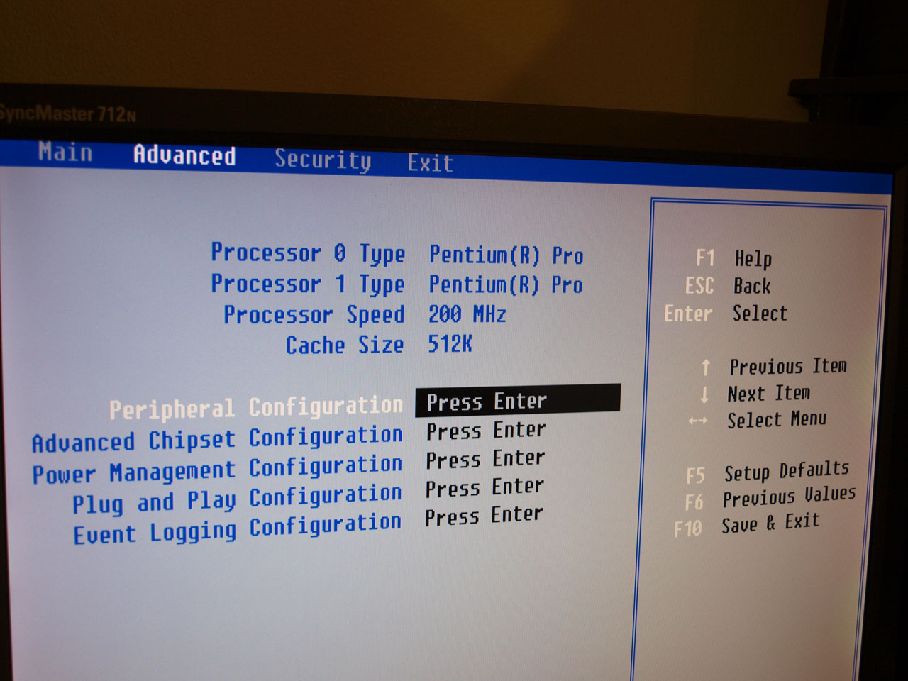

    YAY, it post's! 200MHz? hmmm....we'll see about that....back to this in a minute....
    GPU is a Matrox Millennium that I bought new back in 1996 or so... 2mb with the 6mb upgrade, or maybe 4mb with 4mb upgrade....I'm not real sure, but its 8mb total.

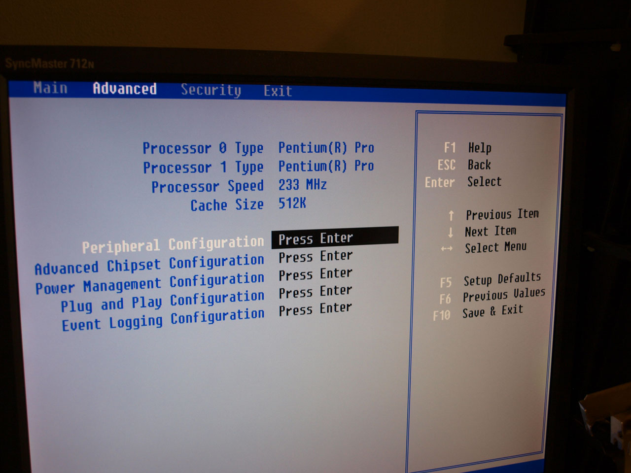

    Now we're cookin', mega overclock @ 233!!
    Updated the BIOS, Intel still had it on their site. Tested everything, no problems!
    That's as far as I got with this today....
        You are very welcome.

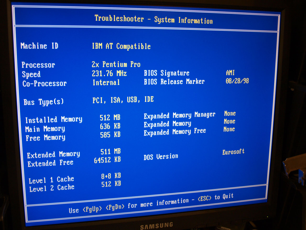

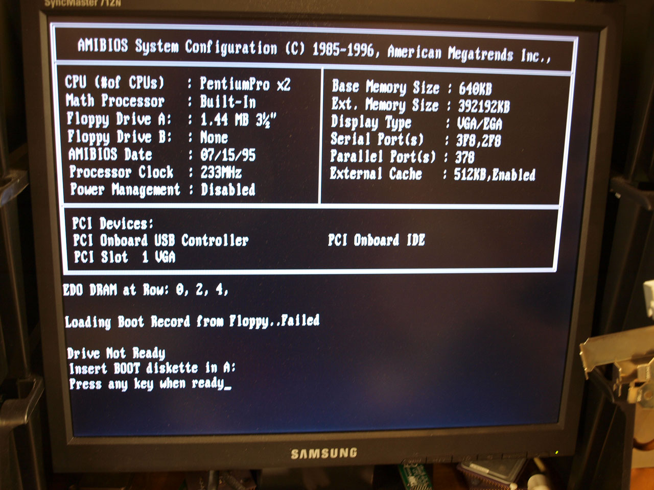

                            So the second board arrived today, MSI MS-6107....yup, Dallas RTC dead as can be, which means it won't hold settings....only boot option is floppy, which it boots from just fine.....but I couldn't get it to boot from cdrom to run diagnostics, but I don't really forsee issues. To my surprise, it has a matching pair of 200MHz 512k L2 CPU's in it, I was expecting 256k chips, those were the most common.
                            It also had BIOS v1.0 on it, which is known to be problematic (research I did pre-buy) for installing OS's and other graphics card compatibility issues. MSI removed all traces of this board from their site ages ago it seems. I searched and found MS-6107 BIOS v1.1 in some obscure place, so I downloaded it and tested it on a spare chip first to make sure it was legit, and it was..... I have attached it to this thread, so in the unlikely event anyone ever needs it in the future, it won't be so hard to find...and its been verified good/legit.
                            Anyway:
                            The board!
                            Flicked a couple DIP switches, on the first try, instant 233MHz!
                            ...BIOS v1.1
                            https://www.badcaps.net/forum/attach...1&d=1545086544
                            ...and for such an obscure board, I did track down the manual....
                            https://www.badcaps.net/forum/attach...1&d=1545110441

                              Gotta love classic AMIBIOS.
                              Does yours do the "tick, tick, tick, buuzzzzz" RAM count?
                              IIRC, the 386 and 486 AMIBIOSes did. There was a 3rd party utility, AMISETUP, that could toggle CMOS options if your particular CMOS setup program didn't expose them.
                              With something like that, one could go in and manually set the "audible RAM test."
                              Late AT/ATX crossover boards with AMIBIOS did not have the audible count.
                              Don't sweat the graphics issue; PCI vs AGP kills performance more than the difference between any period cards.
