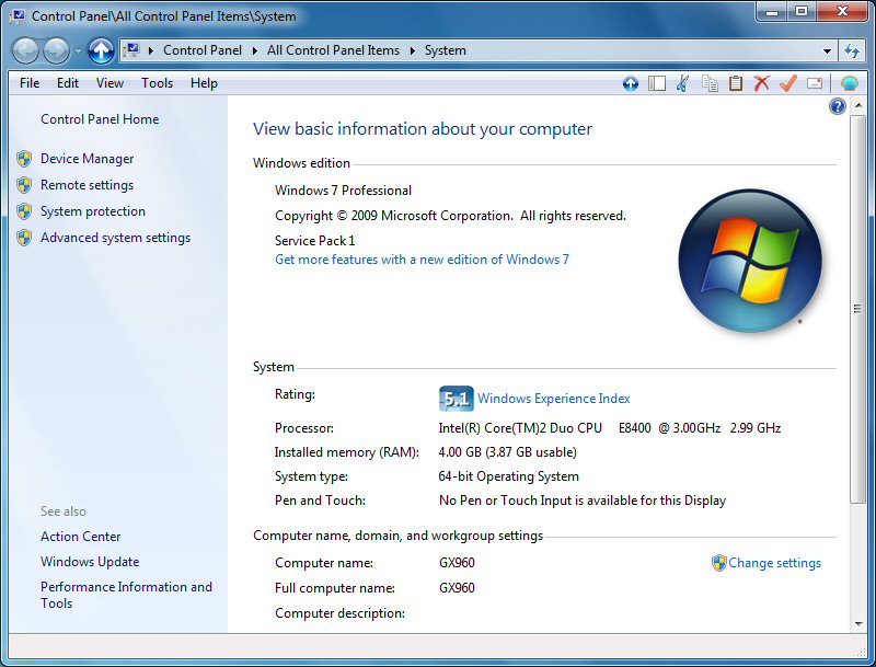

    I've seen a few Dell's do this....but here's the issue. This is a Optiplex 960. Note the RAM amount in the image below:
    I ASSumed this 'usable' amount was taking into consideration memory grabbed by the onboard GPU....ok, no biggie. Here's where it gets goofy... I've put a PCIe GPU in this system, which presumably disables the onboard (no longer shows in device manager)...why has the memory not been released; IE the full 4GB usable? I have an Optiplex 980 doing the same thing except with 8gb; 7.87gb usable....very different platforms. BIOS's are latest/current.

    Re: Dell 960 Memory Allocation
    Disclaimer: I know nothing of how PC's work -- but a shitload about processors, in general!
    [Presumably, you are running a 64b OS? Otherwise, you k now the total memory space will be limited to 4G... which must include the GPU memory]
    If the CPU (chip) in the device can only address 4GB of PHYSICAL memory (i.e., if there are only 32 address lines leaving the processor), AND if the GPUs memory ends up directly mapped into the CPUs physical address space, then it consumes a portion of the ADDRESS space even if there exists other physical memory available (it "overlays" that memory).
    You can test this by removing the GPU and installing some generic video adapter (with less memory) and manually disabling the onboard to see what it reports as usable in that configuration.
    In the second machine, it could be that it has the capacity to address 8GB of physical memory and the GPUs memory is overlaying some portion of that.
    [Again, reread my disclaimer]
      Well, good thing is that you're running 64-bit Win7, so at least that takes the address space limitation out of the picture.
      It looks like about 128MB is being reserved for some reason. Usually it depends on the BIOS and firmware memory mapping, sometimes SMM eats up RAM, sometimes BIOS shadow eats the RAM. As RAM amounts go up, that 128MB won't get "missed" with the RAM used up by the OS with stuff like pagetables,... so much for fleecing us.
      Would be nice to get E820 data from the machine to know the exact memory map...
          Some boards have different memory remap options in the BIOS, I guess for the limited BIOS in a Dell that is not an option though.
          Here is a very lengthy MS article I found, it goes into quite some details about what can cause it.
          My bet would still be that the built in graphics steals it, since it is such a nice round number missing.
          Their specific mention of a Intel 975X is interesting though, I guess a Google search for your chipset might reveal something?
              https://support.microsoft.com/en-us/...on-windows-7-b
              ...as per my original post & thought....I just figured the BIOS would let it go when the onboard GPU disables. Strange but not the end of the world.
                    Yes, but my point was more that crap BIOS often have these limitations.
                    The memory does need to be remapped.
                    And older chipsets like that often have a 36-bit address bus in the memory controller.
                    That means a max of 8GB memory, but that includes stuff like the PCI address space, and memory on a dedicated GPU.
                    It all has to fit into the same address space...
                    Newer chipsets do not have these limitations.
                    And no, in your case it is of course not the 36-bit limitation.
                    But still, try it with 8GB and see what happens, it might reveal something.
                              it might actually be a sucky bios that still allocates 128M for video
                              or check your cmos to init on PCI-E and not IGP. Or see if it still is using the IGP in combination with the GPU for some reason
                                  I tried clearing the CMOS on the 960 & 980...no avail....still sucks up that 128mb needlessly. On a 380, when adding a PCIe GPU, the 128mb RAM is released by the BIOS, full amount (4 or 8gb) is available to the OS.
                                    plug a separate monitor in the IGP while it's on. If it outputs to the monitor, then the IGP is still enabled. might not be able to fully turn it off. Maybe there is a multi-monitor option that needs to be disabled, and the option to disable it might not be there
