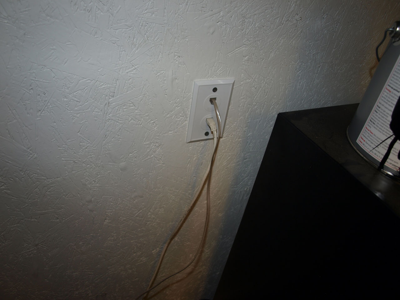

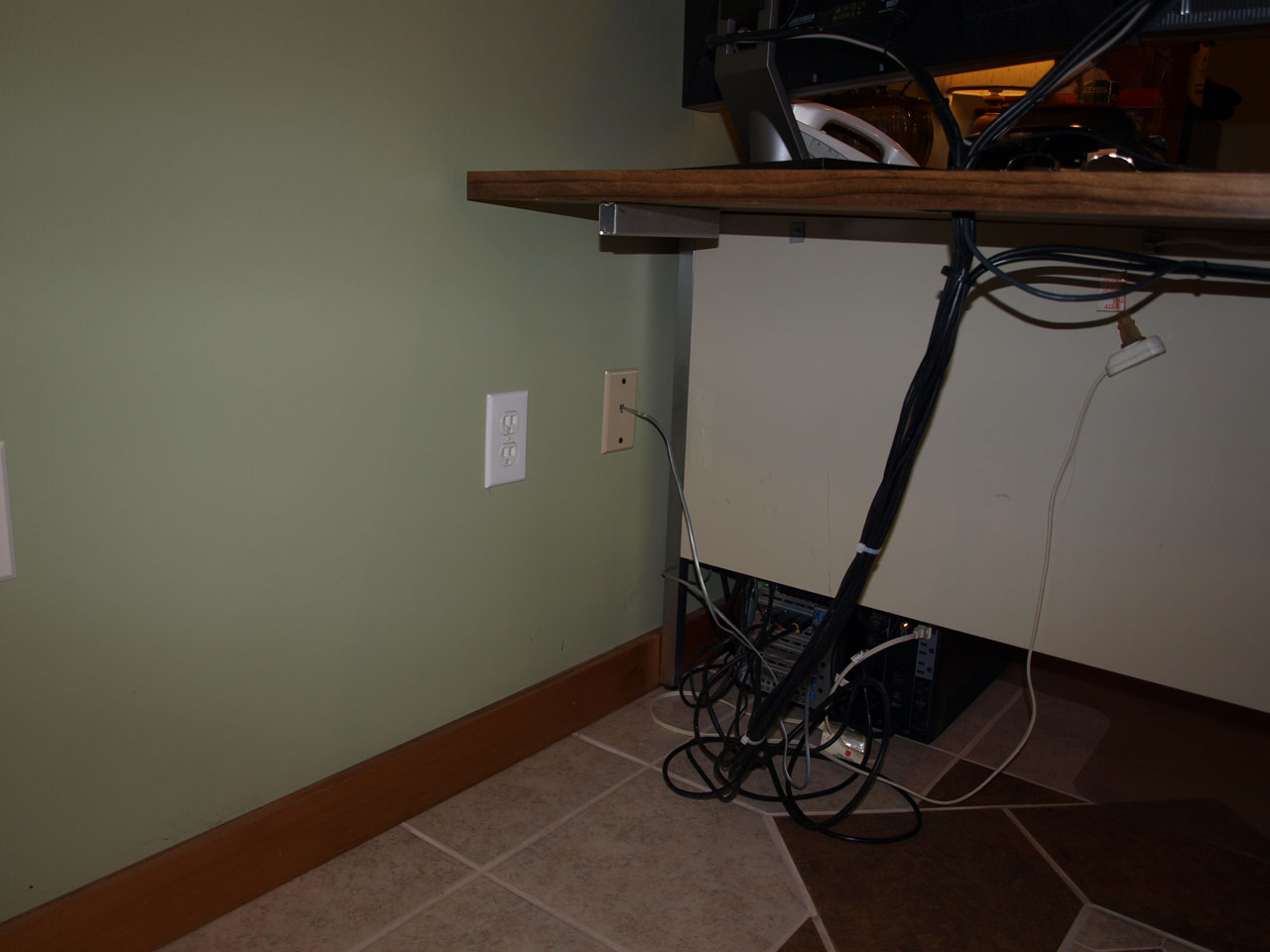

          What a crappy, cold, rainy & drab fall day.....so I wasted it snaking the shittiest cable of all through the wall from my office to the wire closet.....
          The crappy part over, and phone working.
          Those awesome 3 monitors, just to make someone get all excited....
          Wall jack.....install clean or don't install at all.
          Now for the workroom. This jack originally was 2x RJ45 connectors with cat5e to each. I 'borrowed' one of the cat5e lines and pulled the RJ45 jack and replaced it with an RJ11 (the wall plate works with either)....and of course pulled the other end in the wiring closet from the LAN switch and patched it into the telco switchboard.
          I wired this back in 2010 when I finished out this room. At some point, I may run an additional/dedicated telco wire, but for now this was the easy way. There's already 4 LAN connections in this room, plus the wifi.....one of the LAN drops could be spared.
          ...and done with this for today!
          So far so good!

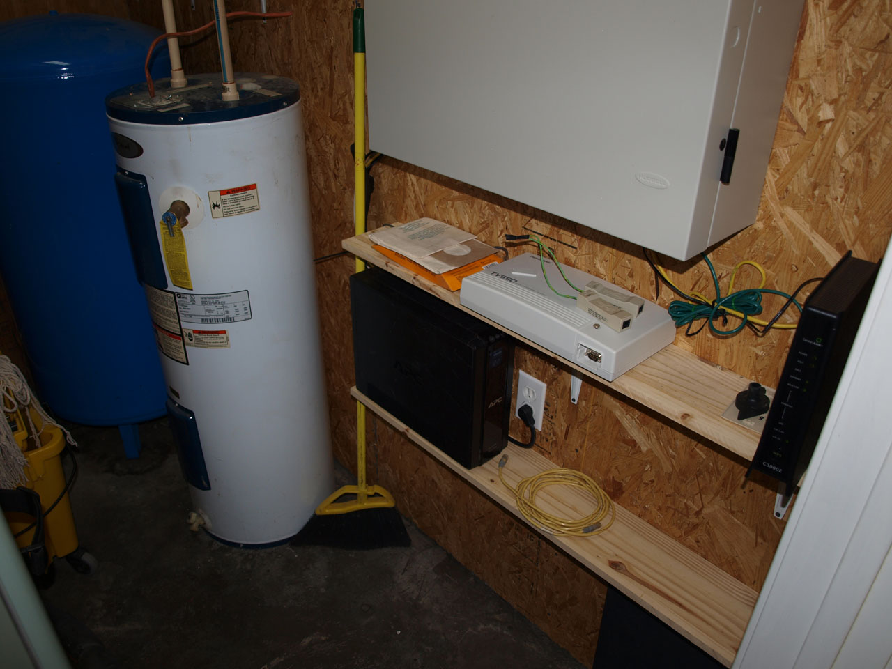

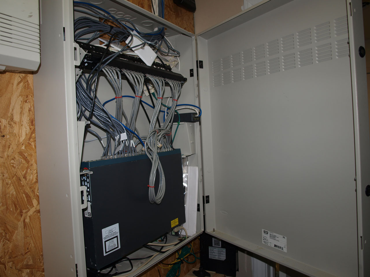

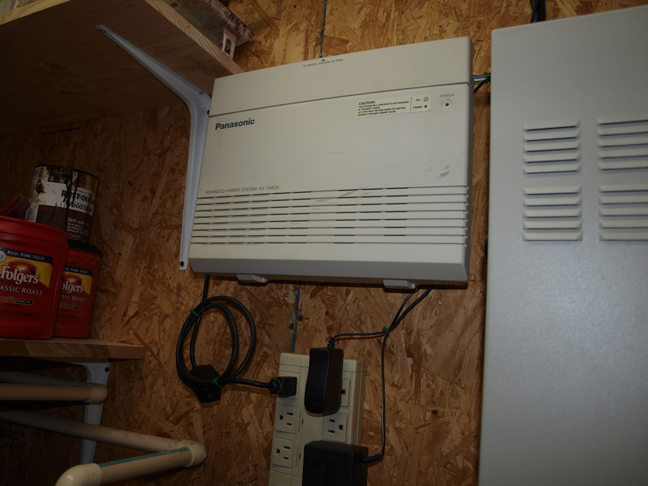

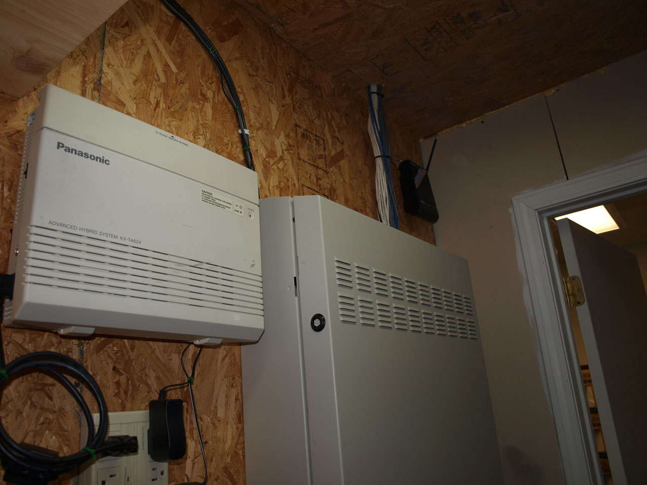

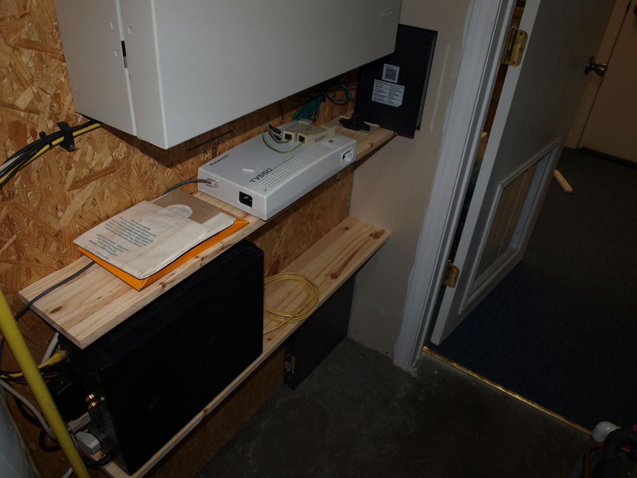

              Just a FWIW, this has been in operation since the creation of the thread.....but I did finally get motivated to clean up the rats nest of wires and tidy everything up.
              Shelves.... That TVS-50 voice system is basically a voicemail system....that I never could seem to get programmed right....so I said fruck it, I'll use the one built into the cellular line.
              ...but atleast the UPS isn't sitting on top of a junk PC case because the wires weren't long enough!
              Brains for the cordless extension.
              PBX all tidied up.
              Even inside this building, that box always has 3 of 4 bars. Never had an issue with it.
              I didn't show the before pics....out of embarrassment.... Not so bad now.
              It was never all that bad inside the cabinet....it's just packed a little tighter with telephone connections in it now.
              ...and that's that!
