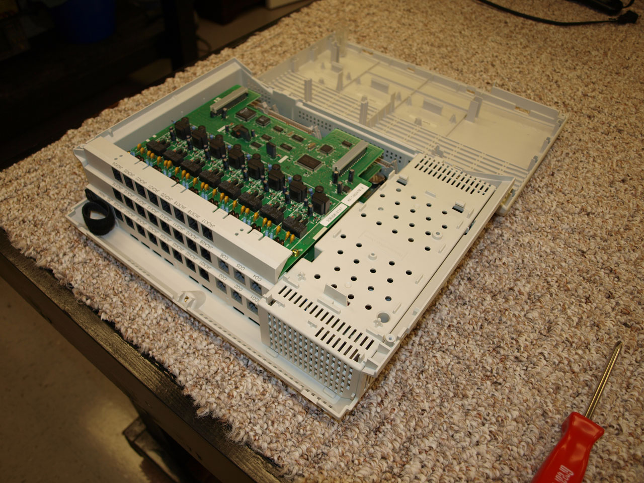

    About 10~12 years ago I was given this Panasonic KX-TA624 analog telephone system with its 'master phone' and box full of extension telephones. It's been up in the attic all this time, untouched/unused since I didn't have a land line. It has all the line expansion cards, making it able to handle up to 6 outside lines and 24 internal extensions. I was told this system was removed from a shopping center that upgraded to a VOIP system.
    Why am I wasting my time on this you wonder? Well, I need a phone number for a little venture I'm working on....and I sure as hell don't want my personal cell phone number out there..... Now here's where it gets good!!! The cheapest I could get a land line is ~$70-$80 a month.....that's fracking ludicrous! Another cell phone would be more than that once I factored in the monthly costs plus the cost of another phone....and I refuse to be one of those bozos that think they're so important that they need to carry multiple cell phones.... Ok, so here's what the solution was.....a straight talk wireless 'Home Phone' box, which is compatible with any corded/cordless 'landline' telephone...hmmm, worth a little gamble to see if it'll work with this system. The box itself cost me $30. The service is $15/mo, unlimited talk & long distance....DONE DEAL!
    ....so here we go!! The phone network switchboard/controller:
    Box full of phones and random wires...

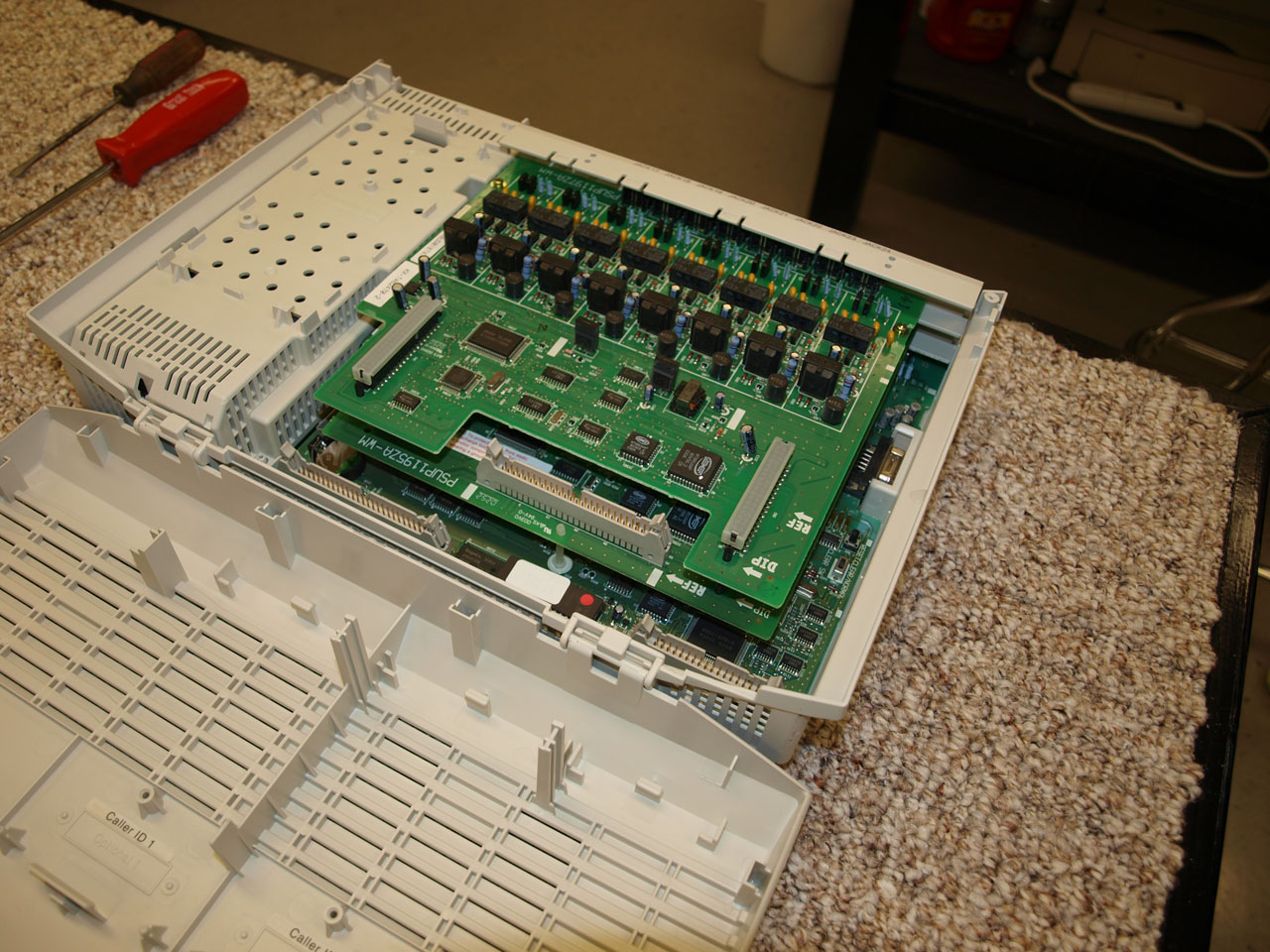

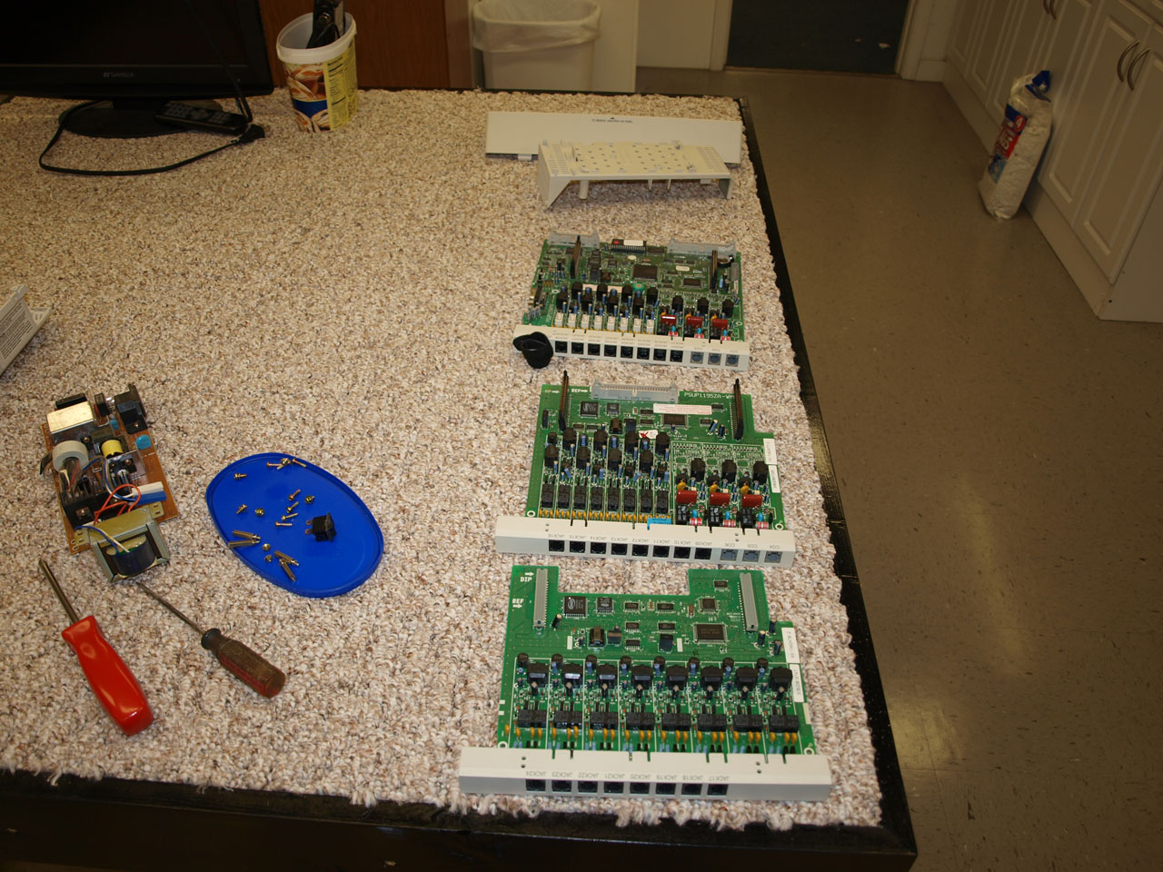

    This thing was dusty & dirty....I completely disassembled it, washed the plastic housing in the sink and blew the dust off the boards with my air compressor hose.
    All Apart....I checked the caps in the PSU.... A panasonic unit with all Panasonic caps! What could go wrong!!
    The boards:
    A hard-mounted 'memory' battery.....hmmm... It was a miracle, 10 years in the attic with season after season of extreme heat and extreme cold, this battery wasn't dead! It was holding 2.7v.
    Just to avoid headaches later, I simply harvested a socket from a junk motherboard and installed a fresh battery....a Panasonic no less!
    All cleaned and going back together.

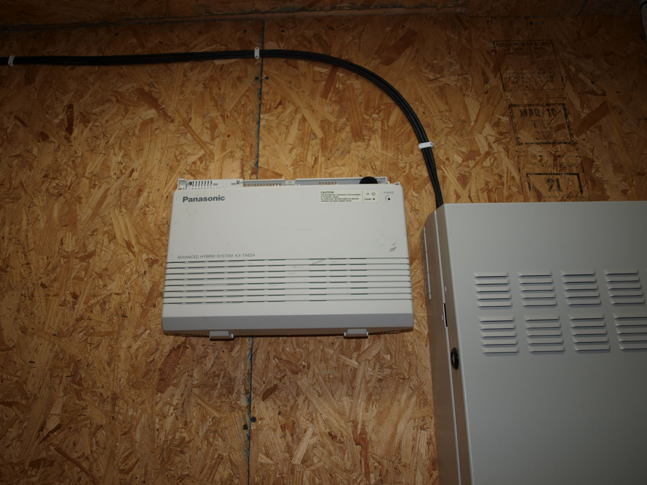

    Now the beginning of the install....in the secret room deep in the bowels of the building....
    Control box on the wall...
    The 'straight talk' box next to it.
    Mockup is up & running!
    That was all the easy part.....the real fun lies ahead, wiring the building for all this!! ...so yea, this will be an ongoing project!
