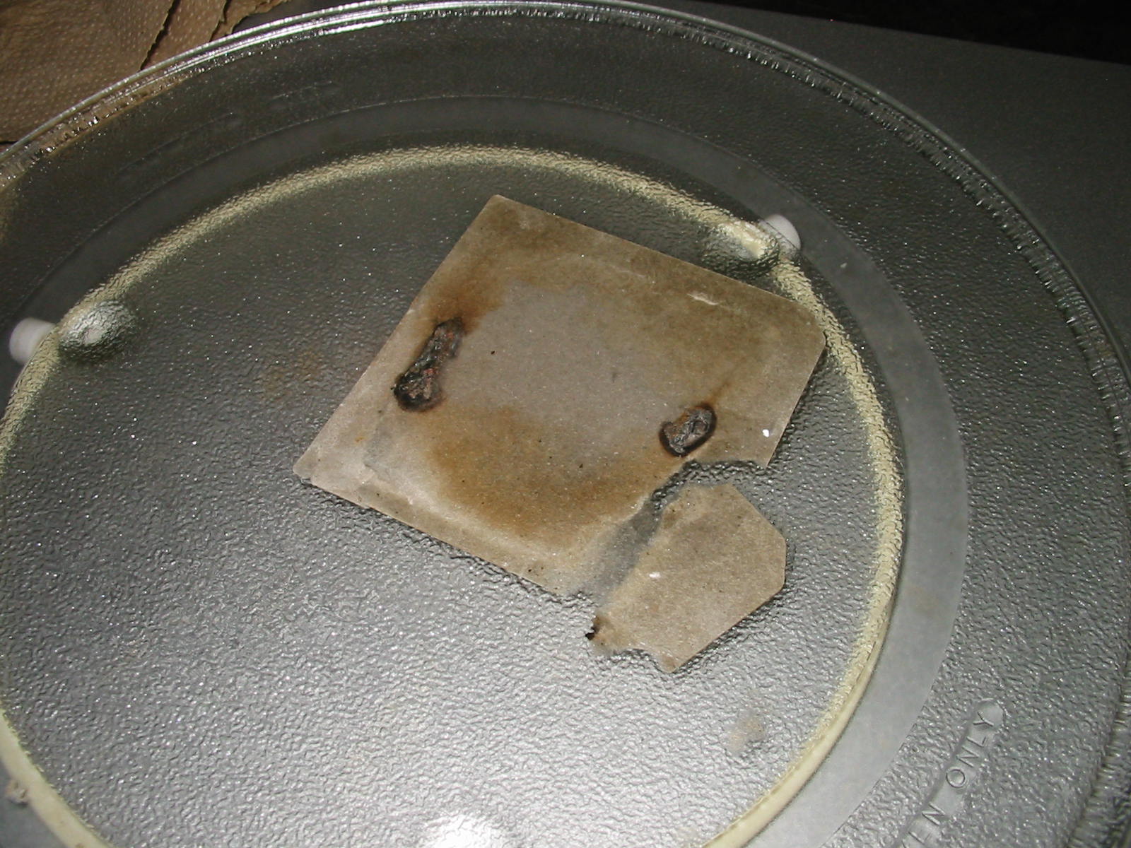

              I haven't tried testing it yet. Am I correct in assuming that I shouldn't run it like this? On the inside, there was a cover of some sort on the side that has started to burn. Looks like it has aluminum foil or something similar in it. Anyone know what that is and what it's used for? Magnetron cover, perhaps?
              https://www.badcaps.net/forum/attach...1&d=1342333028

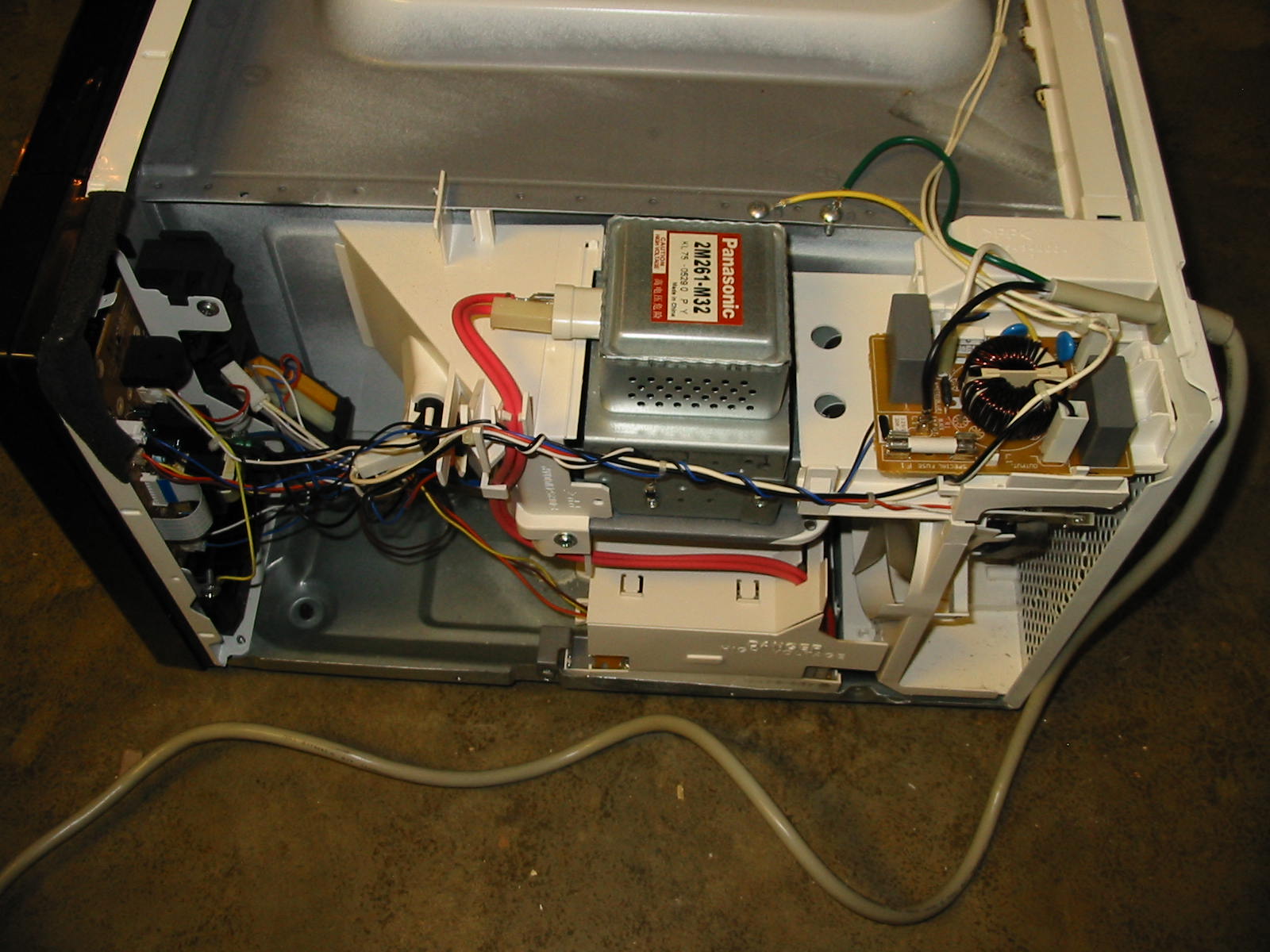

              Other than that and the rust, the electronics looks fine. Nothing obviously burned. Pics:
              So can I do something about it? Everything looks very nice on the front but IIRC those rust spots will make the magnetron short, correct? Can I cover everything in aluminum foil or something like that? Or is there a special paint that needs to go on top of the metal inside the microwave?
              What do you all think? Make a new thread and fix it or just trash it?
              I'm thinking save the electronics at the very least, maybe even the door and frond panel as well (a lot of reviews mention broken latch mechanisms on the door so maybe someone else can use those parts).

                Theres only one way to find out if it works, turn 'er on! But, seeing the magnetron wave guard as it is, I think it will start making some plasma
                  Yeah, I think it has already been doing that to the previous owner. Hopefully nothing else has been damaged by that. From what I gather online, the microwave can be used without that cover so that's good news. I'll try to clean it this week and test it. I don't think my family will be happy when they come back and see this microwave - they really hate it when I bring "junk" in the house. But hey, at least it doesn't have roaches!

                    Try smoothing off (with very fine sandpaper) the arced metal areas, plasma balls usually form on sharp edges. Its not guaranteed to last though.
                    Shame it has an inverter instead of low frequency iron core transformer, you can make arcs with them (WARNING: VERY dangerous, they can provide up to 2000v at 2+ amps!).

                        you can sand down the bad spot and repaint with special paint made for microwave cavities.the waveguide cover is sheet mica and also availible and cheap.cut it to fit.

                                The problem is, it looks like the metal has rusted all the way through to the other side. But I'll try cleaning it anyways just to see what comes up. After all, you're the know-it-all guru around here, so if you think it can be fixed, it probably can be . Thanks for the tip on the microwave cavity paint. Saved me a lot of time researching.
